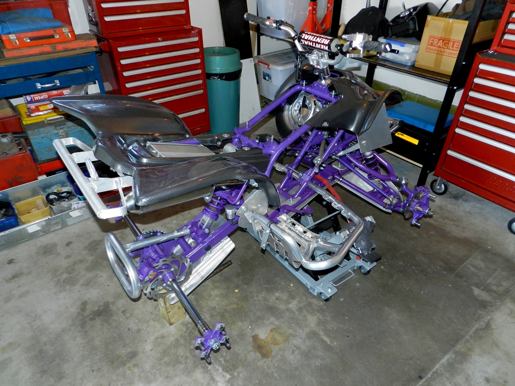

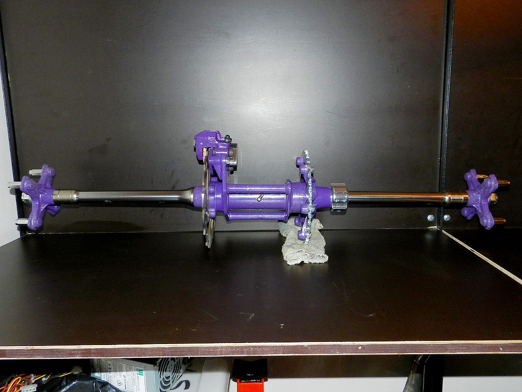

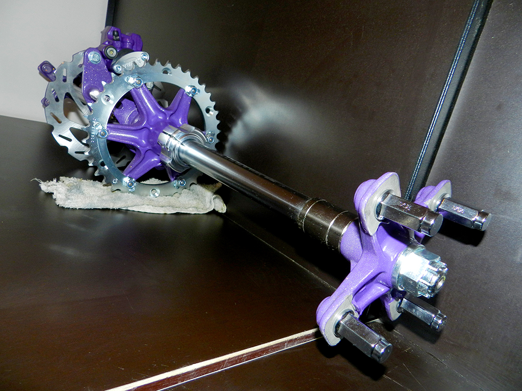

Got the axle together. Just need to torque the hub nuts and install cotter pins. Also do up the axle nut. Have got the axle setup to the widest setting. May change it when I have it as a rolling frame.
Tomorrow night I plan on getting the axle onto the swing arm.
Reactions: 82cutty

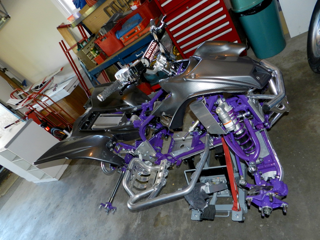

Nice looking good..the front wheels width should be 1 to 2 inches wider then the rear axle for the best handling and stability. I believe im 50 in the front and 48on the back
Reactions: Markblaster

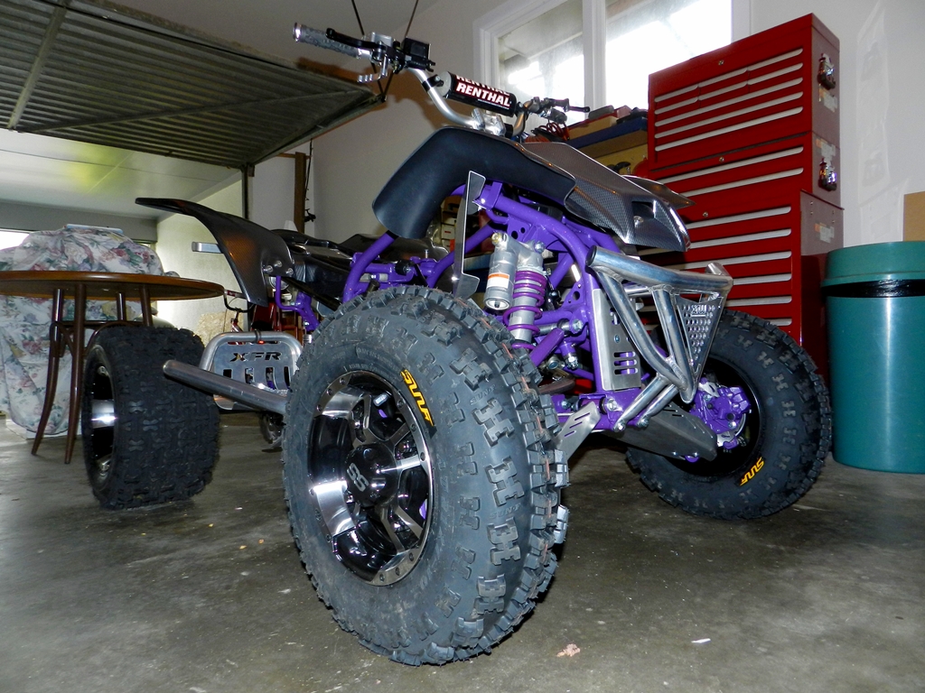

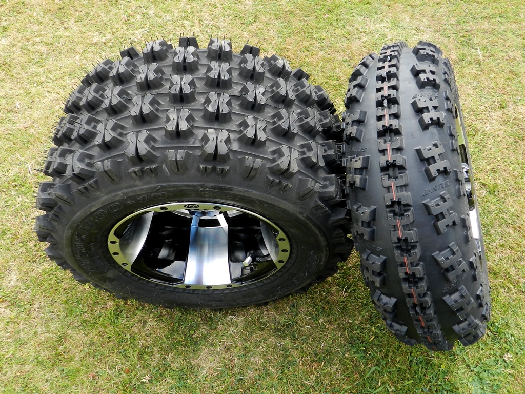

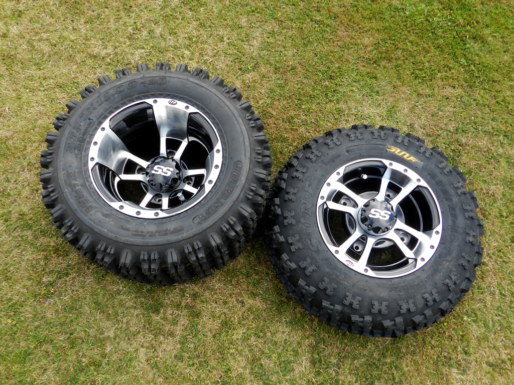

Waiting on my tires to get installed on rims. then I can get it a rolling frame.

Picked up my wheels last night and tonight I got them on the blaster. Tightened up the axle hub nuts and wheel nuts. Still have to do the main center axle axle.Rear rear is not on the widest setting. Could go 2" on each side but didn't want it to wide or wider then the front.

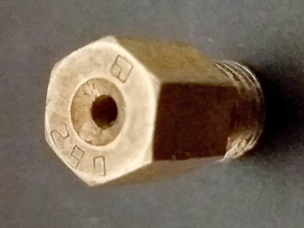

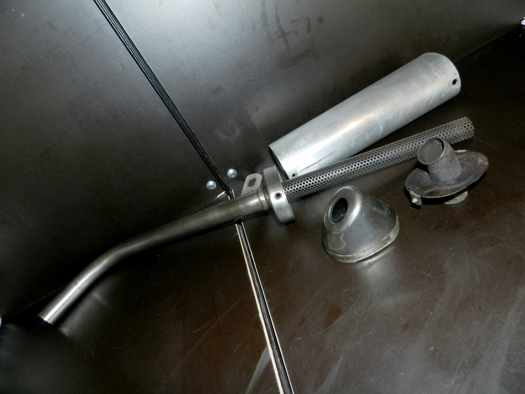

Got main axle nut done up. Front and rear brake lines fitted. Carb stripped and clean ready for rebuild. Needle was on middle slip and had a 290 jet in it. Also stripped the muffler and started cleaning it ready to be repacked.

Jet out of the carb (Will be replace)

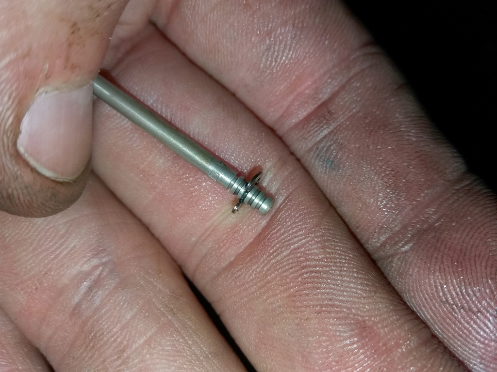

Needle out of the carb.
Muffler stripped and started to clean it.

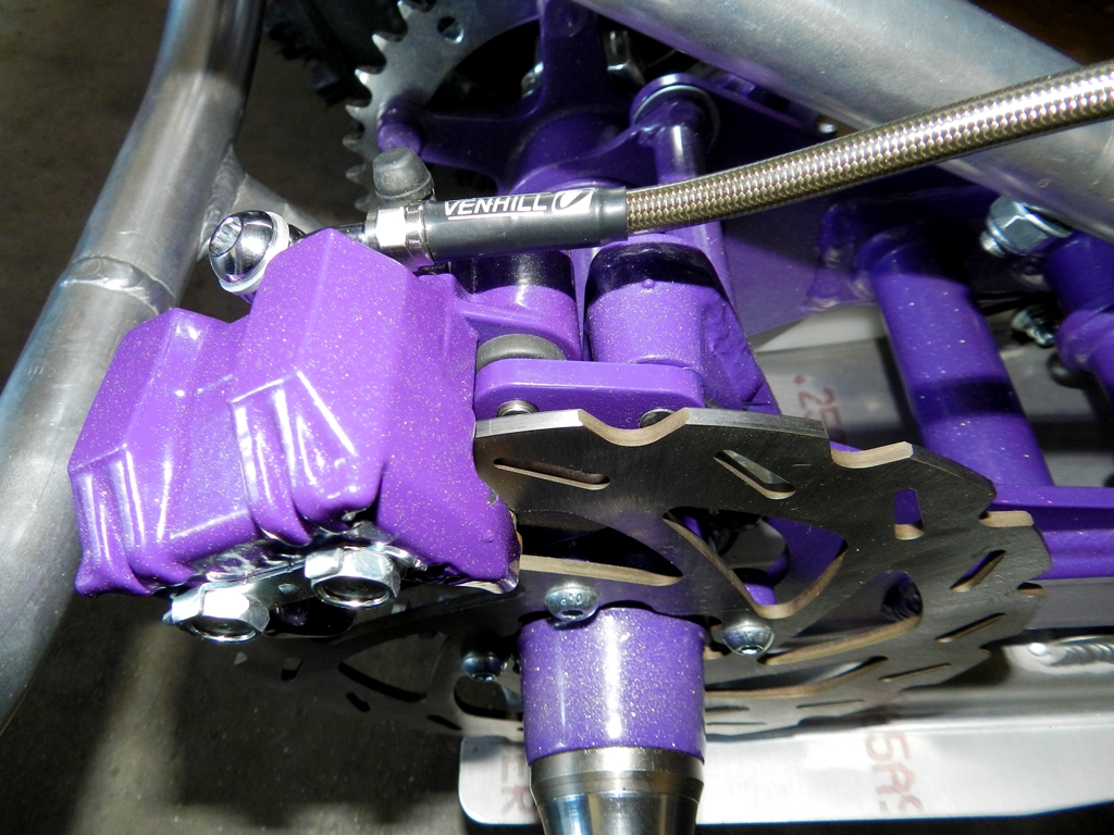

Brake lines installed. Love this brake system. You can change the ends to what ever you want. I ordered straight, 20 degree, 45 degree and 90 degree banjo's.
All the front end is still loose as I have to still do wheel alignment.
One tip DONT buy the allen key style banjo bolts. They are a bloody pain in the ass to do up in tight spots like the front calipers and rear master cylinder.
I love the look of the button head style banjo bolts.
Brake lines that you can change the ends is awesome! Where did you get them?
Yeah I like the look of them too but a bit of a pain to do up. Brake lines are Venhill Powerhose Plus. I got mine off a seller on ebay. Here: http://www.ebay.com/usr/up-the-shop
Website: http://www.venhill.co.uk/Hoses_-_Components_&_Lines/POWERHOSE_PLUS
This is cool as you can pick the parts and it likes a image of what you brake line will look like.
http://www.venhill.co.uk/Line_Builder
