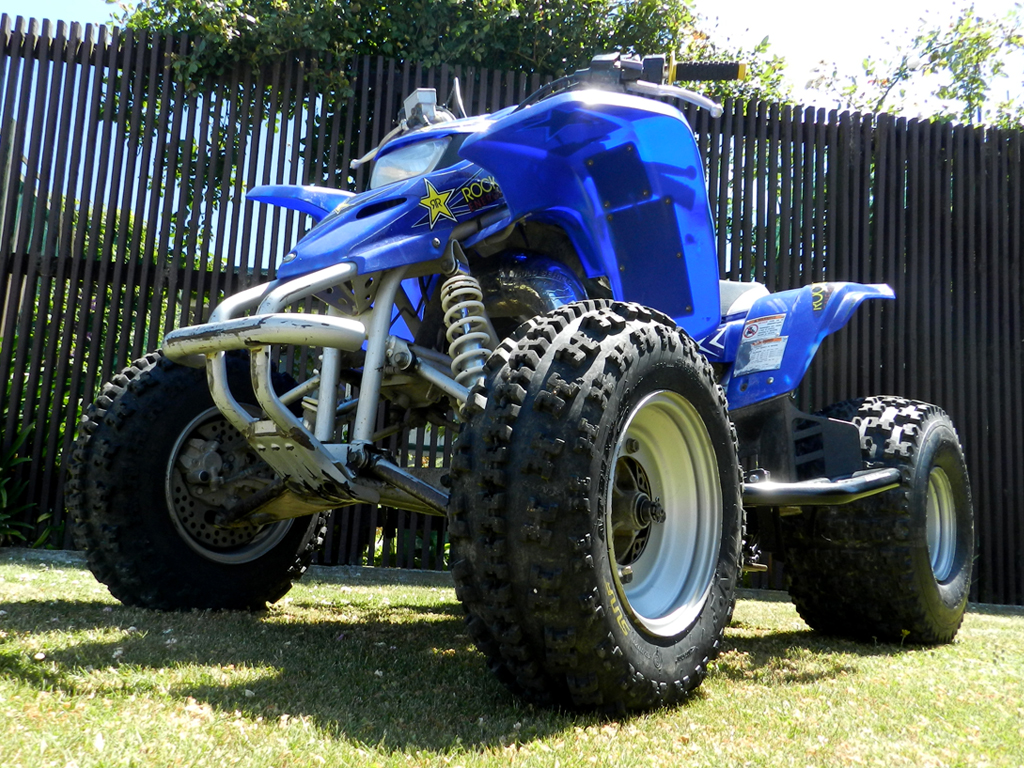

Starting a build thread of my bike now as I will be doing a lot to it next year. Bought the bike so I had a bike to ride over Christmas.

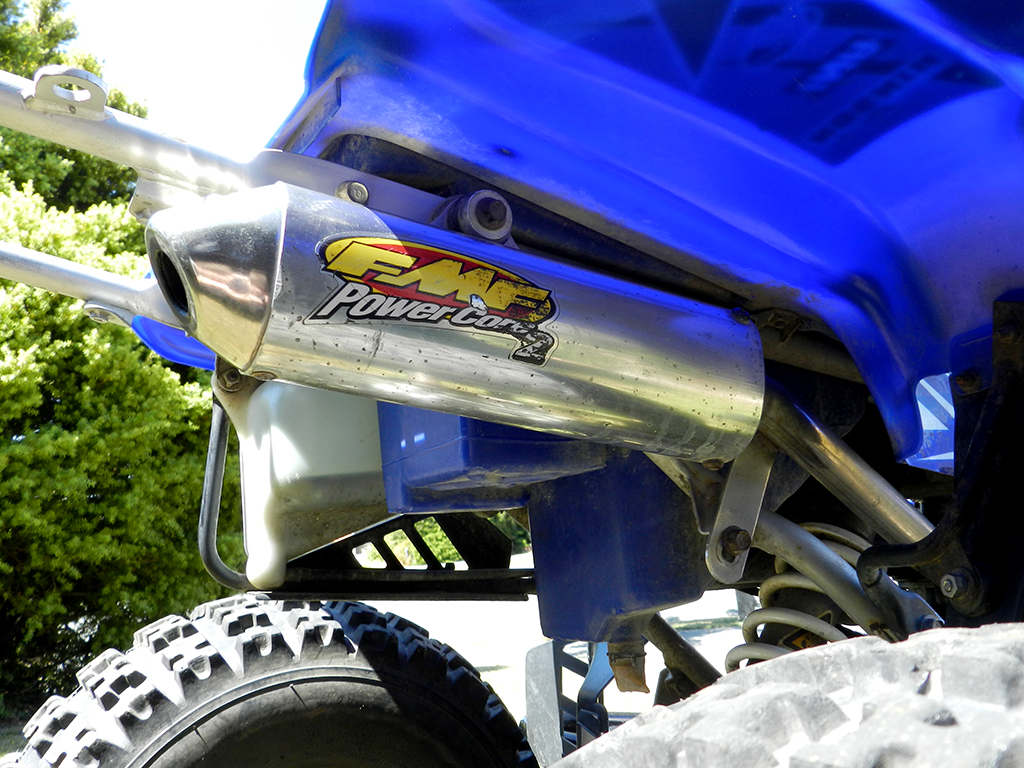

Anyways its a 2005 Yamaha Blaster that I picked up of a trading site. It come with a lot of new parts including: Full set of tires, hand grips, front wheel bearings, service manual, heel guard plastics and had a $1000 spent on the top-end and reed valves couple months ago. Has a Full FMF Powercore 2 exhaust on it.
Some photos of how I got it.

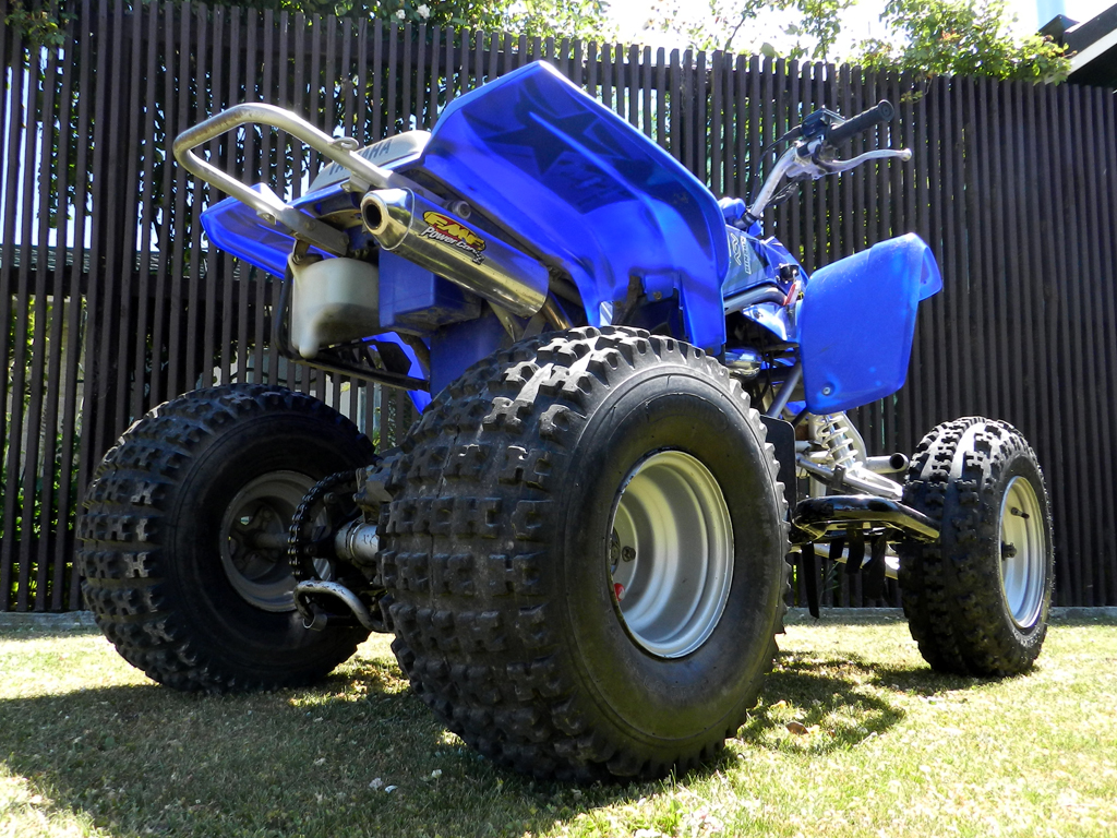

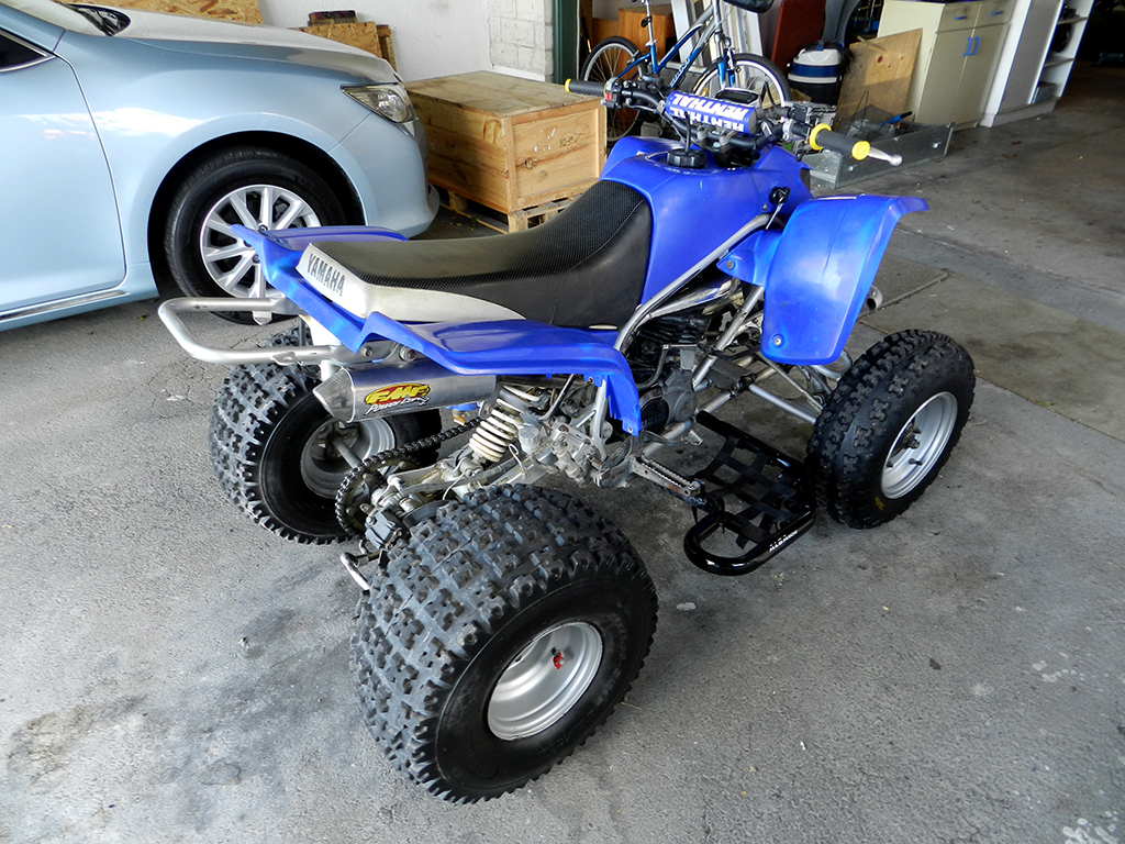

After removing the RockStar graphics and checking over the bike it looks like this. Also installed new handle bars, handle bar pad, hand grips.

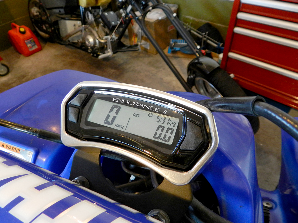

Installed a Trail Tech Endurance II Motorcycle Speedometer.
After topping up brake fluid drained old fuel/oil mix out of tank and installing new chain rollers gave the bike another little ride. Normally only takes 1 kick to start but fuel had to get into the system from tank.
Did find a couple of dodgy things on this bike when I checked it over.
1. Front wheels had 10mm thick spacers behind them making the wheel nuts only just thread on the ends of the studs. removed them and now back to normal
2. Rear wheels had 4mm thick washers behind them making the wheel nuts only just thread on the ends of the studs. removed them and now back to normal
3. Yellow wire going to the rear of the bike for the brake light had worn thought on one of the metal clips on the frame and was arcing. Un-Clipped wires from frame and electrical taped them up. Don't have a brake light installed.
4. Micro switch in the thumb throttle was missing the screw that holds it in place. Installed new screw.
5. 40:1 fuel oil mix in the fuel tank but still has the rear oil tank connected with oil in it. Going to be checking to see if oil pump is still working this weekend and if it is I will replace the fuel oil mix with normal fuel.
Will do another update later tonight. :)

To install the Trail tech on my blaster I have designed up a mount for in the front wheel. Magnet bolt replaces one of the stock bolts on the brake disc and the bracket mounts to the 2 mounting holes the disc guard was bolted to. Bracket will be CNC machined out of aluminum.
Cad drawing. Software is TurboCAD Pro.
3D of the bracket.
Will post more photos of the bracket and of it installed. If anyone is interested I can give you the file.

Went for 1st ride today. Had lots of fine and the bike went hard. 1st time on a quad in about 2 years. Average speed is low because are beaches are speed limited to 30kph. lame rule. also you have to do 10kph when passing people that are walking or on horses. But I broke that rule and went for a couple of top speed runs and some sideways action.
Did find out a couple of things when I got home.
1. The key can be on or off and the bike can be started and running.
2. front brakes are sticking.

Didn't the trail tech come with a bracket for the speedo sensor mount? I ended up drilling a hole through the brake shroud and mounting it that way. I like your CNC'd bracket alot more though!

Yeah I had the trail Tech from another bike so don't have the bracket.

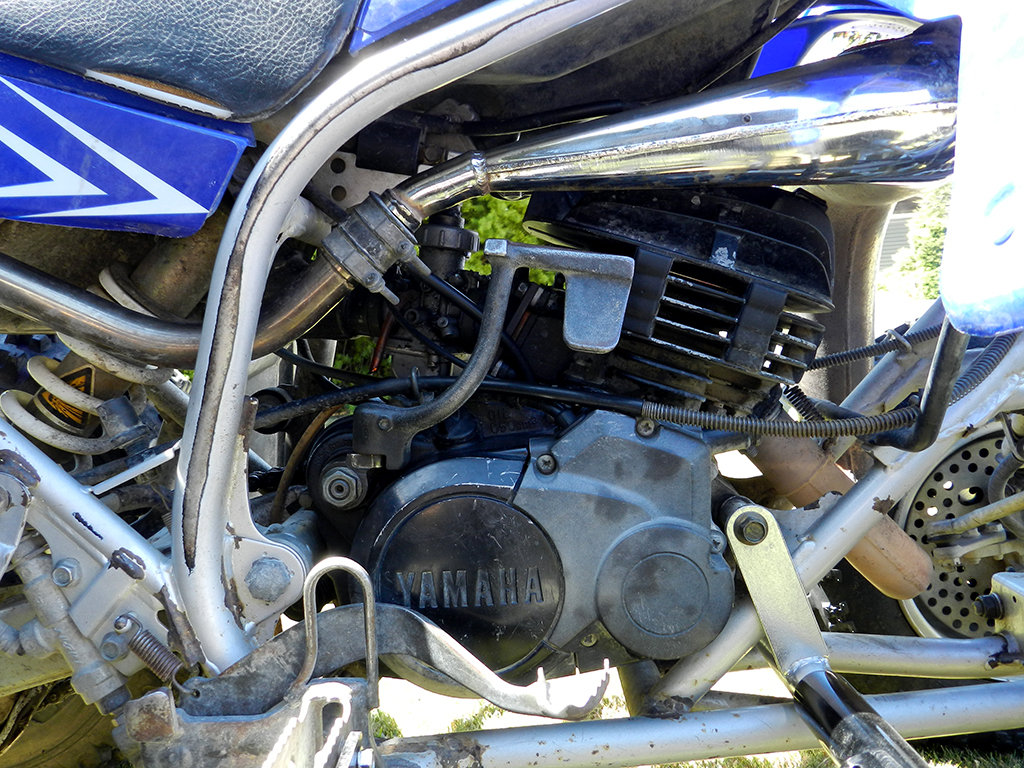

Replaced the front wheel bearings and seals and started to look at the front brake problem. Removed the retaining bolts and cleaned them and rubbed a little grease on them and there was no grooves worn in them. Pads are ok also.
Any other tips on working out why the front brakes are ribbing / sticking. Thinking next thing to o will be to bleed the system.

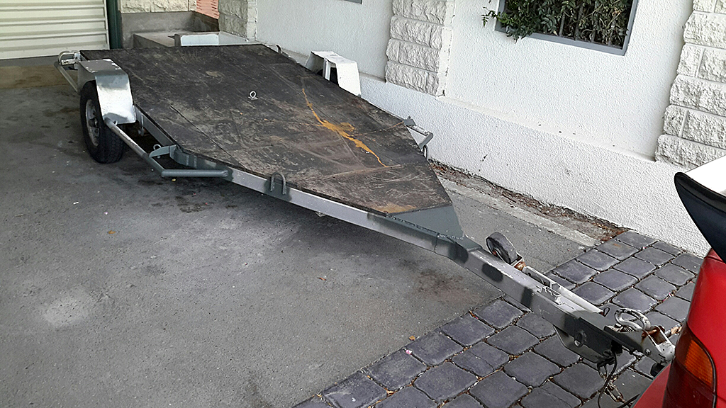

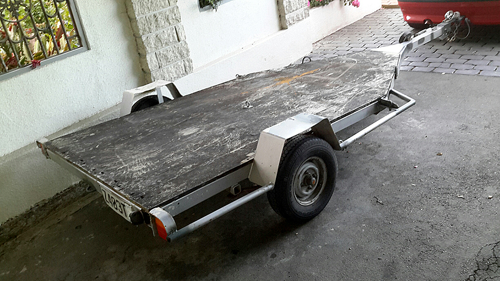

Brought a flat deck trailer yesterday. Payed $411 NZD that's $278 USD. Has 3 new tires, New Led lights and wires plus plug. I removed the motocross front wheel holder off the trailer so I have a nice flat deck for my blaster. Want to put a bin on the front so I can throw ropes and tie downs and that in.
Going to water blast the wood on it to clean it up a bit and paint the frame.
