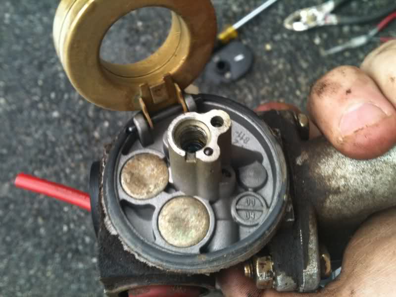

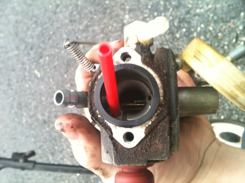

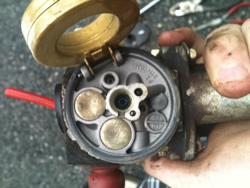

ok so lets work on he older mower first. it was doing the same thing as the other one, but i took the bowl off, and made the float so that it will allow a little more gas in, and now what its doing is i hit the primer 20 times or so, it will start in 2 pulls, then go thumo thump thump, and stall. so i turned the idle screw in all the way, did the same ting, and it started rite up. ran for about 20 seconds, then died out. tires it again, except this time before it died out, i hit the throttle a little, and kept it reving, then what it did was go all the way up to full throttle, and rev really really high, so i shut it off. i tried to turn the idle screw out, and no start no matter what. i would have to reach over and push the throttle for it to run, then it would go to full and i would shut it off.
heres the pics of this carb.
any ideas? im so freaking tired and frusterated with these lawn mower carbs. im almost rdy to hand them back to their owners and say keep them dont pay me. its really pissing me off. and rite now, i need them fixed asap, cause i will litterly have NO time this week for anything.
The tang on that float looks like it has a pitting where the needle rubs.
The pitting will really make a difference to how the float behaves.
Do I remember you saying that you have cleaned the carb a few times, it still looks very dirty to me, especially on the outside.
You should be removing the complete carb and cleaning off all the gunk, and then soaking it in carb cleaner to allow the solvents to get up inside the passages.
that carb i cleaned like 1 time. i fixed both tho. 1 i know for shure, the other i have to try tomorow when the gas dries up from sitting in the carb. the old one, i had the throttle linkage on backwards, and inside the jet, there was a microspic size hole that i nver saw any of the times i took it appart. so i found it, cleaned it out, and the thing started up in one pull. so that one is done! yay! now the other one (newer toro one). i took the carb appart for like the 30th time, this is the one thats the most clean, i reset the float, got that set up perfectly, and i cleanes out the other holes in the carb. i couldent do that good of a job before, cause i couldent bend the wire the rite way, so i spent a good 30mins on the holes, and unlike the older mower,this one dident have the microspotic hole. i put everything back together, put mu hand over the carb to prime it, pulled it once, and gas came pouring out. it started in 1 pull and ran great. i shut it off, pulled it lightly so it fired once, (this is where when i had to pull it 6 times after to get it started again) then gave it one good pull, and it started rite up. ( it would never do that before). i tried it again, and starts rite up. so i put it away for now, im gonna try it tomorrow morning, if it starts in 1-2 pulls, im golden. hopefully it does.

Just see if you can clean up the tang on that float it will allow the needle to mate with it better.:D
