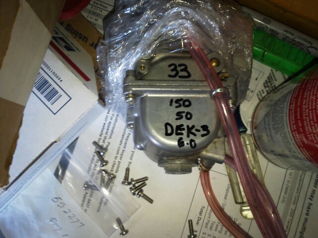

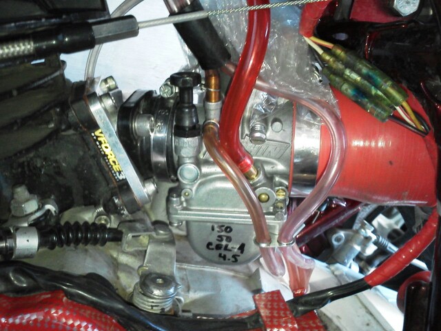

My 33pwk and 35PWK air striker like the same jetting but different needles. This is on my stroked +3, vforce 3, toomey ceramic coated exhaust, aluminum air box uni filter, triple exhaust ported for +3 and head rechambering and shaved. 155psi, no air leaks!
