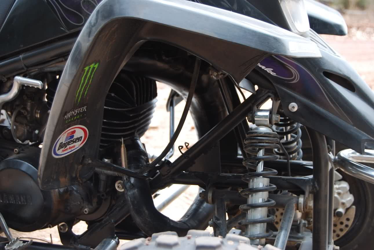

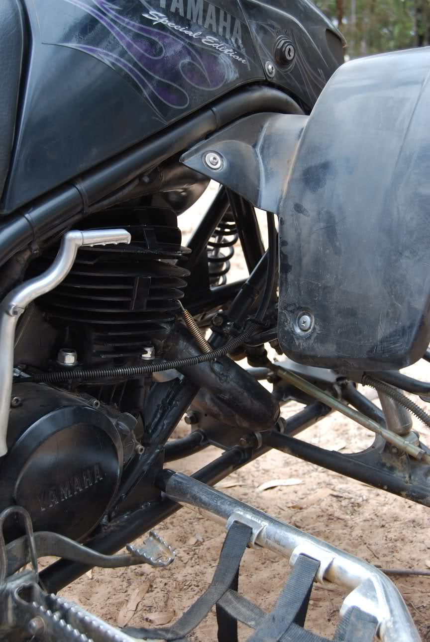

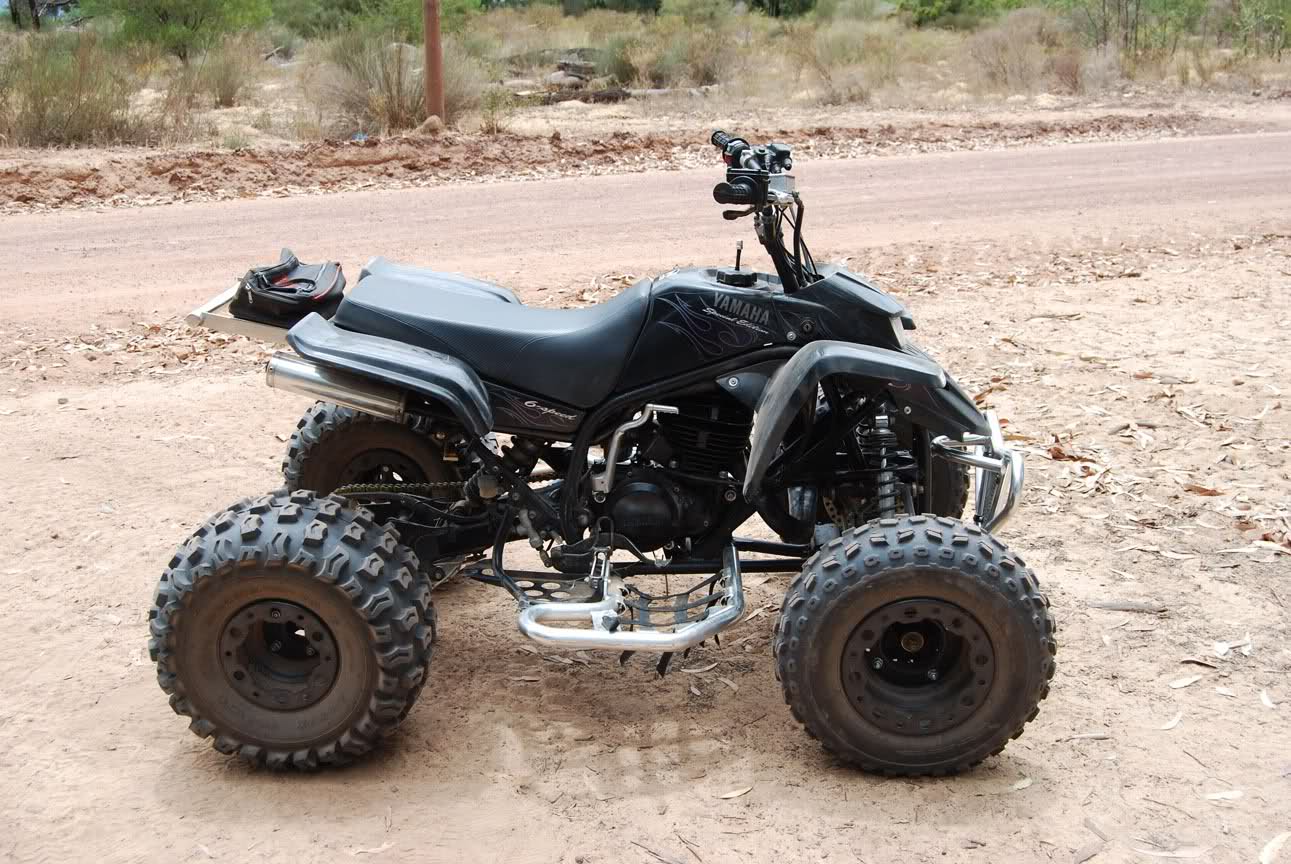

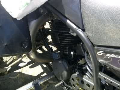

The bike is looking super sick. The IT motor looks like it belongs in the blaster :)

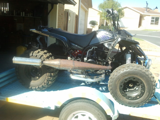

I think building your own new pipe is cool, you might not get it 100% right the first time but you have to start somewhere. I:I
Thanks guys much appreciated!

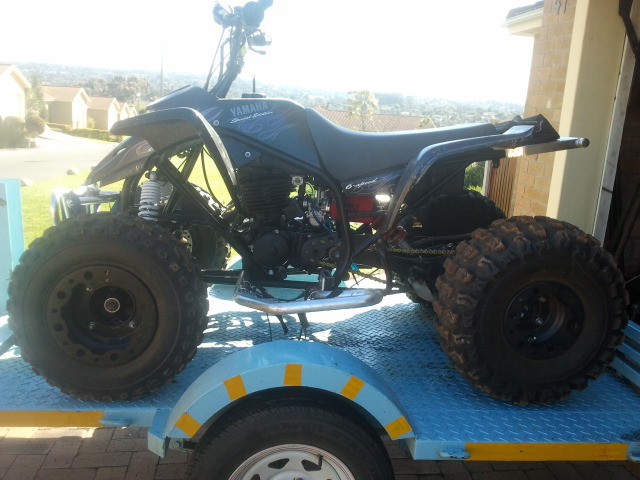

The tyres are Maxxis All Trak 22's, I love them. Still want to get me a set of 22's on the front.
The bike is very strong and starts relatively easily and the vibration is not as bad as I expected. I have been riding her for a week without any problems.
The only problem the quad has at the moment is its not getting enough air with the blaster airbox. I am fitting a cone filter tomorrow until I make a better airbox. The motor runs a 380 main jet standard but could not go WOT with anything bigger than a 200 main jet. She is definitely not getting enough air as she won't even go with the airbox lid on. She still pulls like a horny bull on steroids though and I can't wait to feel her with the cone on. I tried uploading a video through tinypic but it just fails every time. The video is 30MB, must I make it smaller or how do I go about it?

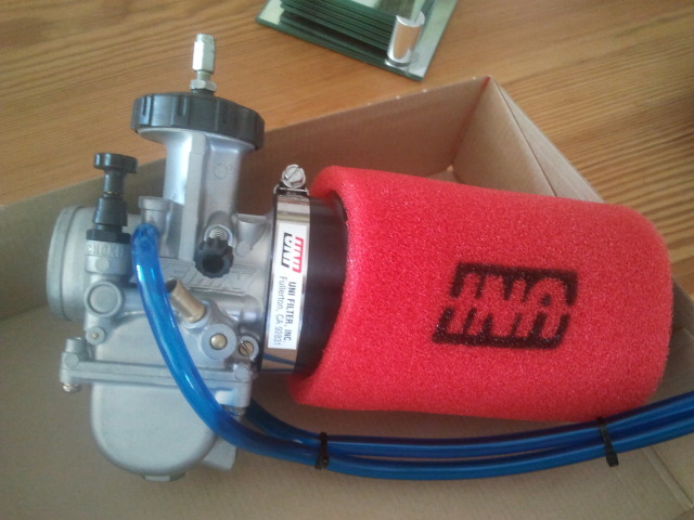

I fitted a Keihin PWK 38mm carb with a uni filter.

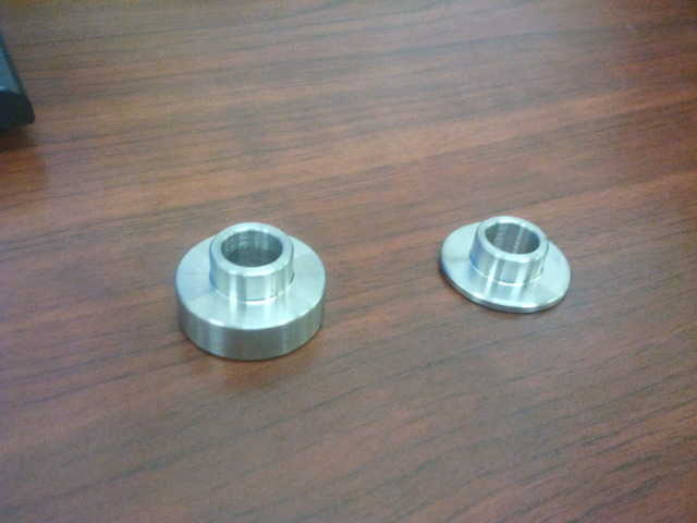

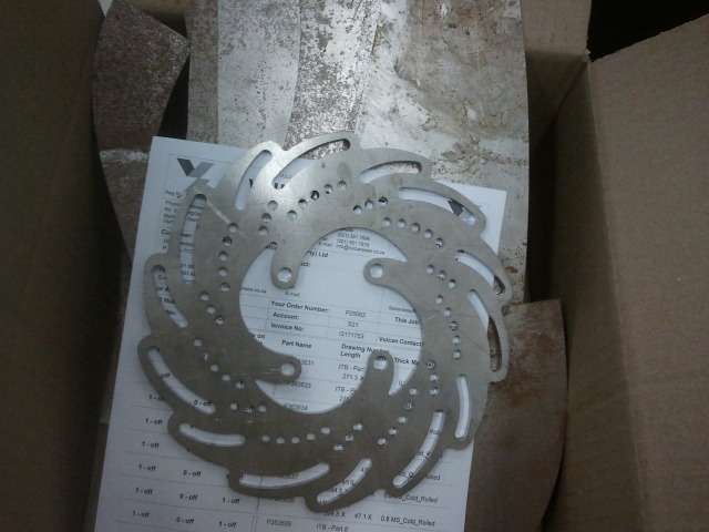

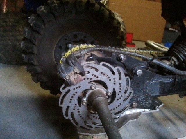

Also cut me a new disc and fitted a TRX450 rear shock with the banshee front shocks.

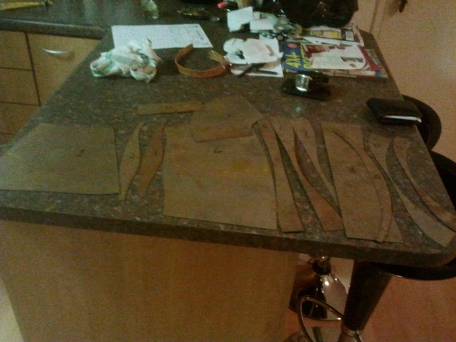

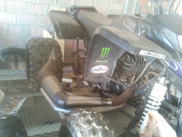

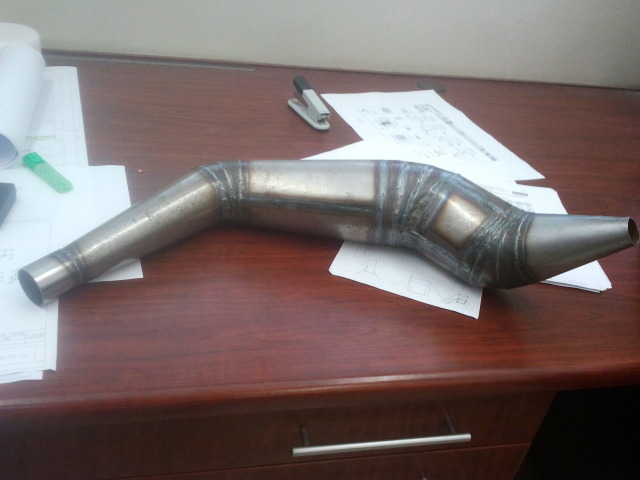

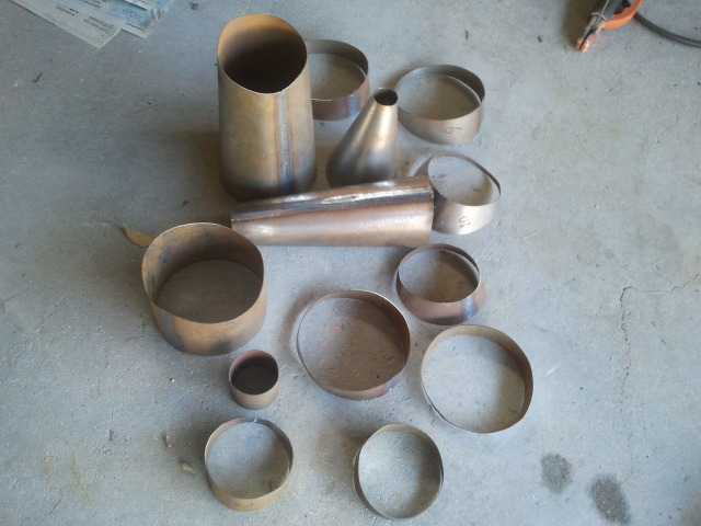

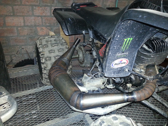

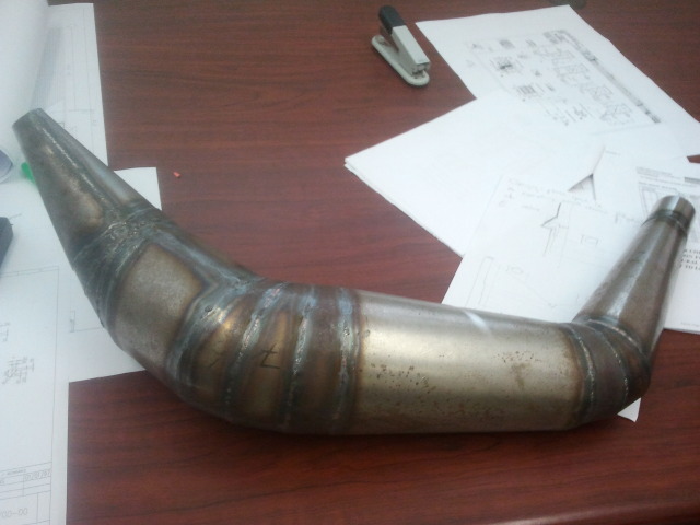

I have been making straight pipes and playing around with them until I found the right combination I liked and I am now making a curved one to fit into the quad.

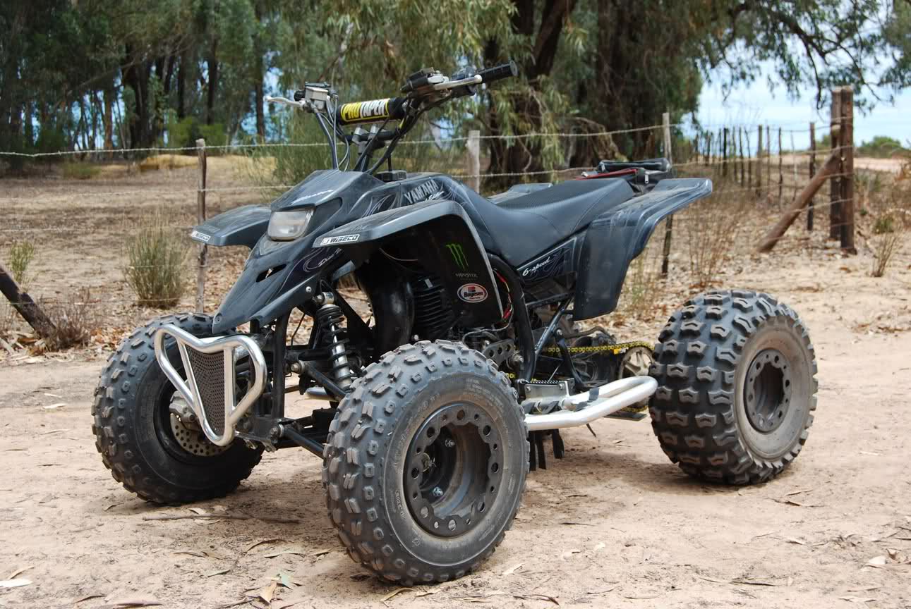

I did a 100km enduro fun run this weekend and the quad is running amazing
good stuff bro, excellent fabrication skills !!!
keep us updated with pics on that pipe build.
now thats some pipe building and welding skillz right thur !!!!!

Ja Paulie pipes must be big!
I worked on the pipe a bit last night and its almost finished.

New carb
Disc that I cut
Shock spacers
The cone developments before I rolled them
