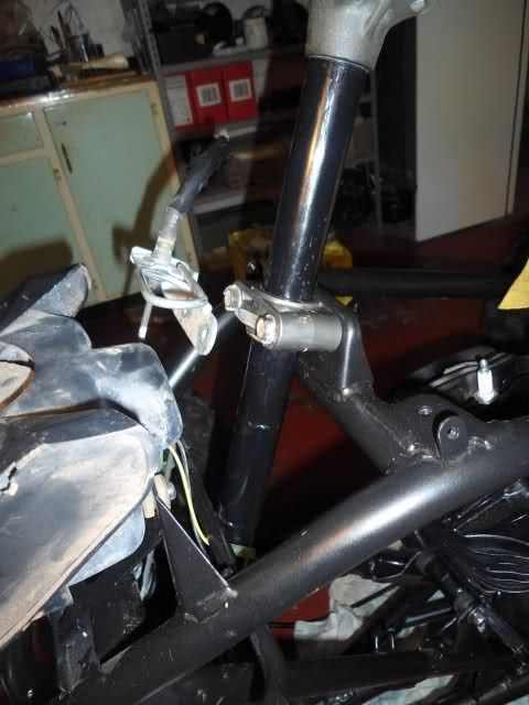

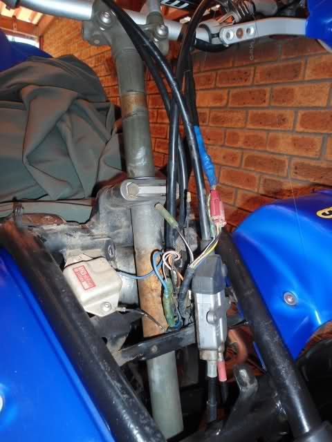

Thanks a ton!! How far does the sleeve slide into the stem? Very clean application !! If a person wanted you "could" grind/sand it down to make it look uber clean. This answers the Q I have in a different section. Now I can save the extra Shee stem in case it gets bent (lol). BTW, love your build !! I:I Some green for ya B)
Its a pleasure Larry, Thanks for the green!
The sleeve slides about 40mm into the stem.
Here is a picture of my girlfriends drum brake model with a 100mm extension. Everything reaches if you do not bolt the part where the cables meat to the frame.
Pic of my 80mm extension.

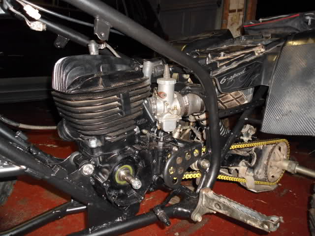

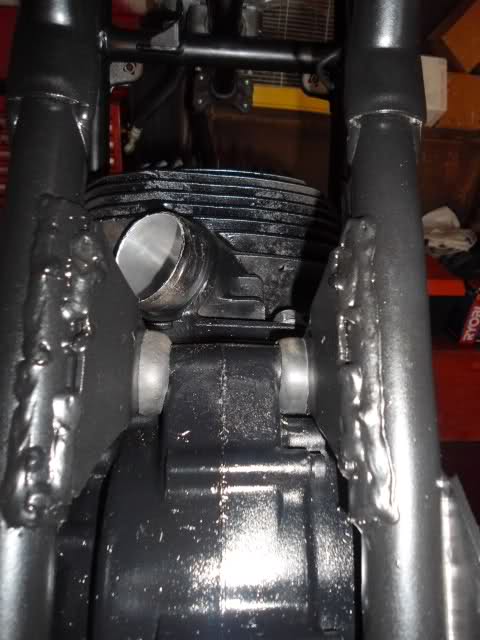

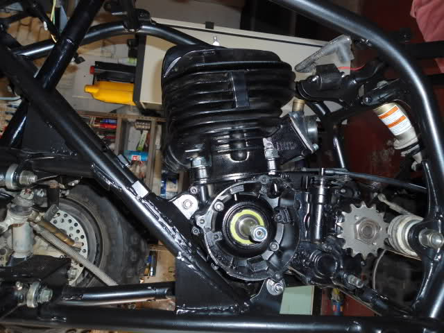

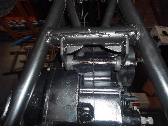

Rubber mounted the 490 motor. This is the front mount.
The bottom mount.
Motor mounted.
The rubber is 70 shore A that I bought at Rubber Products and Moulding Parow. It is what is commonly used on car engine mountings. They look soft because I tightened the bolts as much as I can. They will easily withstand the heat, because I welded the mounts with them on. That part of the motor does not get that hot either anyway..
what is their uncompressed shape? got pics? did you have to make the mounts a little wider than the actual width of the casing to accomodate them?

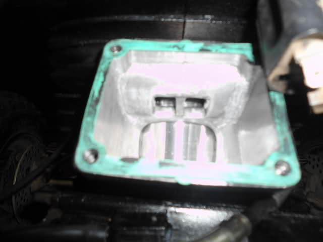

Since the motor is ported the standard pipe will be a bit off. The standard pipe will have to be cut and extended a bit to fit the frame so that will change the tuned length of the pipe. Also the pipe is not in very good condition. We put a degree wheel on the bike and measure the port timing and input that and the bore and stroke and the revs where you want to make power into a program that we have got that kicks out the pipe specs for you. I have also got a Bosson performance exhaust that I borrowed from a friend to compare the programs pipe specs too
All pipes are a comprimise. 1 inch added length will lower peak about 1000 rpm. Nothing to loose hacking the stock pipe. It will allow you to experiment for fitting a better pipe later on. Sickkkkkkkkkk
