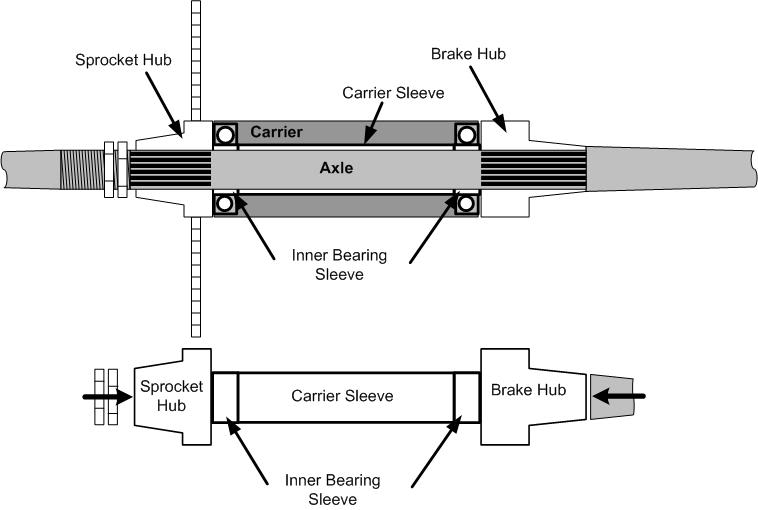

Reading this forum, many people have done this and at least Brandon confirms his fit with "No problems", there has to be something wrong here and there's really only 3-4 things that it can be:
  1. One of the hubs is too narrow
  2. The inner bearing spacer(s) are compressed
  3. Or the Carrier spacer is too short
These should all get compressed against each other between the nuts on the left and the axle shoulder on the right so the bearings roll without any undo side-to-side stress. There just isn't anything else. If I had some dims. of what these widths should be I could ID the source of the problem. In all likelyhood, It's the bearings &/or Carrier Spacer:
And since I'm gonna replace them after I test-ride the mods and tear down for powder coat, I might as well just get a really big, hardened washer to fill the gap like Phragle suggested and run with it for now. If it ends up being permanent with the new bearings (and maybe a sleeve), I suppose I can live with that.

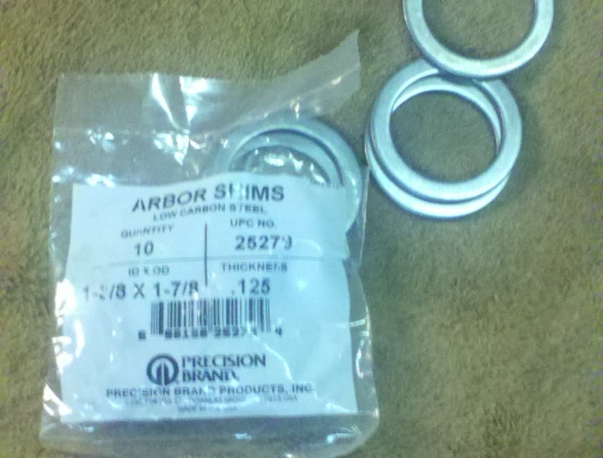

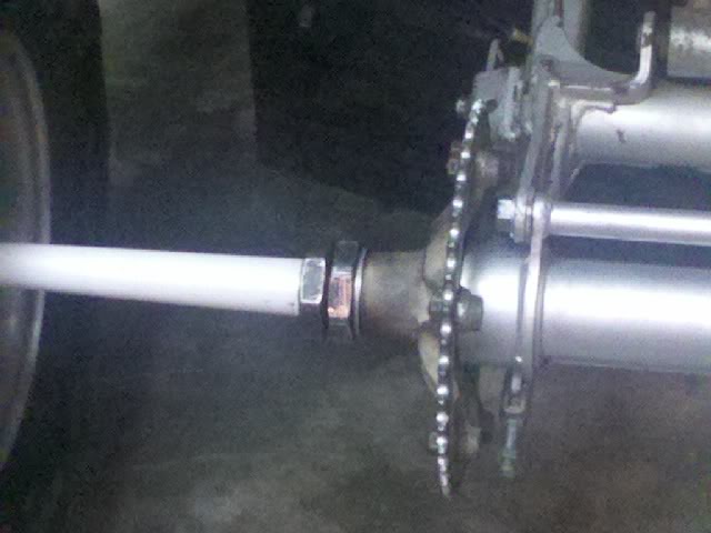

McMaster Carr is AWESOME! I've used them many tomes for "Special" hardware as well as some common stuff and I've never had slow service. The search feature on their site narrows things down what just what you need and you get it in just a couple days with standard shipping. I got these "arbor spacers" after I measured up what I needed and they'll do the trick until I tear down and check the dimensions on the bearing spacer inside the carrier.
Put one on the axle and it tightened up just like it ought to...

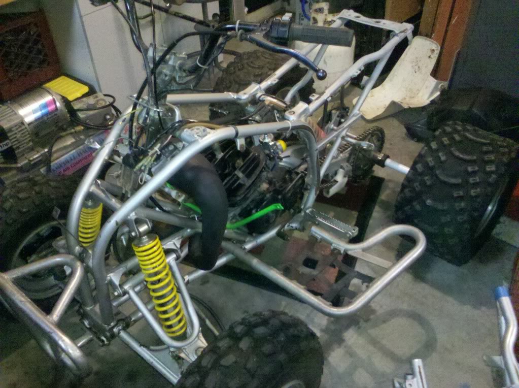

They sure are I:I I finally got the YFZ 450 shock that I won on ebay for $5 + $25 shipping (good deal over all). It's clean and tight and now I'm looking at the possibility of stretching the swing arm just forward of the shock mount. At this point it's just a thought, I'll have to get into the garage and look at it real hard with Phragle's "Suspension Geometry 101" Thread in hand:

Well I decided that this damn mouse is getting the better of me so I drop kicked him out the door and set the YFZ shock aside in favor of putting this frankenblaster together and taking it for a ride damn it!
So a great big, whole hearted, thank you to every veteran that this day is dedicated to. I:I I tightened up all the hardware on the rear end, bled my Banshee brakes, mounted the swinger skid plate that came today, put the new chain on, stripped out all of the vestigial wiring that was left over from the TORS and the Oil Pump and rewrapped the harness. Now I'm just waiting for the jet assortment I got from Jets-R-Us (should be in tomorrow I hope, I hope I hope)
