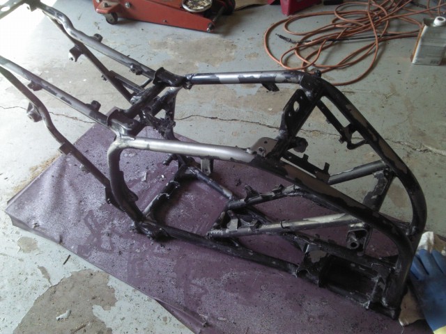

Started stripping the powder coat off the frame yesterday. So far this is what I have been able to get off LOL
I have been using methylene chloride paint stripper so far and as you can see I have been having mediocre results with two passes so far.

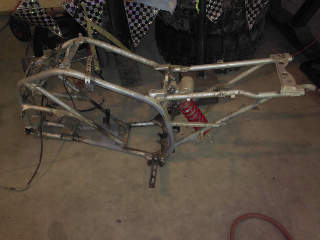

Alrighty, some progress today. We got the 465 out and stripped down the old frame.

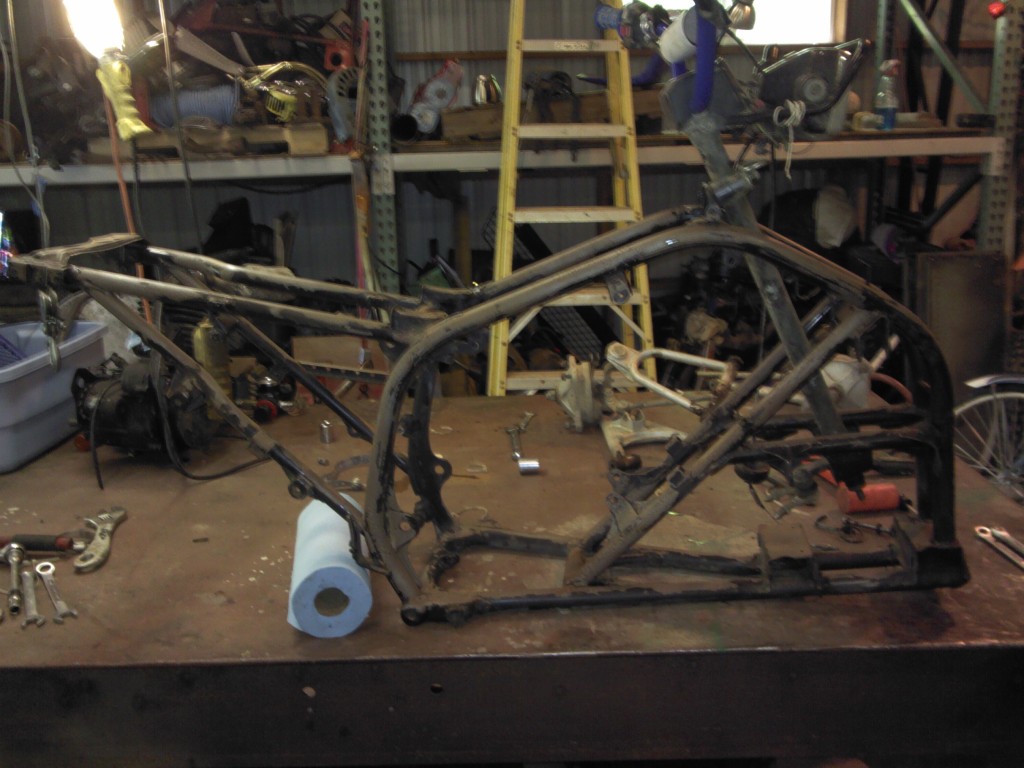

And we got the new frame up on the bench.

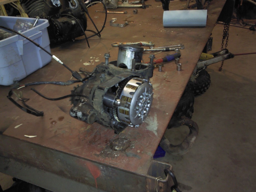

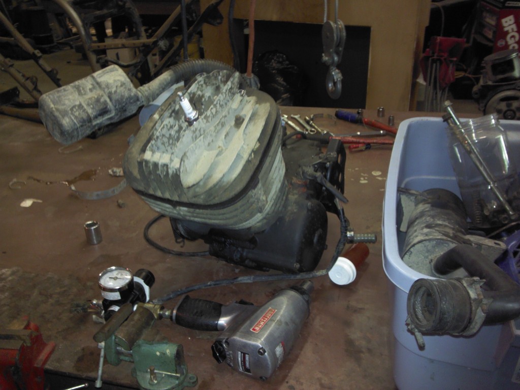

And here's my parts engine. Nice to have spare parts :)

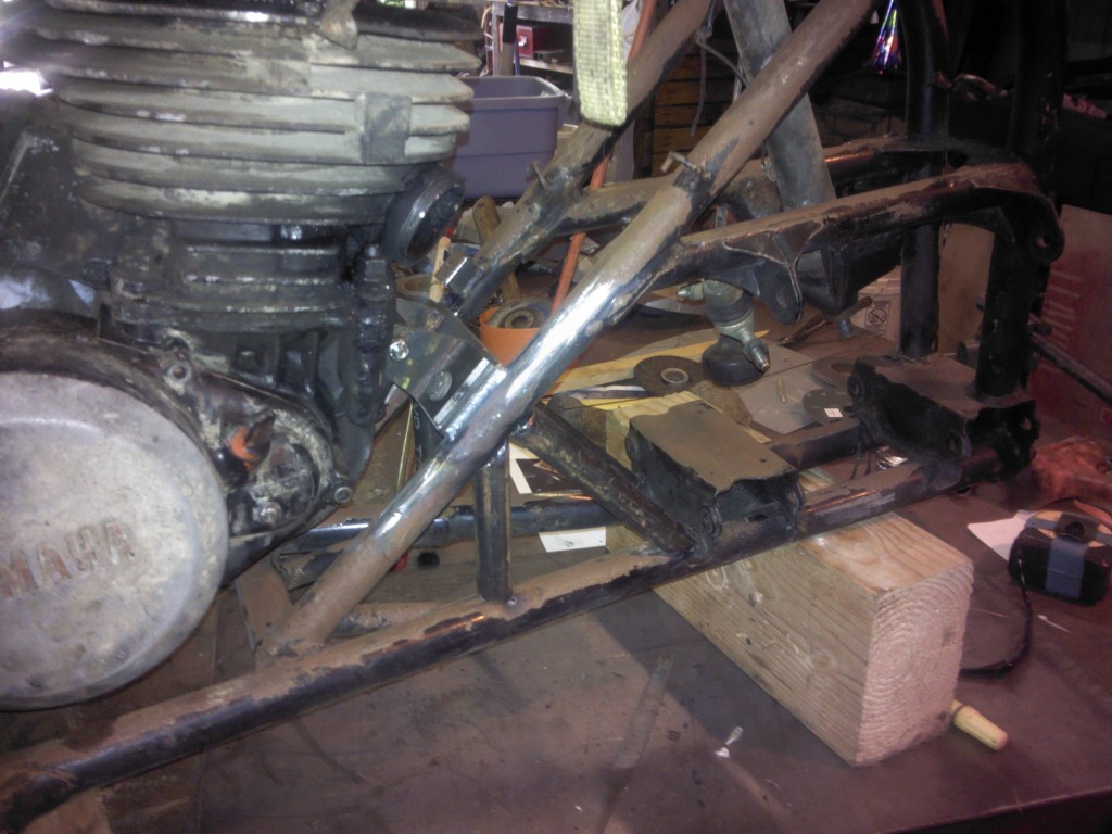

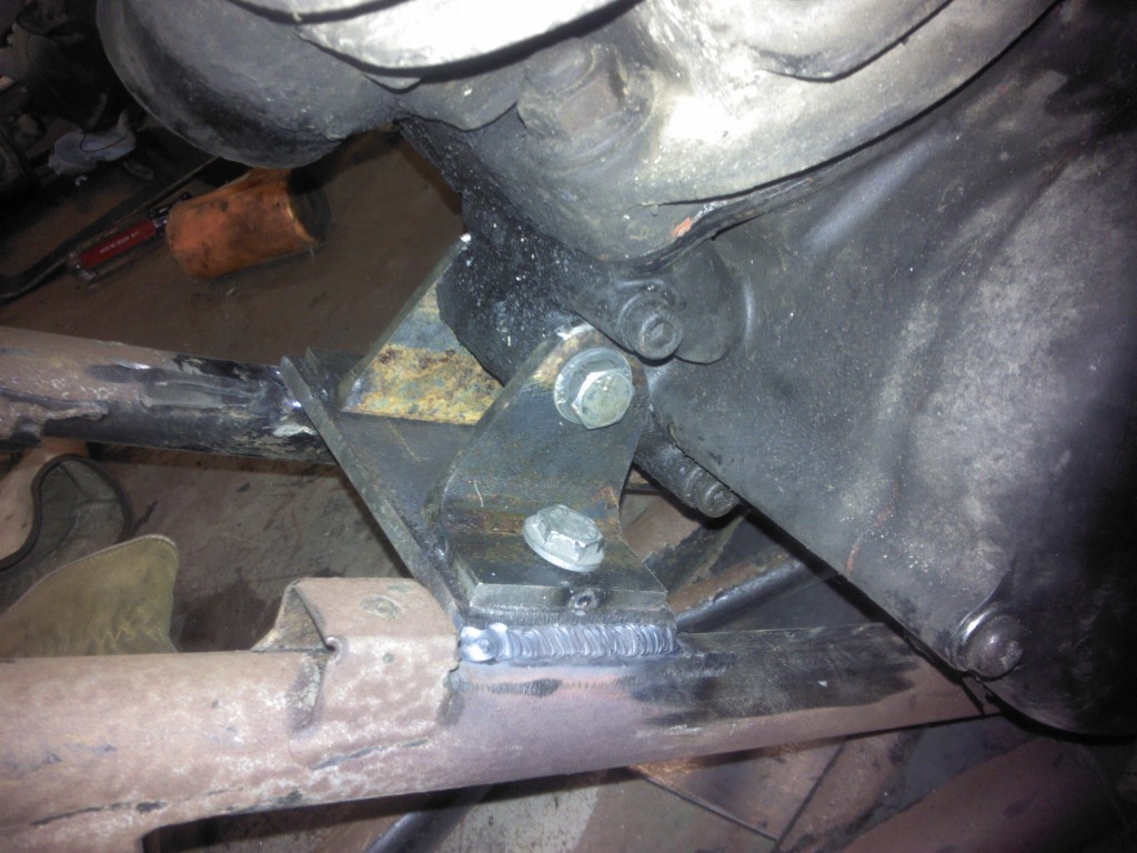

We got some more done today. Instead of drilling through the frame and installing sleeves we decided to weld a plate in and bolt mounts to the plate that way the frame stays intact and I still get bolted on mounts and the engine will go in and out a lot easier. We got some gussets tacked in there too. For the exhaust we have decided to split the exhaust so with the silencer, it will be a 3 piece exhaust with couplers in between.

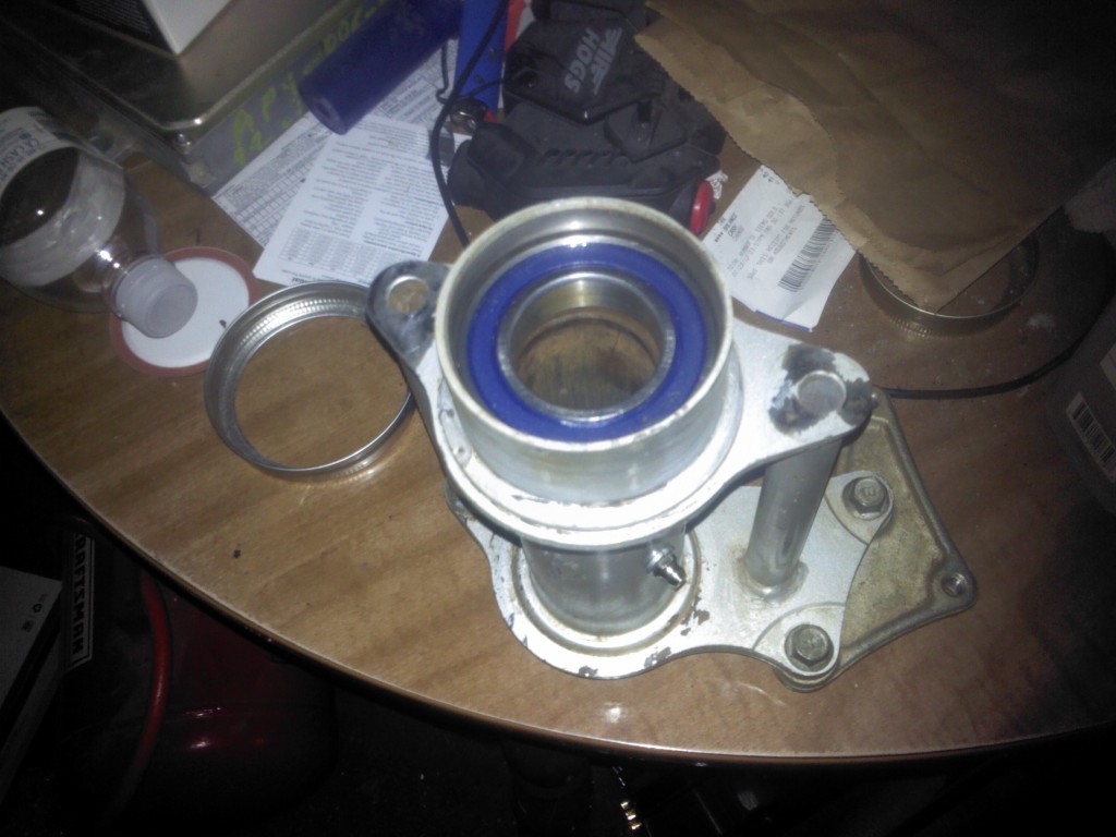

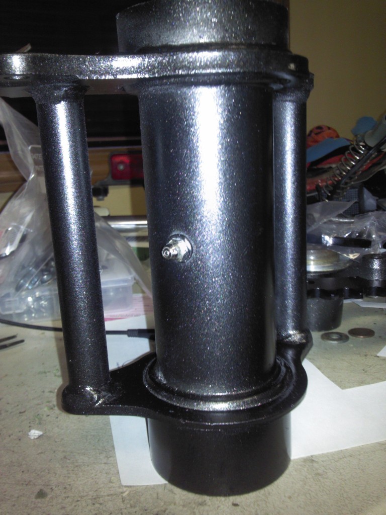

I got some new bearings in my carrier, installed a grease fitting and painted her up.
Slowly but surely its coming together.

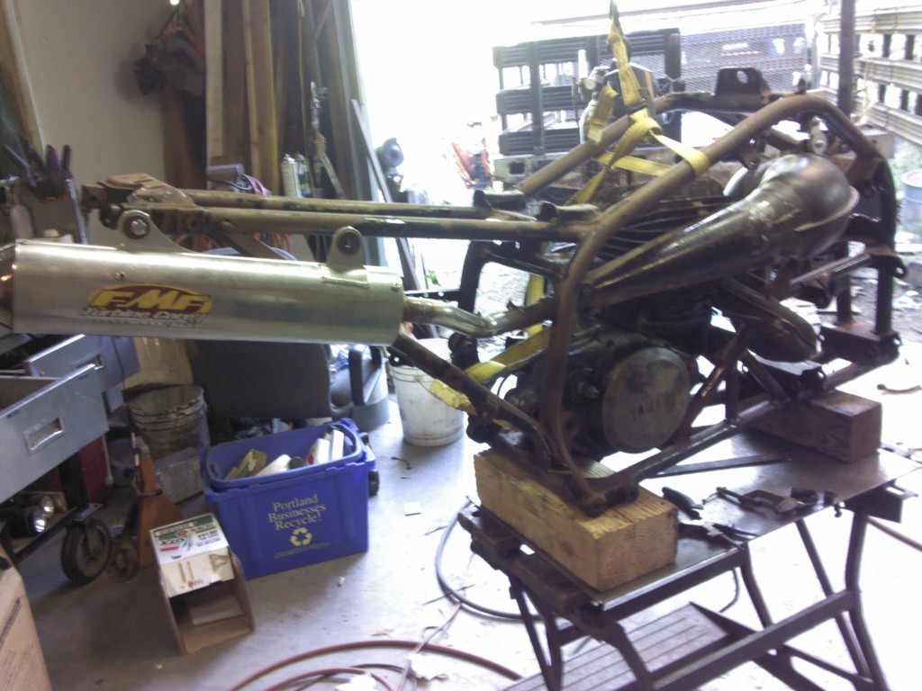

We got the exhaust fabbed up. It's the stock blaster pipe / stock it465 pipe. I know it's not going to run correctly with the exhaust the way it is but I was running low on cash and we wanted to learn on the crappy old pipe before we start hacking up a $250 pipe. Ohh and that is a silencer for a 2002 cr250 ;)

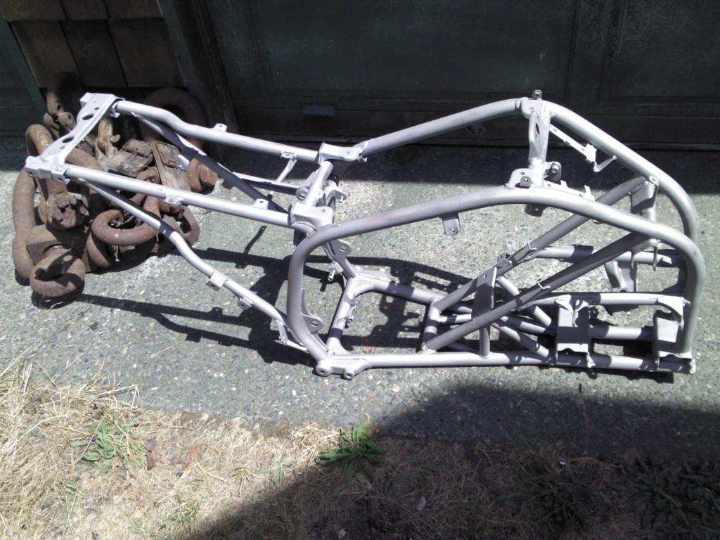

Frame freshly sandblasted. We didnt have time to get the rear gussets in but at least we got the front. This coming winter we are going to do that before powder coat time!!

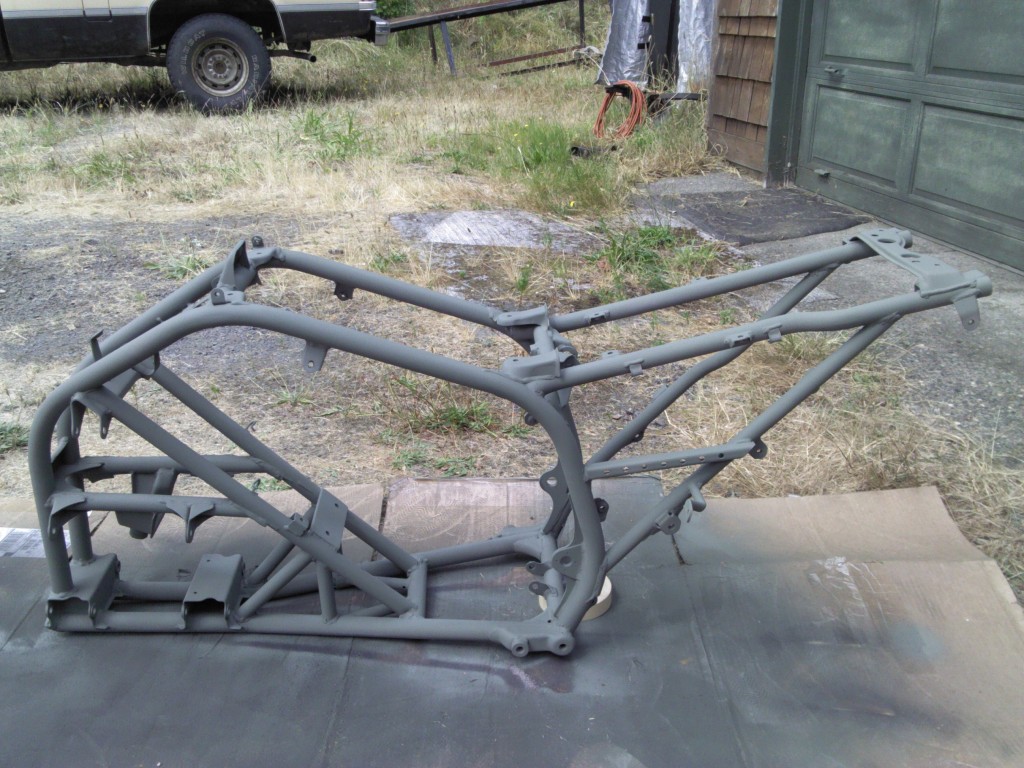

A couple coats of primer

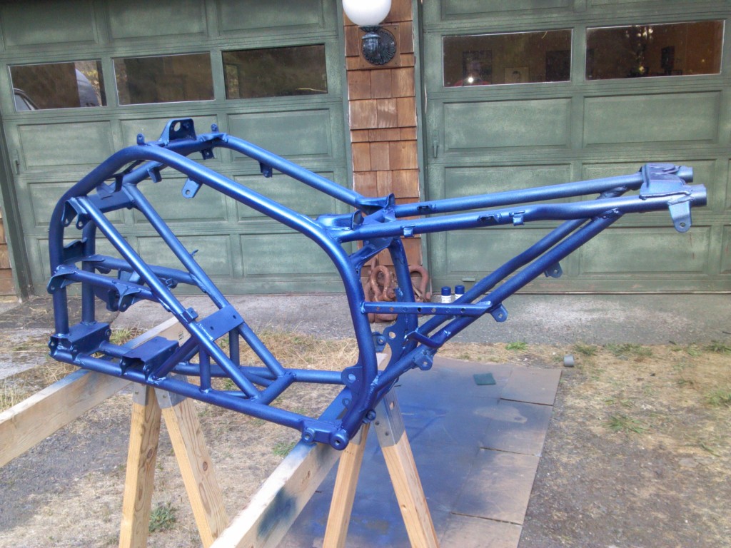

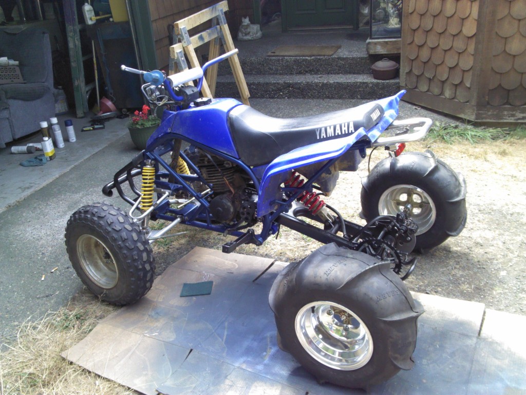

Fresh paint and clear
A buddy and I stayed up late getting it assembled to this point!!
Looking Good ! Like the Blue Frame allot , I Think White Rear Plastics Would make that Blue on frame Stand out allot More !
Thanks! I am getting it powder coated this winter and want to do it in blue so I painted it blue to see what it would look like. I'm not totally set on it but I think dark gray plastics would look great with the blue. You are right though, white plastics would make the frame stand out a lot more.

Wow man. This build is looking sweet! You deserve some rep. Those motor mount welds look awesome!
Thanks!! My father in law is a really good welder. He welds stainless steel all day in a fab shop.
