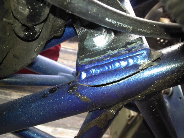

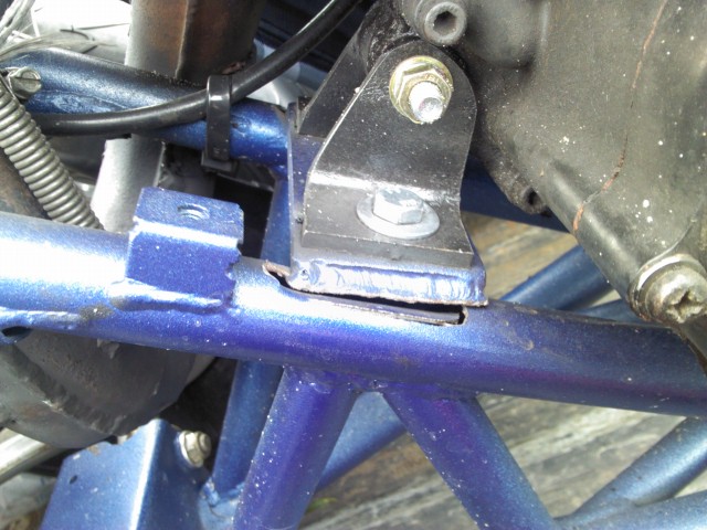

I wish I could man. I rode it for ten minutes before the frame gave way at the front mount welds. Will have pics up soon for the welding experts on here. :(

And here's the carnage. Any suggestions on the repair?
Left side
Right side
Only thing I can think of is half round tubing welded over the bad areas and a redesign on the front mount. Is that the best route to go? Also thinking of making a lower mount. I really didn't think it would be necessary but what I see tells me otherwise.
Either way a 1/4" plate mount like I used before is out of the question. Looks like it took way too much heat to mate the plate onto the frame making it fatigued.
Anyone have any suggestions on the best way to repair the bad parts on the frame or is it new frame time? I am also open to suggestions on a different way to construct the front mount.
I think the idea you had about the half round tubing welded over the bad areas and a redesign on the front mount , That sounds easier than buying a frame and swapping everything after you paint or etc

I think the welds were plenty strong also. My suspicions are that the 1/4" plate takes too much heat for proper penetration for the thin wall mild steel blaster frame to handle. I haven't touched it since I got home from the trip. I have just been thinking of different ways to fix it and mount it. It definitely vibrates more than a stock blaster! It's not that bad though. I hear the 490 is much much worse in the vibration department.
