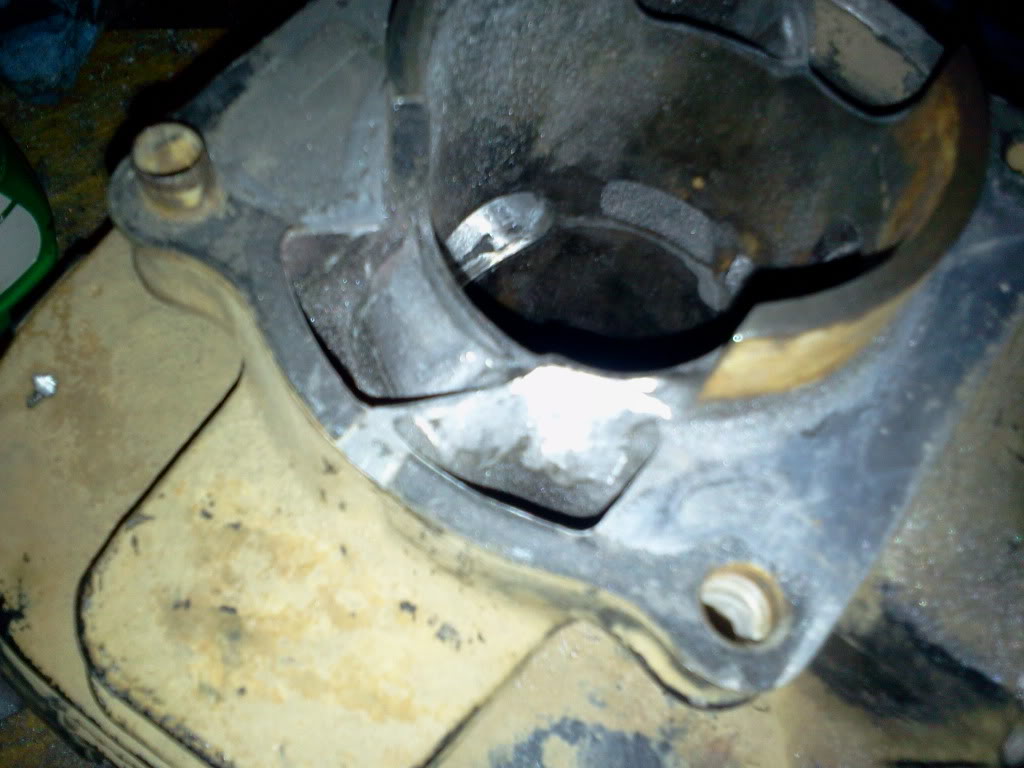

heres my intake this is the cylinder on my new bike im building but this is what my transfers look like i dident have a pic of the transfers on my bike
ya the 400 probably has 2 or 3 times the money in the motor than mine does
heres my intake
The ports could be opened up some and the casting flaws should definatly be cleaned up some.
What was done to the exhaust because that iss where most of the power gains come from.
You should expect to experience little or no power gain with that amount of work that was put into the inlet.
