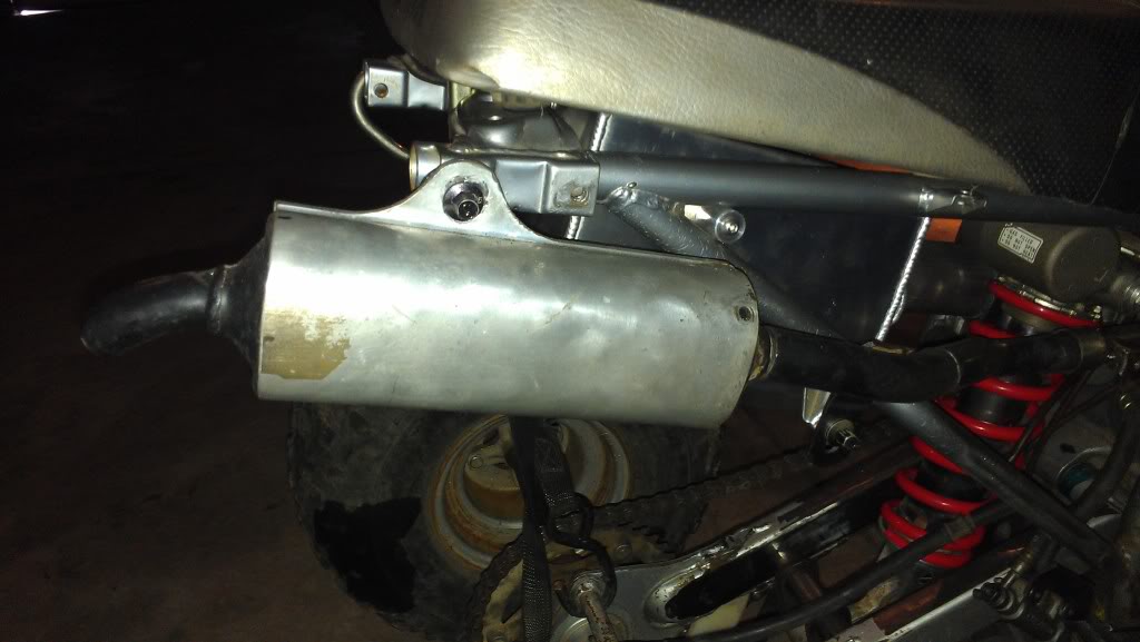

Well, I had to redo the exhaust routing. Put my radiator back in so I could modify and mount my air scoops. Cut my fenders and mounted them and the scoops. Made two mounts that bolt to the radiator and drilled a hole in each scoop and mounted them. Spent most of the day making a rear caliper mount out of cardboard several times till I was happy. Cut out the final design from steel. Made a couple spacers to locate the caliper center on the disk. Very happy the way it turned out. All I think I have left to do is make the gussets. Lots of welding to do now. Need a brake pedal still. Anyone have an extra laying around? Oh, and make one more brace for the swingarm. Once I know I have the rear suspension working correctly, I will send swingarm out to get replicated 3 to 4 inches longer.
here are the latest pictures. let me know what you think.
