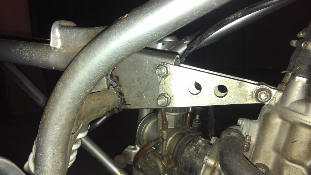

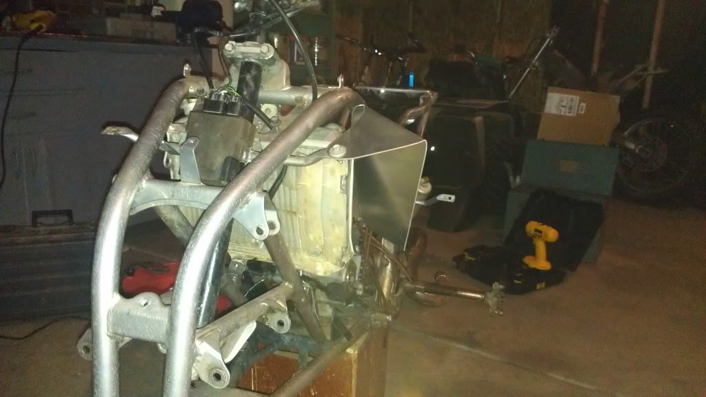

Ran into bit of a problem. Mocking the radiator into place and my air scoops, I found my motor was sitting a bit low. So I'm back to square 1 with my mounts. Now instead of just making lower mounts and the head stay mount, I have to remake my lower templates and now, front mount templates. Oh the fun of customizing.

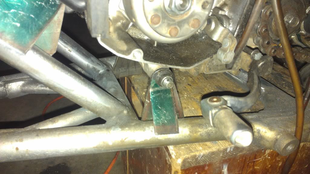

Got the the original front mounts cut out. New cardboard mounts designed for the head stay and front. Will try to make the bottom ones as well.

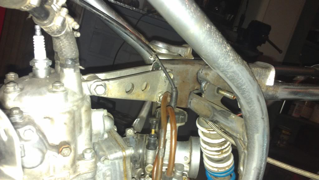

got my new mounts layed out in steel plate. need to get some new cutters before work and tomorrow will begin cutting them out.
Got the front and lower mounts made and bolted in place. They are holding the motor up just right. Just have to make the head stay mount and radiator mount. Once that's done, I will be ready to weld everything up..

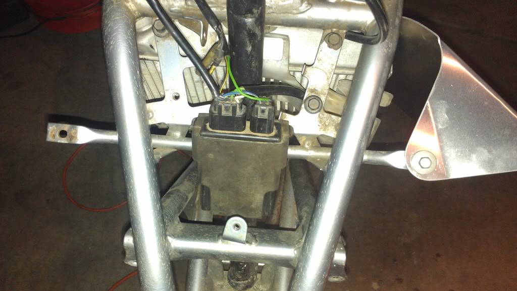

I'd move the coil to other side away from ex heat.
JMHO
I took that into consideration but the coolant lines are in the way. if I mount the coil where I plan to, the exhaust wont be an issue. I wont get heat soak into the coil. since I made the head stay mount, the coil has no where else to live so it will have to stay where I placed it.
Looking good so far and making great progress. Seems as though the sprockets lined up nicely.
That was one of my main concerns getting them lined up. I had to be 100% sure before I cut the swingarm. After that, everything fell into place.

Thanks. They are fairly easy to make. My tools are a 4 and a half angle grinder with cut off wheels, a bench grinder and a bench drill press. A few hand tools, some layout die and some time. Once I finish making some mounts and weld them all in Sunday, I get to start on the rear suspension. Got some major plans in store there.

Got 90% of my mounts made. the motor, exhaust, coolent and airbox are done. Once it warms up a bit and I finish my coffee, ill be loading up all the parts and headed off to my moms to weld everything in. The other 10% will still need to be made. Have to make a mount for the rear master cylinder and plunger. Going to be making a very custom rear suspension. And yes, I will be eventually using the swingarm shop swingarm. The guy is only 20 minutes from me and he said he will work with me to make a swingarm to my needs. And once you see what I have in store, you will like it.
