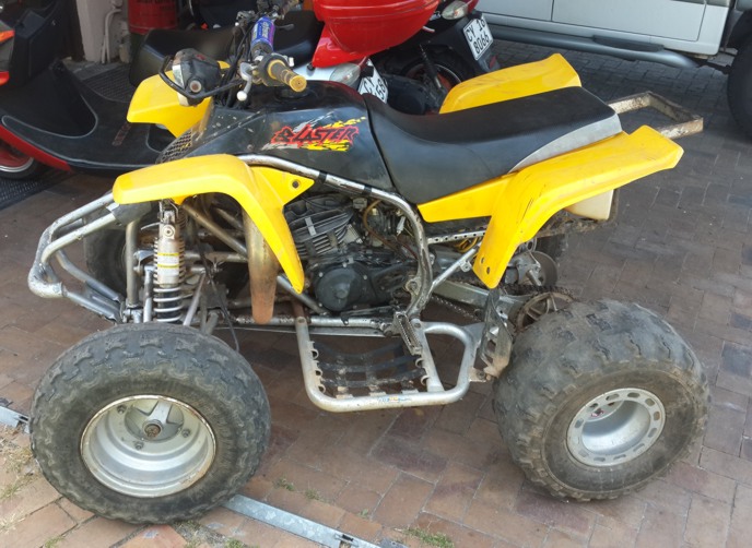

Here, goes, my new baby just got delivered this morning, already striped it all down, and cleaning up. Not sure whats all done to the motor, but the owner says it wheelied in 6th..
Checked the carb and it has a 310 main, so that gives me the idea of some mods, probably porting too.
Notice the nice shocks... all around gas.

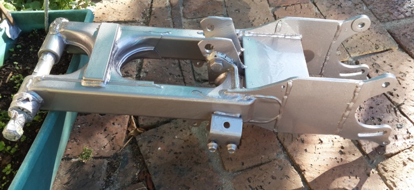

I noticed the swingarm had a stress crack in the top brace, I suspect its due to the wheel spacers. But, I am going to extend the swingarm by 4", will do some extra bracing at the same time.

Rather than just extending the junk stock arm, why not build an all new one?
Blaner has a good thread on how to, and I'm sure there's others.
Cracking on the cross brace is very common.

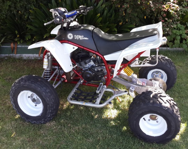

Anyhow, here are the before and after pics, all done in 1 week.
swingarm was extended by 4" and braced on top with a 20x10mm bar, mig welded, also raised the shock bracket as it was a bit too low with the new shock.

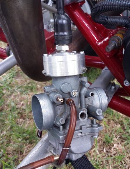

Then came the dilemma, i noticed that the carb threads were stripped on the slide cover (common issue), and i really don't approve of that heavy TORS unit sitting on top of the carb, so, 2 or so hours later, I finally finished machining a new cover, which gets tightened permanently with tapered grubs, and some sealant for just in case some dust wants to find it's way inside. Then came a cap, with 6 screws holding it together.
The Stock cable does work, but requires a bit of filing to get into the "slide clamp mechanism).

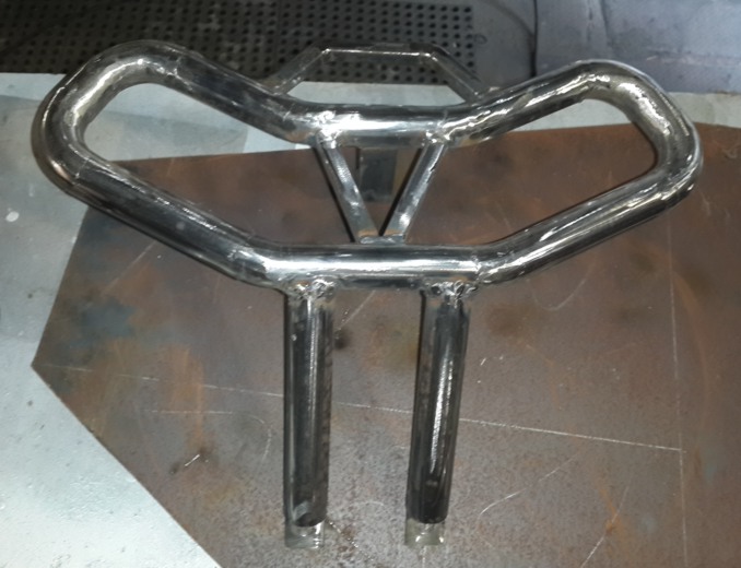

Lastly, there is my home made nudge bar, made with some steam bends and 2mm tubing, not as heave as it sounds though...

To Herp: I made the carb cap myself, turned out of some 50mm ally stock. If you have access to a lathe and some taps, its not that hard to make.
An aftermarker cap would not fit either, as the threads are damaged.
The previous owner just cut two slits in the origional cap, and put a heavy duty hose clamp around it, does not tighten up properly, but works... dust can still get in, and if by any chance it does fall off...
