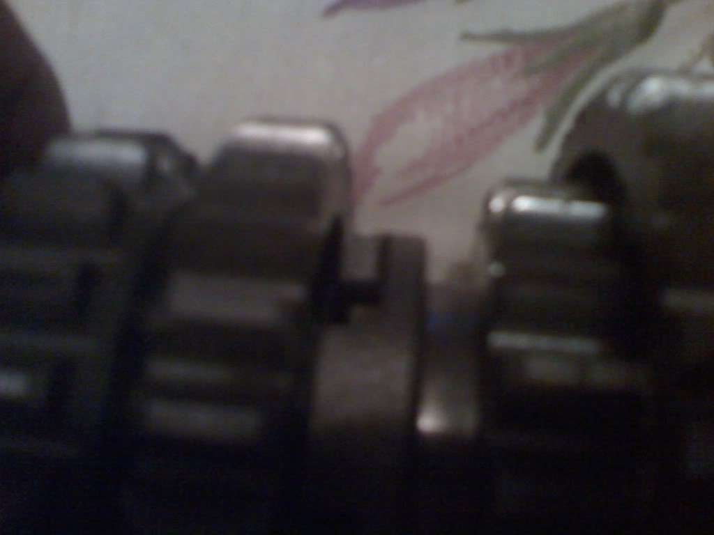

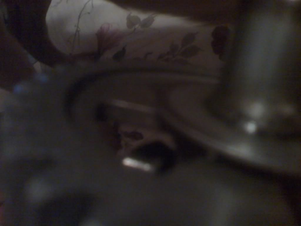

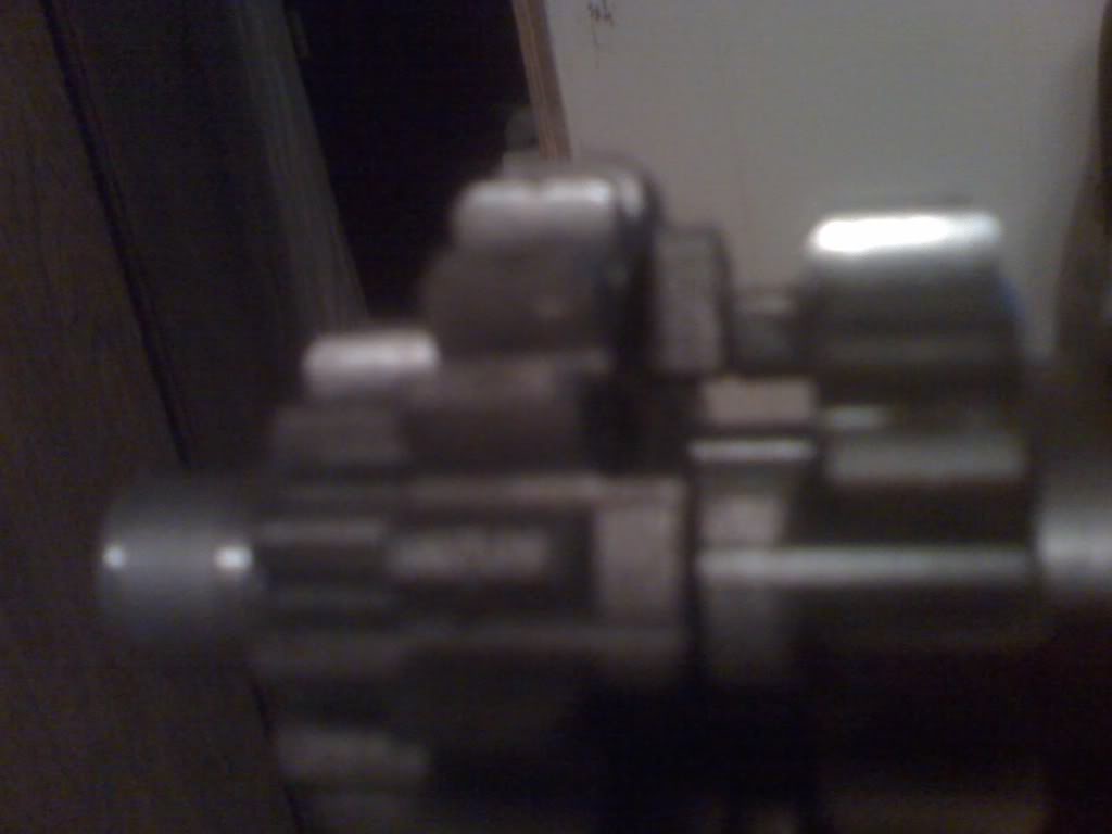

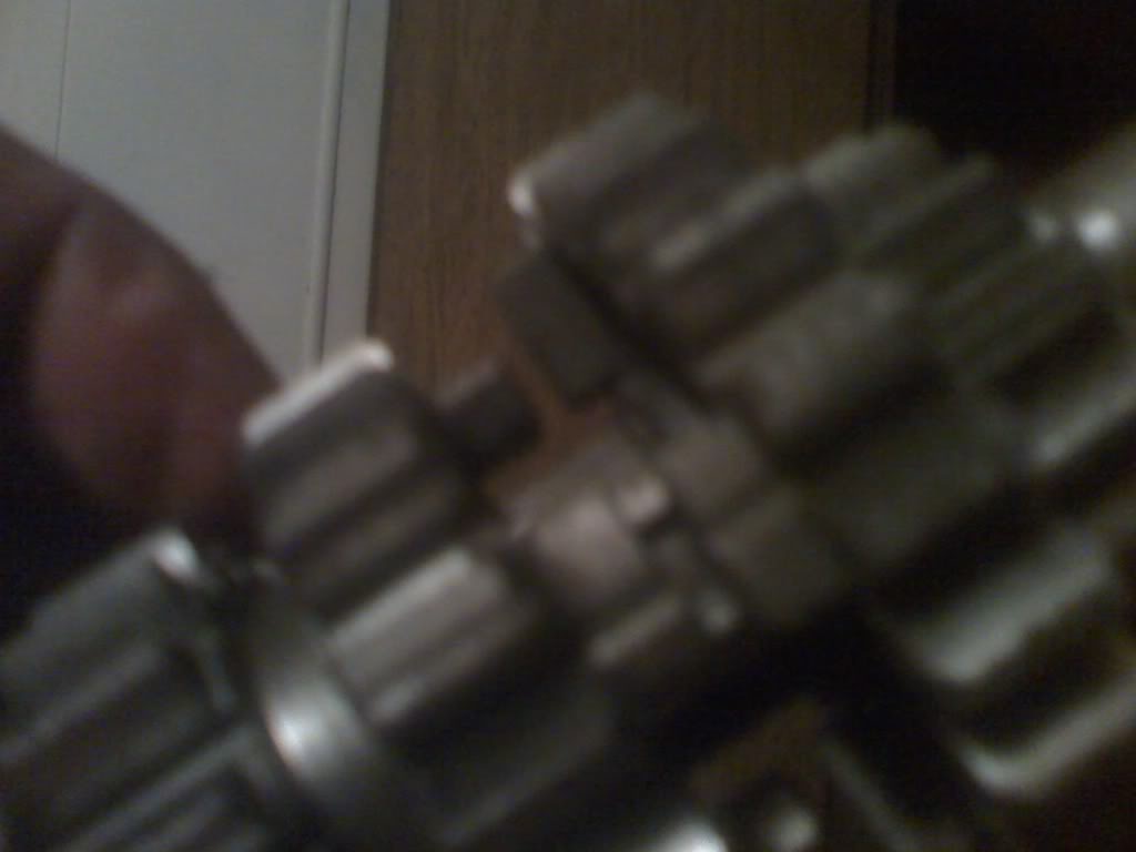

If this would cause wear in the gear box, where would it occur? I have my original transmission sitting right here on my desk. It was used from 1996 till 2007 I bought it in 06' and put at least a hundred hard hours on it rarely ever using the clutch. The guy I bought it from used it for flat track and some trail riding and openly admitted not using the clutch. Here are some pics of the tranny the pics are not very good but if you like I can tear it down to get better pics. You will clearly see that there is no excess wear on the gears other than where the bearing went through it. The paws are in perfect condition.
