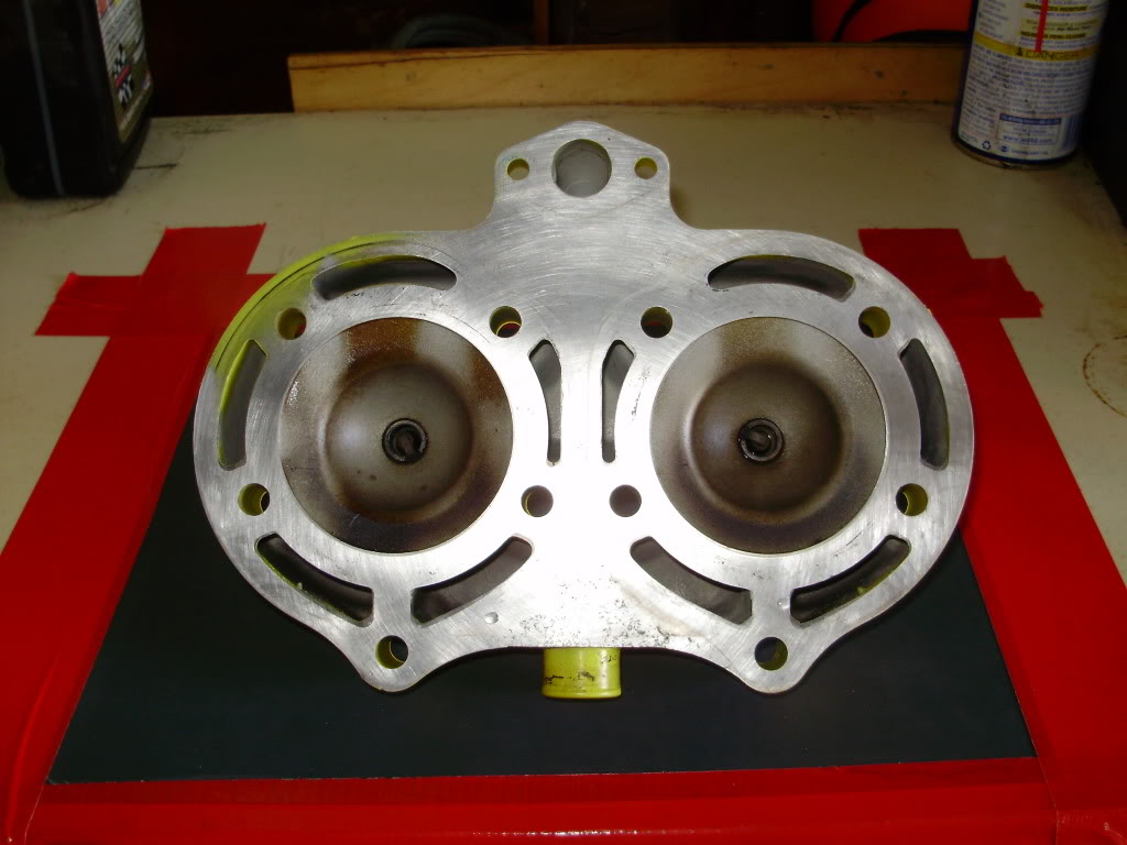

To fix it tape a piece of wet or dry 400-800 grit sand paper to a flat surface. I like 400 because it works fast.
The yellow powder coating over spray tells me my head is warped and there is a low spot in that area
![P4070014.jpg](/proxy.php?image=http%3A%2F%2Fi31.photobucket.com%2Falbums%2Fc387%2Fpb_paulie_b%2FP4070014.jpg&hash=26e2f59d0c89580e96dc7ab16db3cdbb)

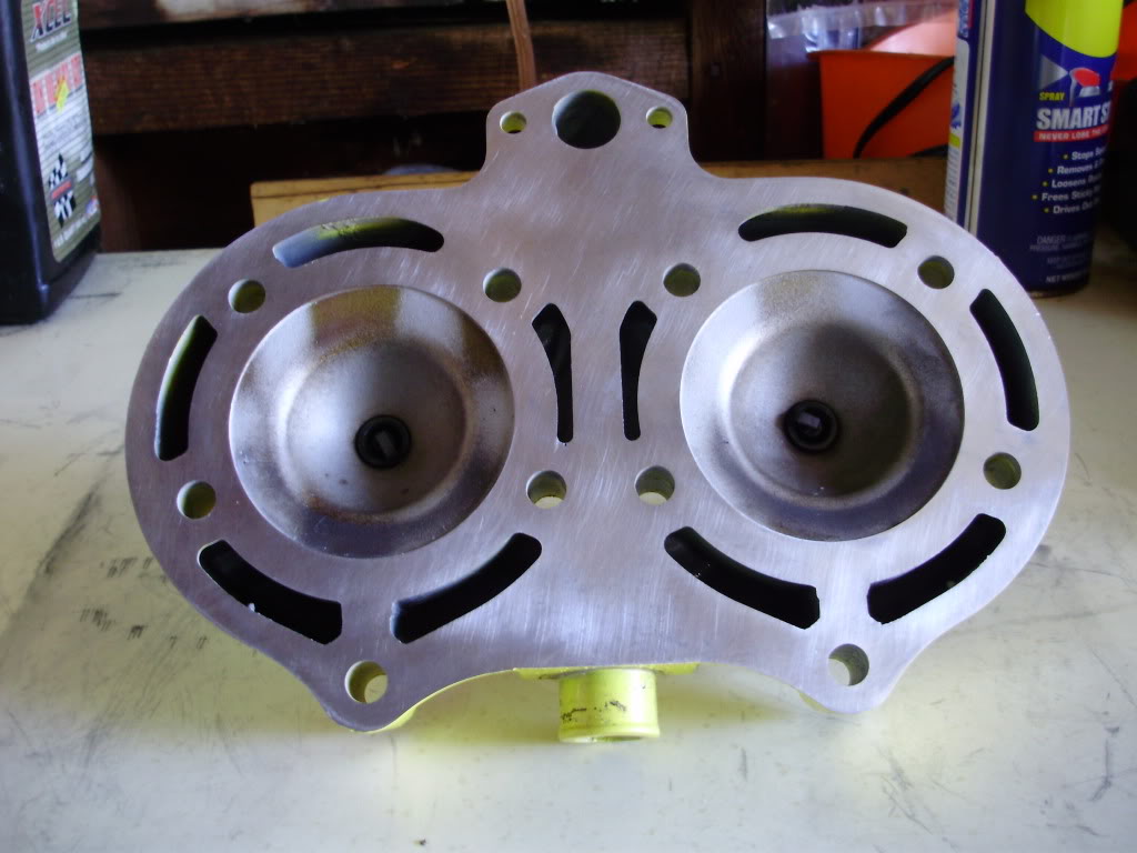

Keep goin and spray fresh oil on the paper every now and then. I also wipe the sandpaper off with a rag to keep it cutting fast.
For my head it took a good 20 minutes and I would consider mine to be pretty bad.
You will know when it's enough by the whole sealing surface looking uniform or all the same.
![P4070023.jpg](/proxy.php?image=http%3A%2F%2Fi31.photobucket.com%2Falbums%2Fc387%2Fpb_paulie_b%2FP4070023.jpg&hash=9653aebf413ad63f26b9f99cfaf3772f)

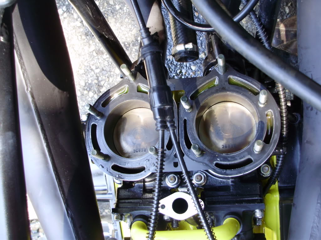

For the record I don't think mine was leaking because the powder coat filled in the low spots but I'm not the type of guy to knowingly run something I know is wrong.
![P4070011.jpg](/proxy.php?image=http%3A%2F%2Fi31.photobucket.com%2Falbums%2Fc387%2Fpb_paulie_b%2FP4070011.jpg&hash=02357780b4c61f1928d5ec2ae094b112)

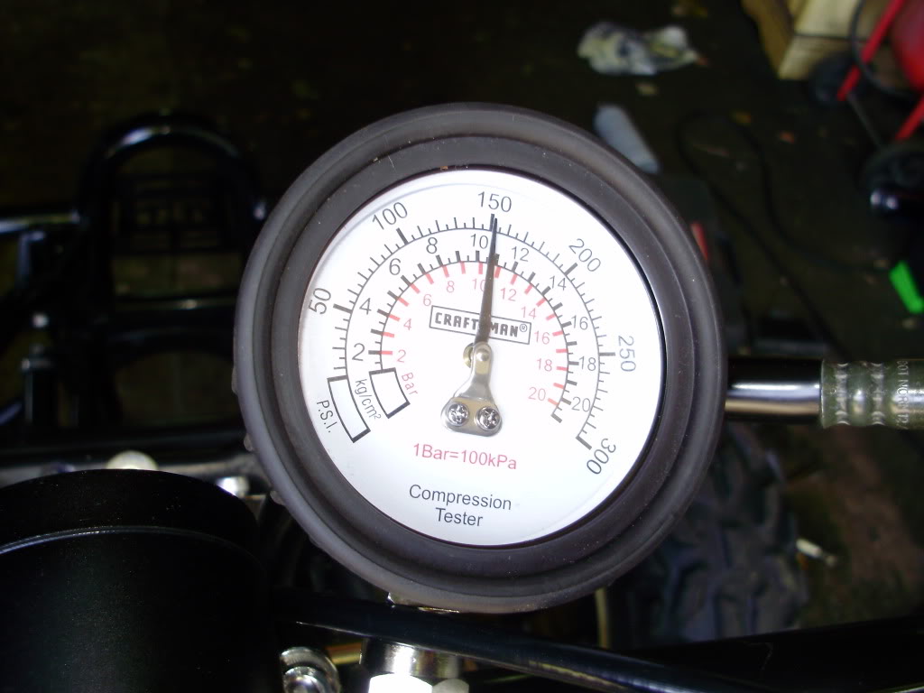

You might be curious like I was as to any performance increases since in a way you just milled off material from the head. Well here my compression before and after 20 minutes of work.
I gained about 6 psi- not enough to affect my tune, and in no way a substitute for having Flotek mill your head which would also fix any warpage.
Before:
![P4070009.jpg](/proxy.php?image=http%3A%2F%2Fi31.photobucket.com%2Falbums%2Fc387%2Fpb_paulie_b%2FP4070009.jpg&hash=8d828ecad4aeb7c13eb5af671484ba0e)
After:
![P4070024-1.jpg](/proxy.php?image=http%3A%2F%2Fi31.photobucket.com%2Falbums%2Fc387%2Fpb_paulie_b%2FP4070024-1.jpg&hash=252e8ac5835668c6149549360971b2a7)
