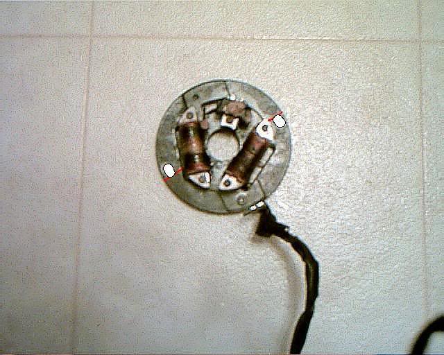

Just print out a 4.5" 360 degree protractor(or 180 degrees). Mark an arbitrary point like "0 degrees" and then put a mark at "4 degrees" above the stock timing mark you made. For instance, the red line on YFS's post is the stock timing mark you make.
Now since you have a circle, put the protractor along the edge of the circle and just measure 4 degrees up and make a mark at 4 degrees up on the stator plate. This is now your new mark you want to hit for when you elongate the stator plate holes where the screws were. When you made the stock timing mark, you also make it on that little bit attached to the case. Just line up the 4 degree mark with the stock timing mark on the case and you are good to go. YFS said 3mm simply because 3mm is about 4 degrees. Using degrees is more exact but both work.

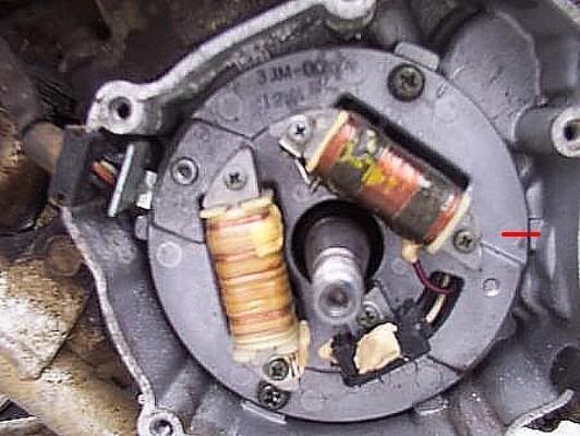

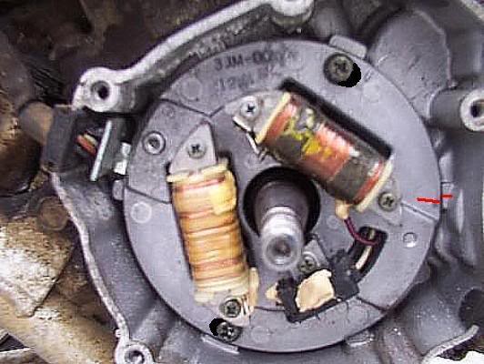

Don't get confused by the red lines in this pic. They aren't the timing marks...just an idicator of how far you widened the screw holes. Even if you widen them too far, it's no big deal since you will tighten the stator plate down anyways.
As you can tell in this pic, YFS didn't actually take another pic after the advance, he just used MS Paint to illustrate what it should look like. :D The red mark on the stator plate is where you marked the stock timing. When you make the new 4 degree mark(like I said before), it will line up with the stock timing mark on the case that you made initially. He doesn't show that here as he made his marks on the screw holes instead, but I find it to be easier and more precise to go from where you made the stock timing marks.
