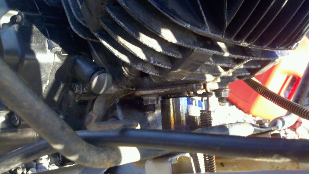

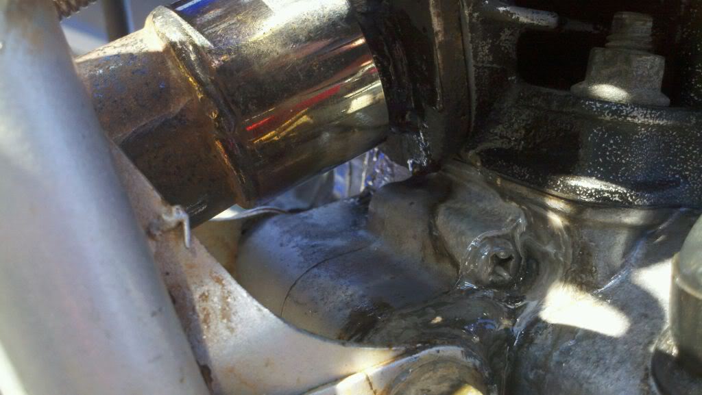

there's also some liquid stuff leaking from the front around the exhaust, it looks like its either a bad cylinder to block gasket, or something doign on with the header becuase its all oil
here's some pics of it.
brian u need to silicone the head pipe to the flange with orange high temp silicone and teh flange to the jug the same way or they will leak oil . going back to the pics u posted that intake is cut like that for vf3 reeds and as i told u did not run the reeds u took a pic of in that motor u asked if i had a set i could send u and those were a set i had laying around from a different motor. now get your carb straightened out before u destroy the rings on that motor by washing them out

read my reply earlier its leaking oil from the header flange as he didnt silicone it
you know what i used to fix the leak around the header flange is at o reilleys they have high temp radiator element gaskets i believe it was and i found one that fit perfect and havent had a leak since out of it.
