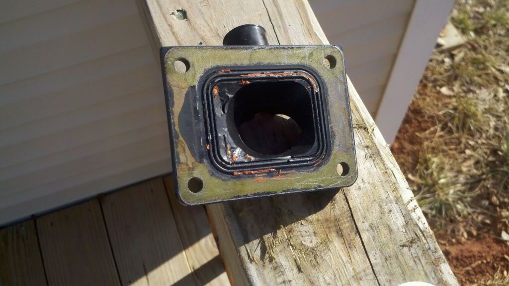

You can get new gaskets from ebay or bikebandit.com. From the factory, there is no gasket between the stock intake boot and the reed cage, but if you use a reed spacer, you will need a gasket.
The stock intake boot has a 'crush ring' around it that is designed to seal the boot against the reed cage. If you find sealant around the intake boot like you did, it may be a sign that somebody has tried to fix an air leak there.

here's a pic of the boot that came on the new engine

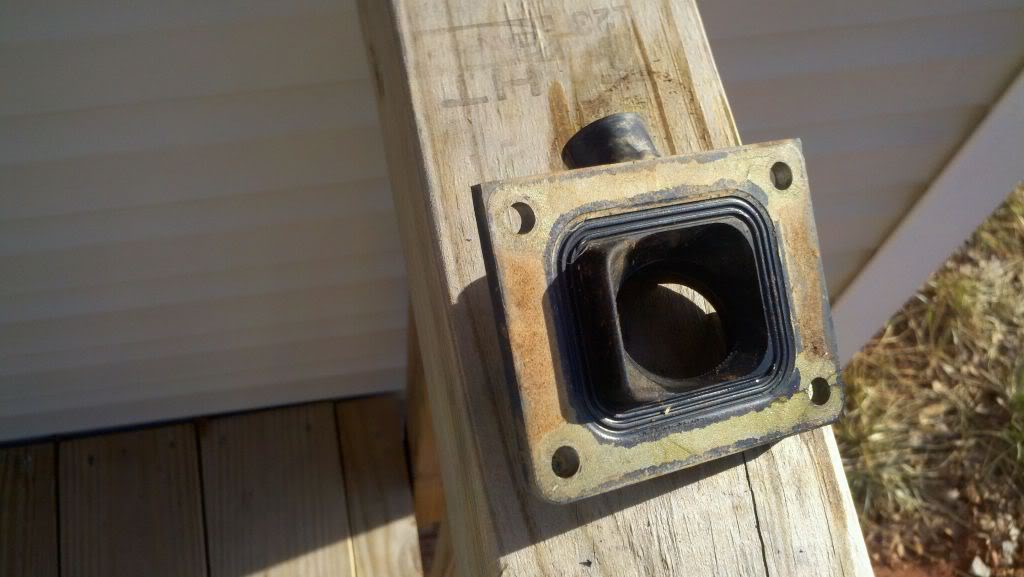

heres a pic of my old OEM boot

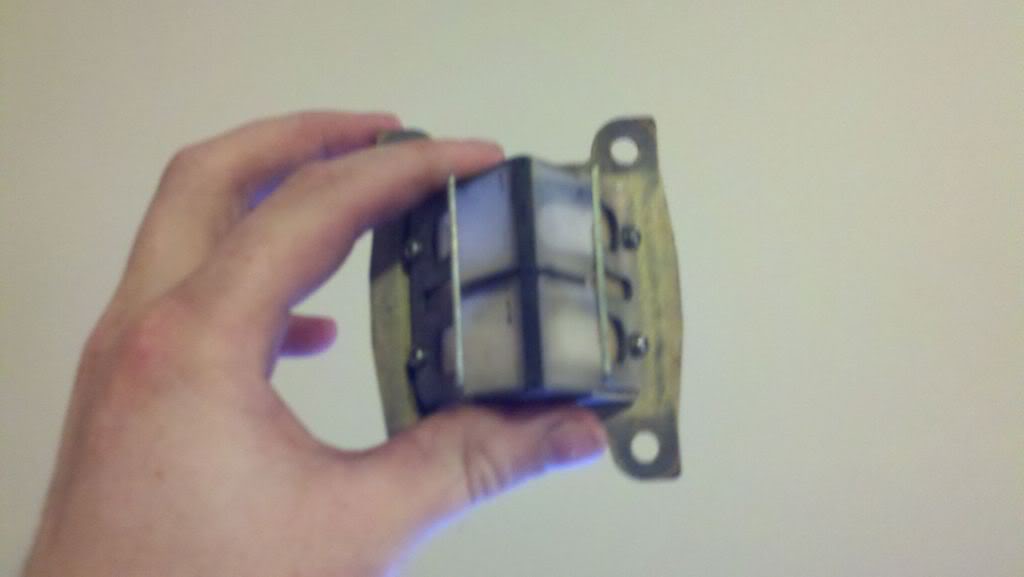

here's a pic of the reeds from the new engine, they are c/f not sure what brand though.
mine has the oem reeds so im thinking of using my OEM cage, and boot. and the reeds from the new engine.
and puting 3 gaskets in them unless this would cause an air leak in the boot. does this sound like a good plan?

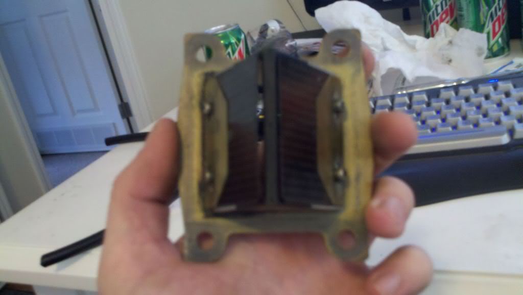

also, here is a picture of the reeds, one is not siting perfectly flat against the cage. could this be the cause of my problem?
what i meant is that if a tiny chip will make it run bad that huge gap probably wont even let it start. that is almost def ur issue
i was afraid of that :( I guess i'll try my OEM reeds on it fromt he old engine. they are really dirty but maybe they'll clean up.

ok here's how it looks with the stock ones, perfectly flat so i guess these are better.
Much better! That huge gap in the reeds in the first pic WILL prevent the engine from even starting. The new cage in this pic should solve the problem.

Add that extra gasket; that way you can be sure you have a good seal between the intake boot and reed cage. VF3 reeds already call for a gasket here; it is OK to update the stock cage with a gasket as well.

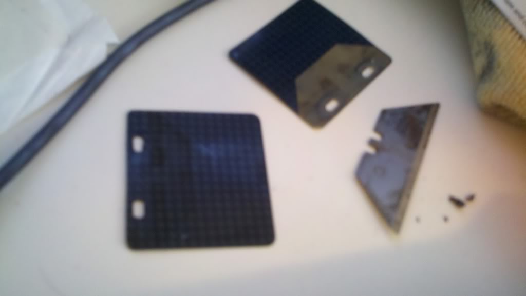

you can also take the reeds off and flip them over to get them to sit flat. and if no one has mentioned it use lock tite on those threads so you don't end up with one of those screws ditroyin your piston
Yes! Just thought I'd clarify a little, though... Loctite is a MUST on the small screws which retain the reeds. However, do not Loctite the 4 large bolts which hold the reed cage/intake boot to the jug. These bolts get stuck often enough without putting something on the threads to hold them in place.
