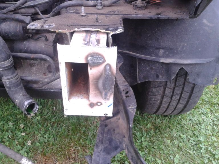

todays progress..... DIY frame rail end I:I
would have finished it had it not started lightening bad :o
and self tapping oil drain plug to replace the stripped/leaking existing one in the aluminum oil pan, and fresh oil.
this is the same powder coated box tubing from a treadmill my neighbor gave me, that i made dualstroke an engine stand out of. it is the same gauge steel as the existing box frame on the car. I found a piece that fit in perfectly top to bottom. but needed to be 1" wider to fit side to side. so i split a piece lengthwise 1" wide and welded it to the full box piece for a perfect fit
it fits so good it needs tapped to slide in, and is back into the frame at least 6-8" before it hits a bend. the very ends of the cars frame rail still need tapped in slightly yet for welding.
the vertical piece was existing to the treadmill ?
after attaching the core support and bumper rebar to give me the correct spacing/alignment, the original mounting plate, we cut from the damaged rail, will get welded to the home brew end, fully welded to the existing frame rail, and hide it all with a coat of spray on bedliner :D
