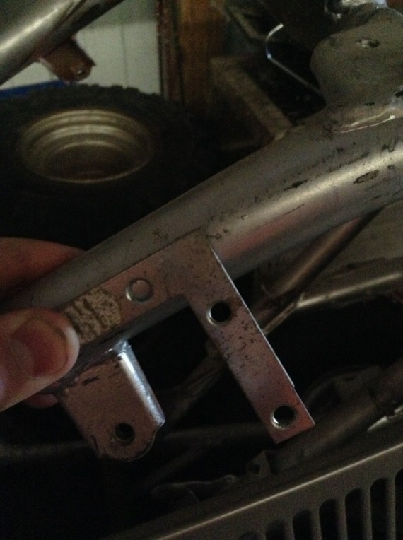

Thanks AWK, I was afraid someone was going to tell me that. I thought 89Blaster89 had the CFM's until I saw this thread, that is why I asked for them 8-| Is there a way to post photos here? I took some pics of what I'm working with and I'm not sure what the stock mounts are supposed to look like.

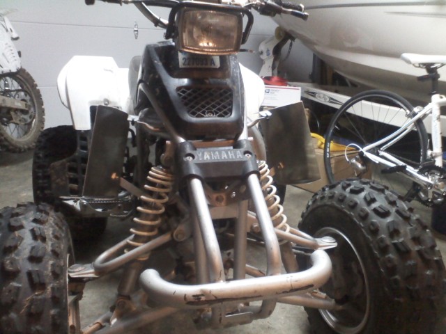

Here's what I'm working with:

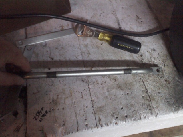

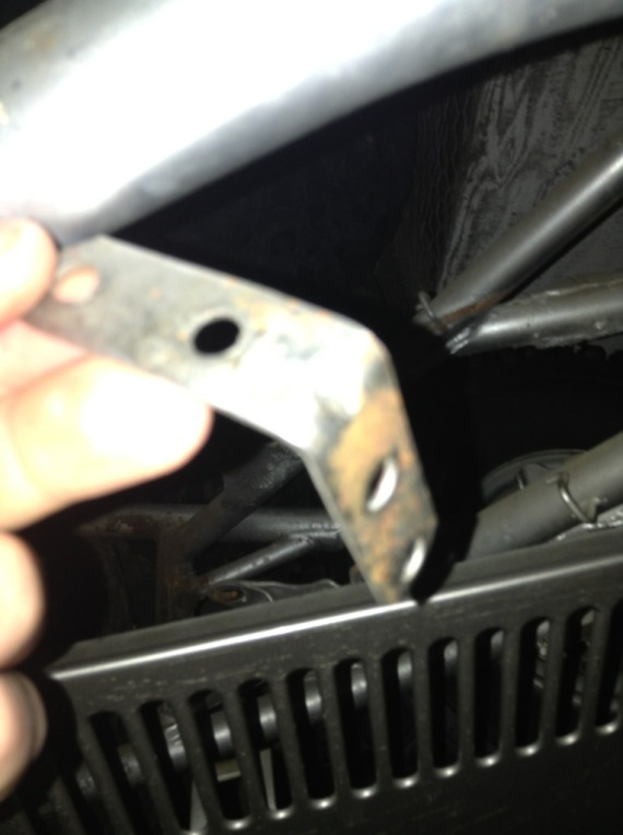

I have the CFM air scoops and yes they need to be mounted to the stock from fender brackets and bolt the long brackets to the rear of the upper a arms
Here is where the bracket goes to the back of the upper a-arm nut/bolt

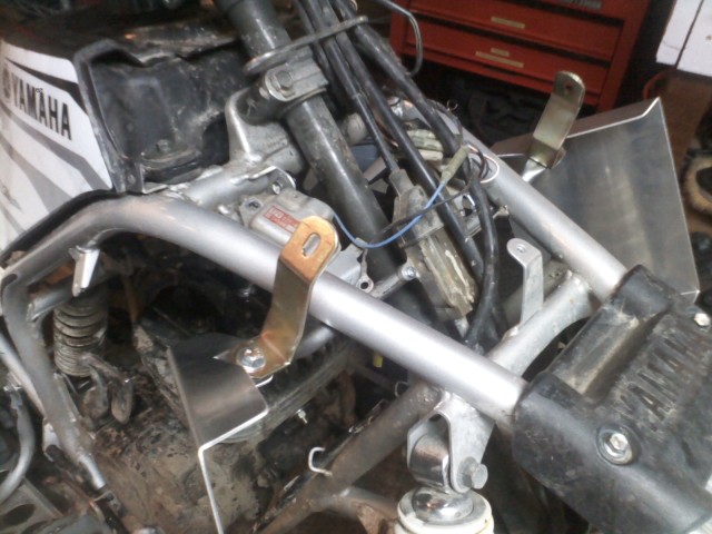

And this is where it mounts to the upper fender bracket
Sorry if the pics are to dark, you may have to bend by hand once everything is tight to fit, especially for the upper fender mount.

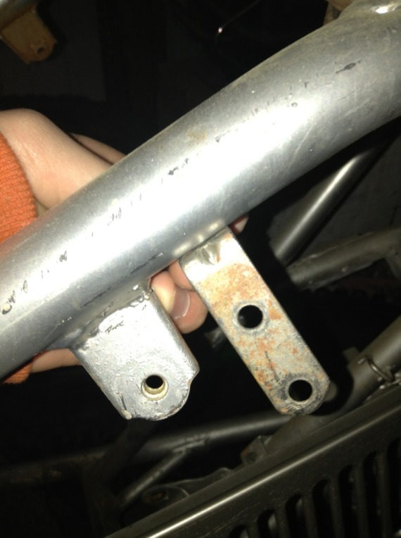

Cool, thanks for the help guys. I got lucky and found a nice front bracket for $16 on ebay that has been carefully cut off of the frame. I will fab something up so I can add and remove shrouds and fenders without a sawzall or welder as soon as I get it. I'll post pics here when I'm done. 89: How is Coos bay? I usually ride Florence or Winchester bay, I tried Sand Lake once but it was a little too flat for my liking.

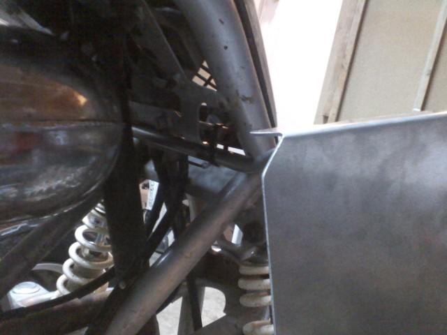

I got my bracket in the mail today. I ground the tabs off of it and mocked everything up, now I just have to decide whether to hose clamp the bracket for easy removal, weld it and make it permanent, or fab something custom to put the scoops exactly where I want them. I really want to get a Maier race cut hood but it's going to be a while before I want to drop $160 on it.

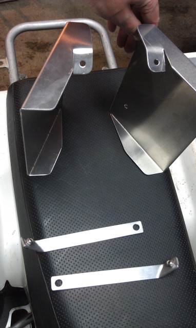

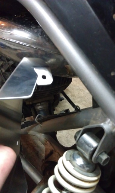

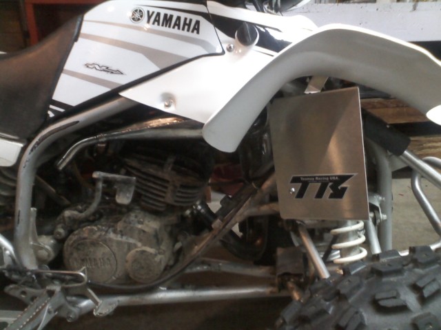

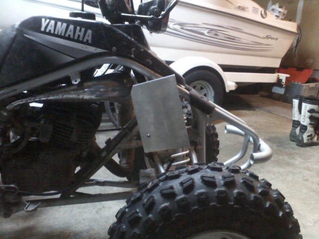

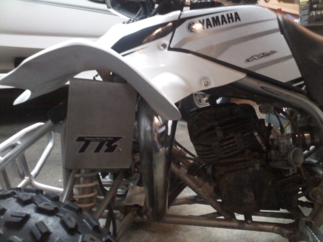

I already posted this in another thread but here's some pics because this is the the first place I came for help. I ended up bolting that bracket on with stainless bolts and nylocs in case I ever decide to take it off, here is how it turned out:
