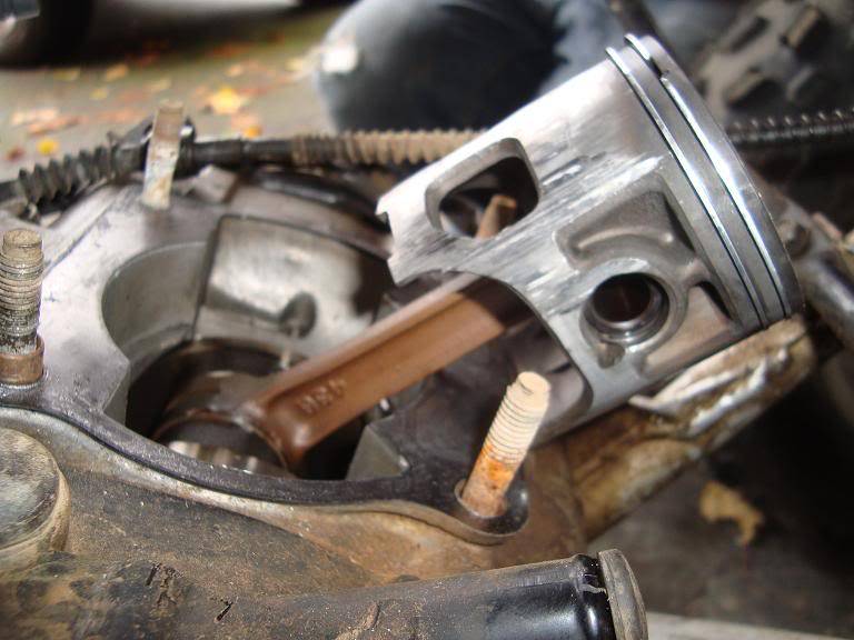

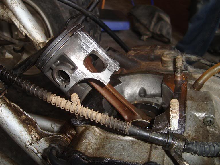

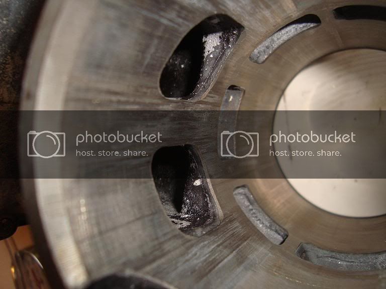

Tore down the blaster today. It lookes like the piston is pretty knarrned up. It has alot of pretty deep grooves all 360 degrees around it. This also caused the cylinder to have the same effect. Does this sound like a legit reason for it losing compression? Seams like it to me. I posted some pics, if its hard to see, the cylinder and piston both have deep grooves in them. Probably no more that 1/32 of an inch. But still reason enough for the low PSI right? Piston rings (as expected) were in the same condition with grooves that matched the piston itself. Looking around for another cylinder (in good shape) or should I just get it Honed?
nahh the huge gashes in the cylinder and piston dont have anything to do with the 50 psi....wtf man serioiusly ?? ...what caused that anyway ?
Sounds like a fair statement. I only warm it up for a few mins everytime. kinda just started it up till it would idle right, then go. I got a guy who can sell me a cylinder in good condition. But its from a 91 blaster. Are the specs still the same? Will it fit correctly with a stock diameter piston? I ride an '01
all blaster motors are the same except for after 03 they had an extra wire. so your perfectly fine switching out the cylinder from a previous year. is the 91 cylinder bored over?
