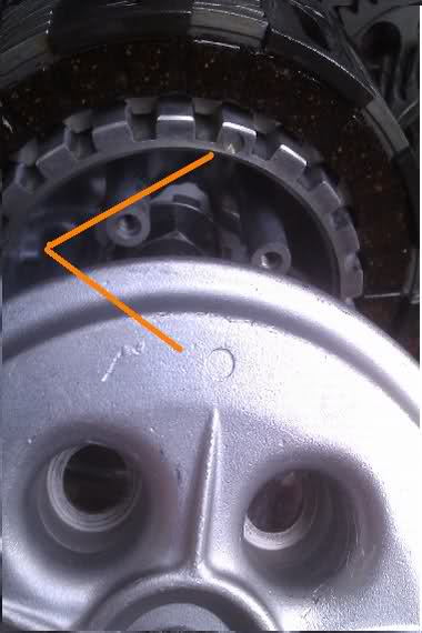

Does mine looked lined up, or can it still not be lined up correctly? This is with me pressing it until it stops...

looks off to me, should be aligned better.............

you aligned the 2 dots on pressure plate and inner hub ?
