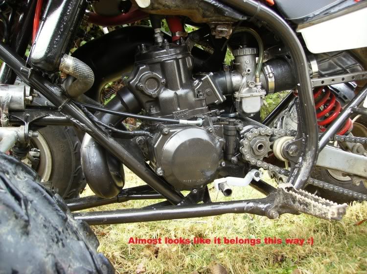

I went a very similar route with my KTM Blaster:
Make sure to level the carb. This above worked well, this below did not.
See! It broke the chain!

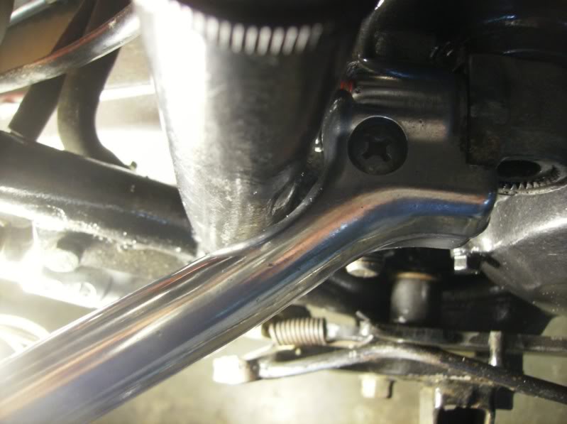

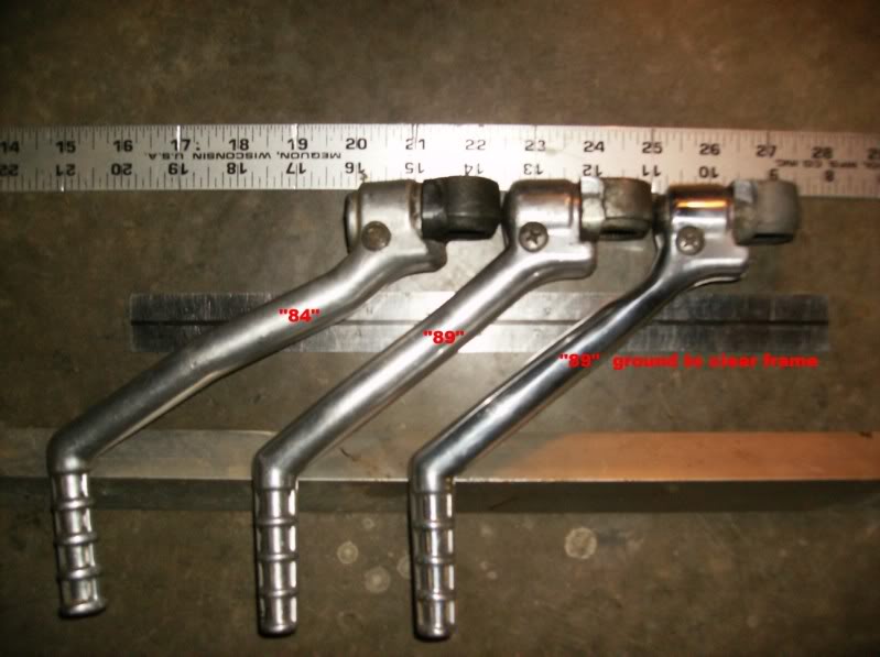

I had to flatten a frame tube to make room for my kicker:
I just ground the kicker to clear .. still plenty strong (below)
