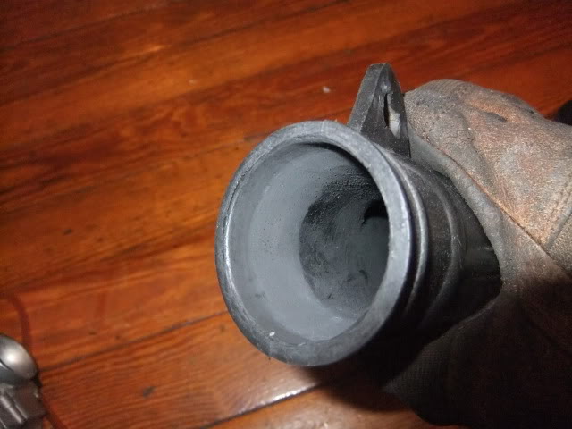

thats what i figured.. i ordered all the jets u suggested so it should be here the day after tmrw. today i started to get it all ready and stretched the airbox boot to get it over the carb. i honed the insides out too bc i wasnt too happy about the humps so dremel'd it. while im at it im gonna pull the rear plastic out as far as i can since i got it out. oh BTW i have another question. the needle where the main jet goes into.. theres no #s on it and at 1st i thought it was the pilot but idk what it is.. correct me if im wrong but the pilot is kinda in the cut where u gotta take he bowl off to get to it right? unline the main i could just screw the bottom off.

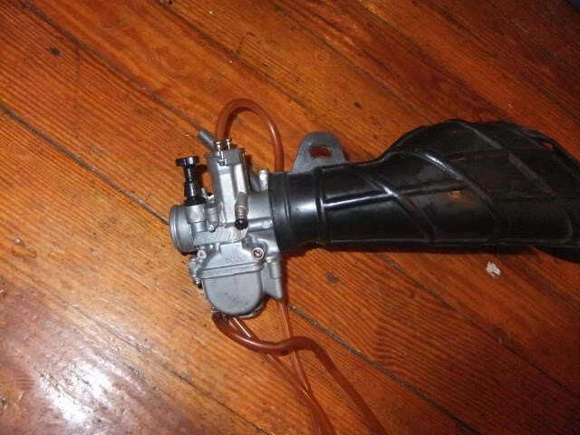

BTW, i STILL wasnt satisfied with the boot over the carb bc it left like a hump. so heat gun the bastard again and jammed a wet glass beer bottle in it as far as i can to open it up and let it sit over night, now its perfect actually a little wider but perfect. now all i need is the damn jets to come in im dying to feel the results. oh and i have VF2 so the carb wouldnt even hit the clutch arm I:I clears perfect. no spacers necessary or tilting
another NOoob question.. the AF screw.. theres a spring on it. i know im supposed have it between 1 and 2.5 turns out. but when i screw it in all the way the spring coils way too much like its not supposed to be screwed too tightly and starts to overlap. or am I on the wrong screw?? the screw is plastic btw idk if thats norm. heres the pic. where i have the screw driver pointed at. btw i havent started to dial it in yet im just preparing for it. jets will be in thurs.
