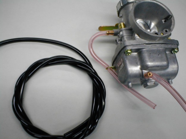

I was cleaning my carburetor when I realized there were two holes that just let air pass right into the carburetor!! What are these for?? There on both sides!

There should be small pieces of hose coming out of each side of the carb on those nipples.
they are overflow tubes. used when the carb and/or the quad is on its side. rather than filling the carb with gas it drains the bowl
about 4" of hose on each side is good. normally there is little hose holders that are fitted under the bowl screws
They are vent tubes which provide a means for venting to the atmosphere any fuel vapors or pressure that might accumulate or build up inside the float bowl chamber due to high temperatures.
If these vapor pressures are not disposed of, then the pressure inside the bowl pushing down on top of the level of the fuel will be greater than the calibration of the carburetor intended it to be. This will result in a rich mixture due to excessive fuel being forced through the jets into the carburetor and on into the intake manifold.
