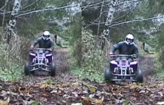

Wuz out playin around on the trails with the yfz shocks on the guest Blaster and took a break for a short vid. Don't really show much but it was fun makin it. Really happy with the shocks. Can't wait to get'em on the YZ Blaster and get to play with the adjustments.
YZ Otis ... always stylin with the latest in riding gear ... LOL ... burp!
I think it handled pretty well!
Now if you would of lost it and rolled then you'd be right in line with me, everytime I ride I hurt something
I can't afford to crash! ... following the kids up that little hill on my Scrambler is like riding a pogo stick ... never sure which direction you'll be going when ya land ... LOL
Slowed the slow-motion down some more now that I figured out how to do it. 2-strokes sound really spooky at 1/4 speed ... LOL
A couple cuts from the vid ... the shocks are working. It stayed on the ground really well for what it is.
