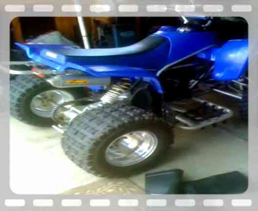

ok lets talk my bike a bit. to let you all know i have been lurking and have been reading alllll kinds of threads let me post a vid of my bike and you all tell me what you think. i need a new pipe just not sure which one to get with my set up :( I really like the toomys

damn man that blasty is clean!
Thanks buddy!! I got it for 1250!!! sooo... will I need to buy jets as well or does that come with the 34 mm carB? does any one have a pic of the idle screw I want to turn it up a bit so it will idle right and have that clank sound lolll
