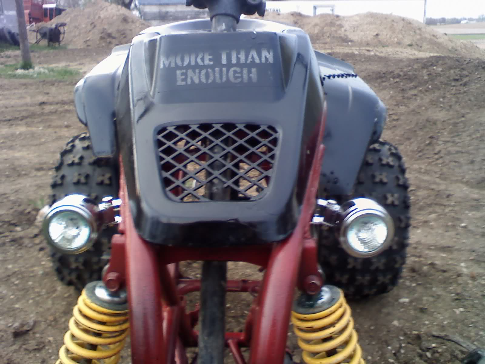

Wally Lights Install *tons of pics*
mine are solid mounted to the top shock mounts
sweet thanks. how about the bulbs? do you have to replace them a lot?
they can last up to 4,000 hours...water can shorten their life span cuz they get really hot...its funny tho..somehow the one of my glass lens chipped already and it has a good size hole now, and water gets in there, but it still works.

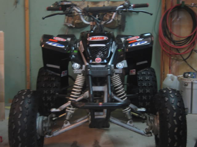

i dont have any pics to share but i did this mod and mounted the lights on the sides of the 'yamaha' plastic below the hood. i would have to say these lights are 25-50% brighter than stock. 50% may be a little steap, but 25% or more for sure. not to mention it looks way better and is a cheap simple mod. great post man! rep to ya.
note to those that are gonna do this mod, unless you mount the lights on your handle bars the light wont turn with your wheels, so you might wanna keep your stock light if you ride trails in the dark.

The shock tower mounting seems to be my preference, spending alot time in the woods it may keep the bug impacts a tad lower :D

i mounted mine to my gussets that i fabed up and put rubber washers between the lights and gussets to save them from some vibration

FYI and anyone elses pre 03 blasters the green wire is the low beam , yellow is high beam , i ran the wiring for them last night . 03 and up might be the same but i haven't dug into one , so i can't say for sure
nice i gotta check walmart! im gonna mount the on the lil square threaded bracket in front of the f. top shock mount since i got a race hood..
