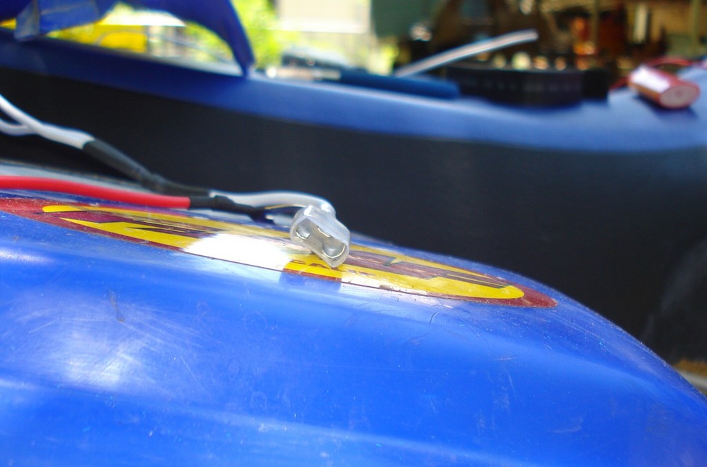

Well the wires that go to the stock light is where you hook them up. One is low, one is high the other is common. Pick the low or high and a common, or put low and high together so no matter where you flip the switch its on. Not real hard... Just look at the wiring now.
yes i have the yellow and green factory wires both together in this plug. this plug comes with the light kit and i spliced the positive from the lights to the plug.
