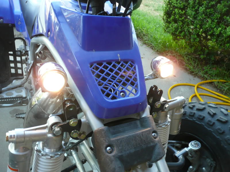

Here's how I have mine mounted both with fenders, and without.
u stole my mounting idea!!!!!!!

okay guys first of all for anyone who mounted them on the fender mounts did they just mount right up with the stock bolts? also are these brighter than stock and how well does it work having just one turn on for low???
if you mount them under the plastic then all you need is a washer on top of the plastic and the bolts that came with the lights. i mounted them both up with the 50w bulbs for fun and there is deffenatly not enough watts from the stator, but just one is very bright, brighter then stock and more of a white color. i dont think one 20w bulb would be that bright but that is just me. i have mine wired up different so that they would come on at the same time.
