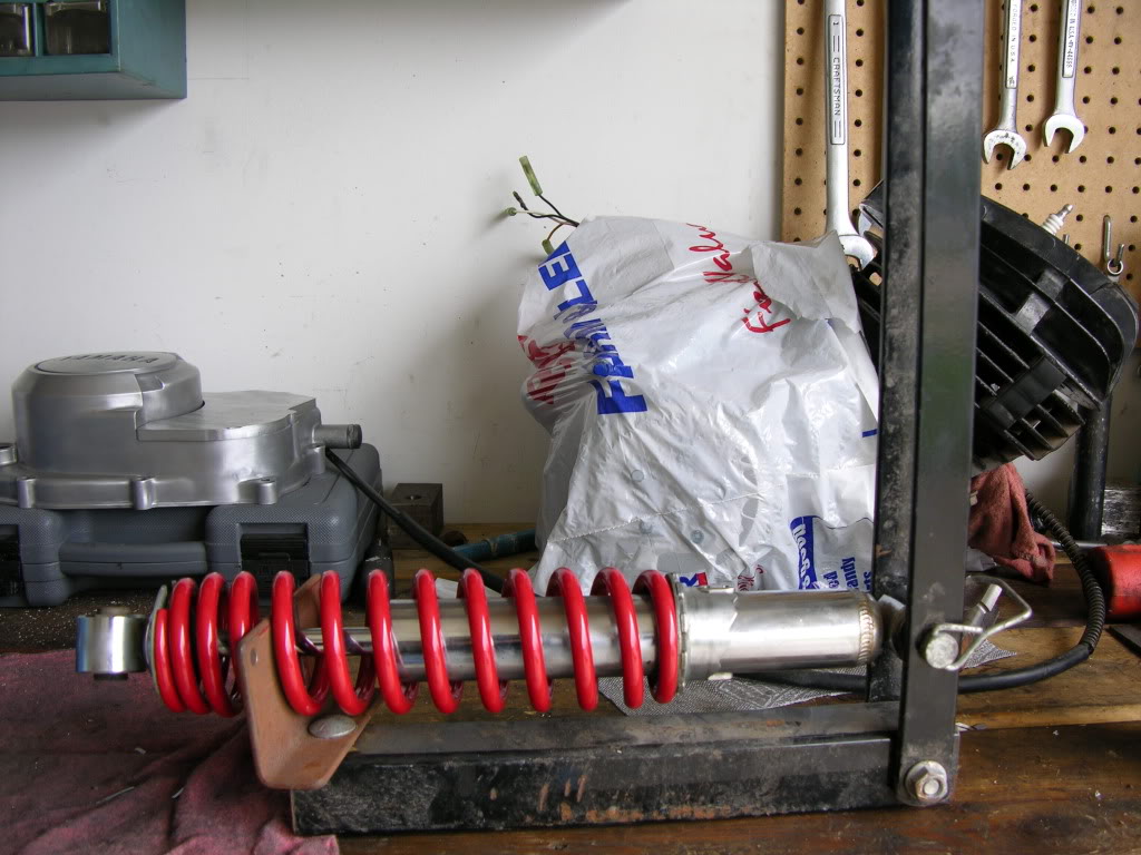

Take the springs off and powder coat them, then you can clean the shock body easy to do with some spring compressors or this-
