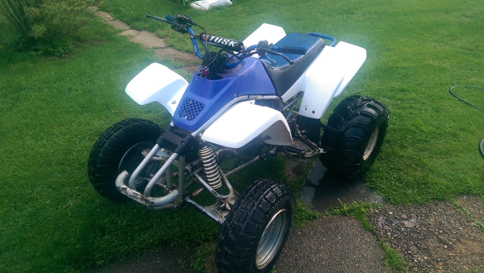

Also, I was gonna buy new plastics cause I thought mine were shot from being stained...scrubbed them down with some SOS pads... Voila!! Saved a few hundred :)
Looking better than the day I bought her.
