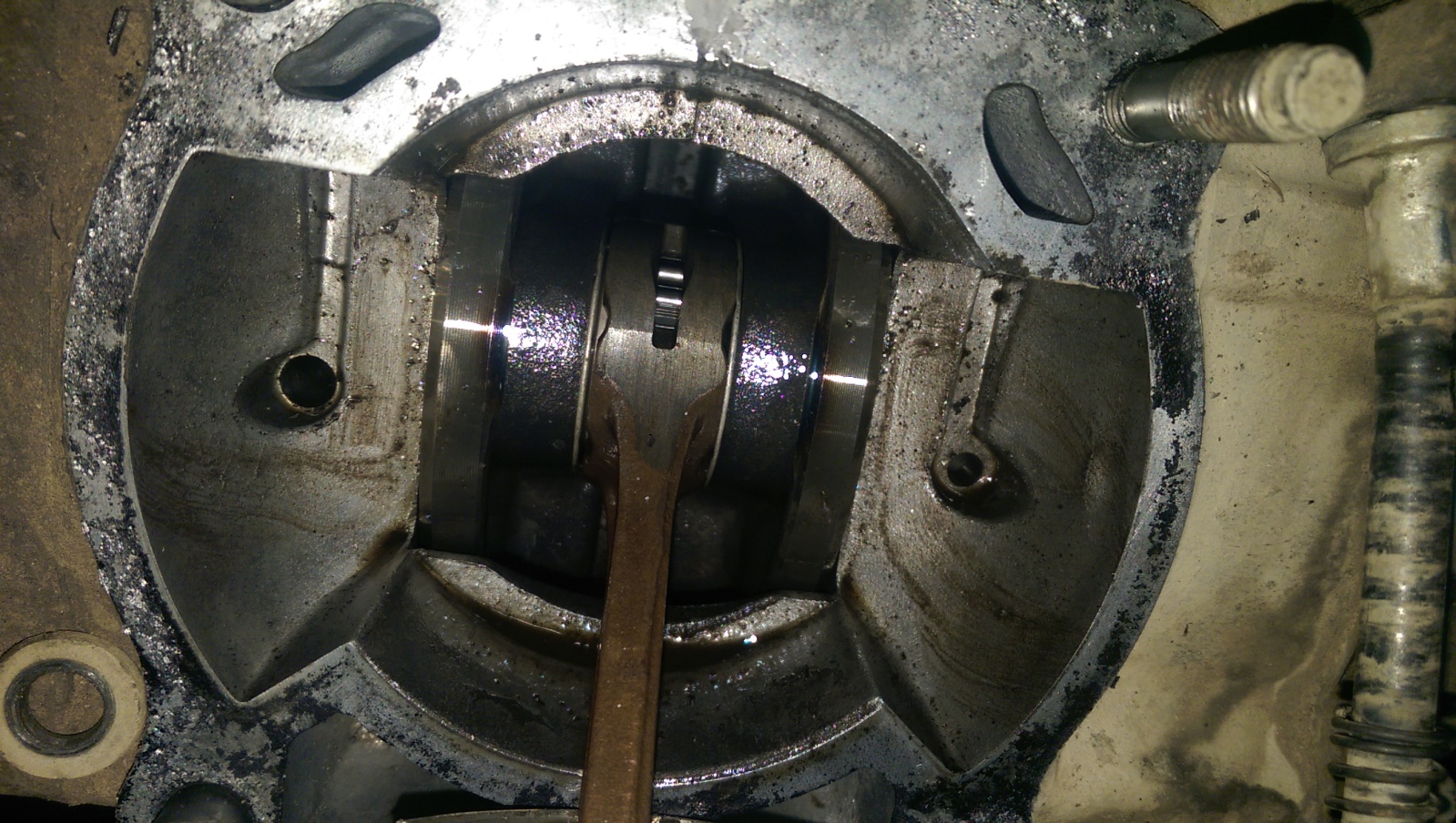

Sooo, I think I found a huge mistake I made on my part. I forgot to clean the air filter before riding it, and I'm thinking dirt got into the motor and caused the problems I have now. Plus that leaky head gasket didn't help. Assuming from the pics that there was a small leak at the head. Anyway, here's a pic of the bottom... Hopefully I can just flush it out to clean the bottom out without risking more dirt going into the motor. Needless to say, a dirty air filter is a ridiculous reason to blow a motor...
This was sparkling clean before running.
I feel that you are blaming yourself needlessly about the dirty air filter, a dirty filter usually keep out more dust than a clean one, unless you put in on inside out.
The particles of debris look to me like metal fragments.
I hate to burst your bubble DeJay, but I fear that you will have to split the cases to remove the crap that is in there.
You may well find that the bearings contain some debris which cannot be removed by simple flushing.
I draw your attention to the pic of your piston, there are particles of Aluminium still hanging from the skirt of the piston, others which may have dropped into the crankcase.
Do not take a chance that you can remove them by flushing, one minute piece of metal lurking in a bearing can cause catastrophic results.

On looking again at the pic of the crank pin bearing, it does not look quite normal.
Check it out, below the second roller there are 3 horizontal lines showing, what do they seem to be?
I am not sure, without being able to rotate the bearing I am unable to comment more.
It might just be reflections, but check to see if all the rollers are equidistant with no marks on them, and no crinkle marks on the cage.
