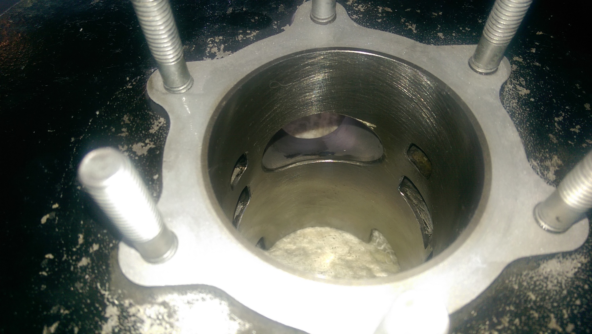

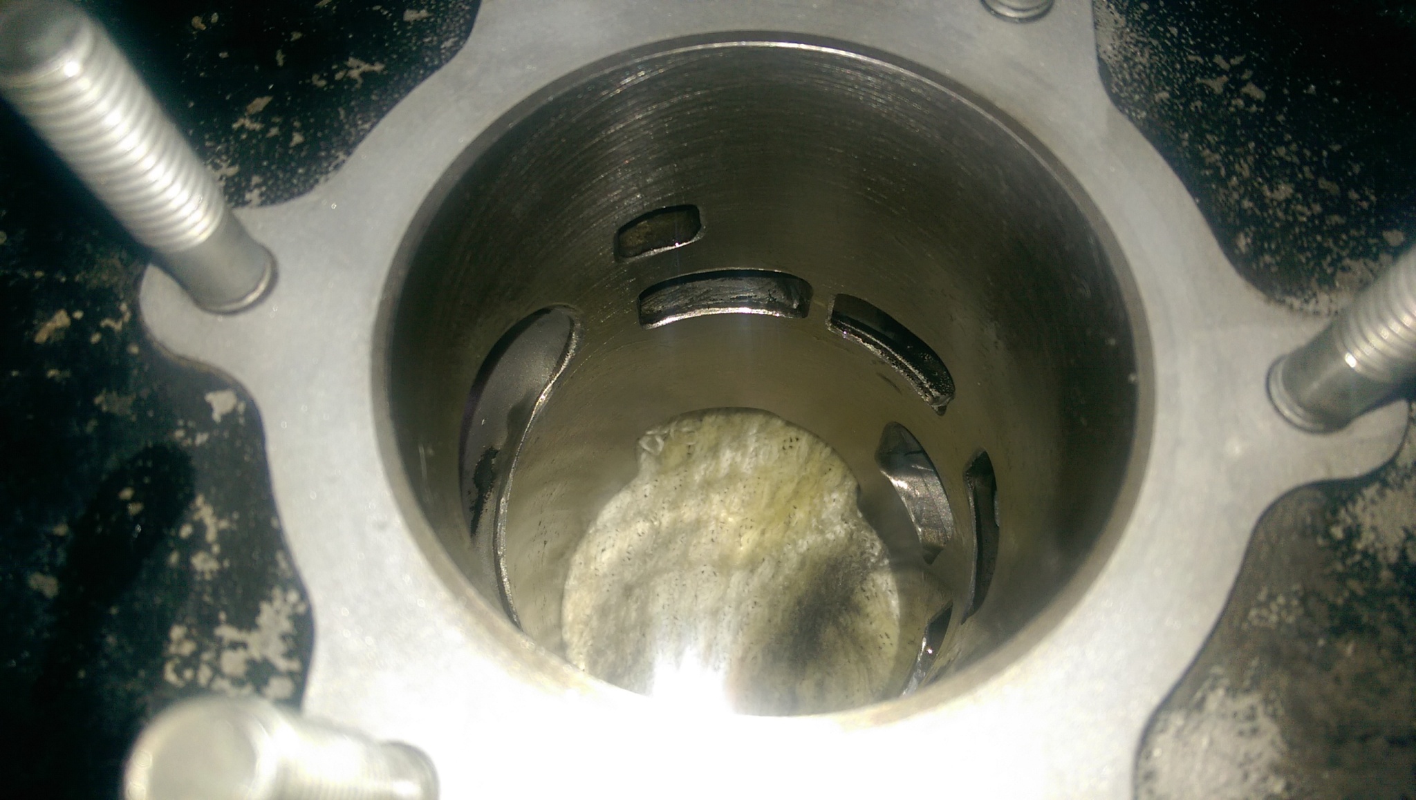

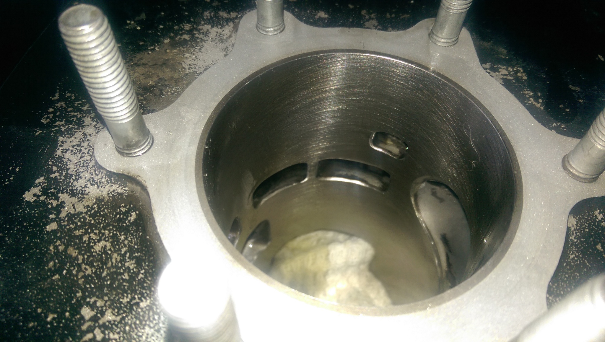

Okay, goign to get the cylinder back from the machine shop in a little. You guys will have to let me know what you think of this shop's work. I've heard from many reliable sources (yamaha shops and friends) that this guy does the best work around....
Youll be happy, make sure before you put it together that you was the cylinder out with dawn dish soap an hot water to remove any of the debris from honing it, im sure they will tell you the same thing, an oil it up immediately after washing it, cause the dawn takes every stitch of oil out of the metal an it will rust very quickly

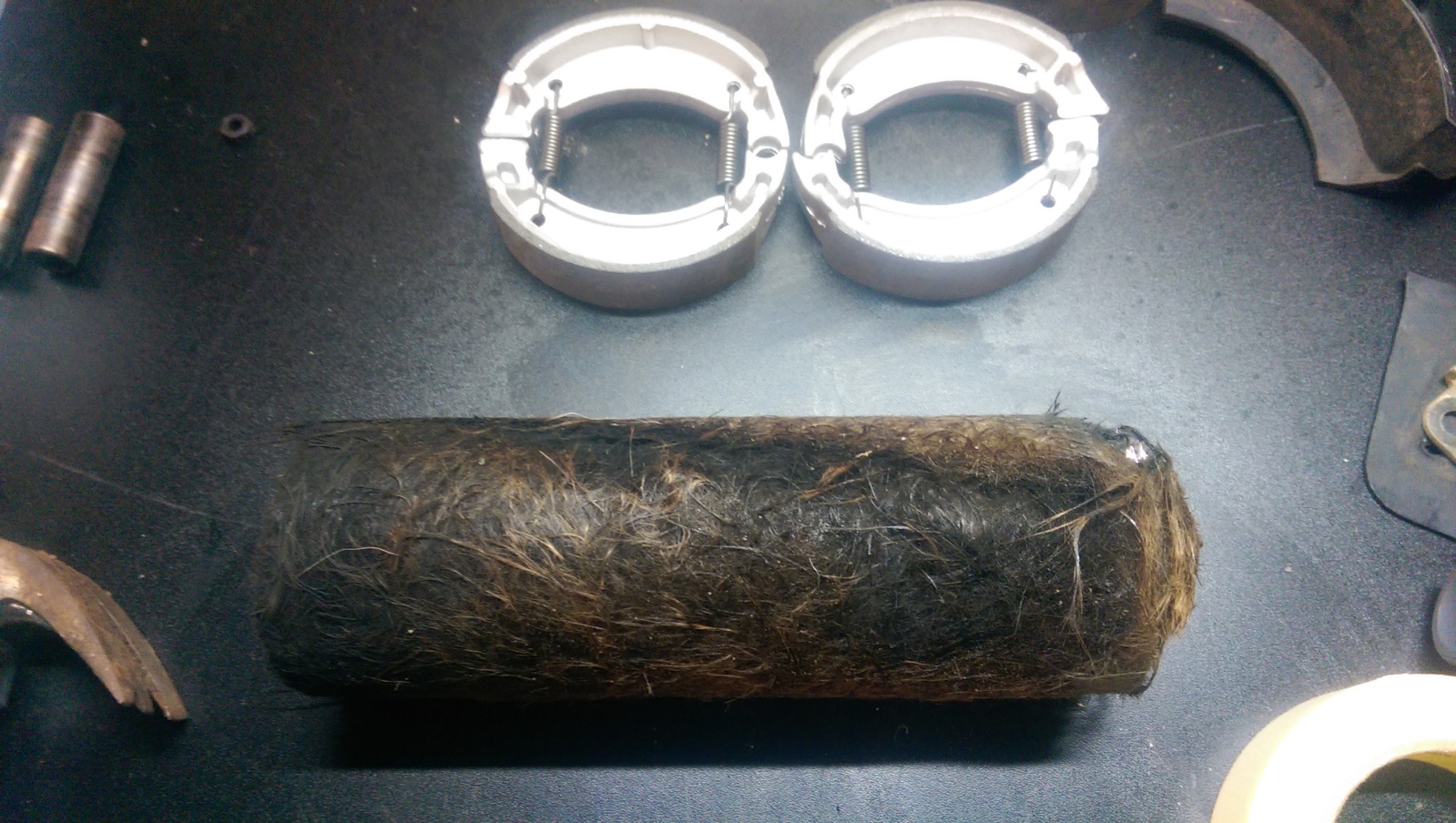

Yes, the hair has been removed lol

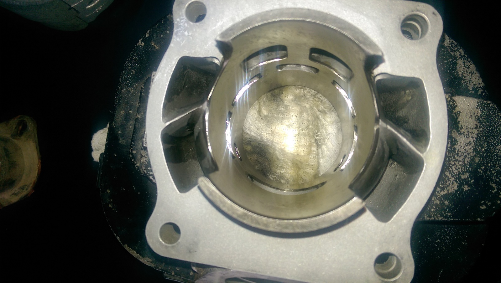

Was that cylinder bored, do I see a blemish below the transfer port.
Can you get a pic of the hone marks in the lower of the cylinder.
Have the transfers been chamfered?
Reactions: motoman159
Everything was chamfered, and the "blemish" that you're referring to is just oil that I didn't wipe away after I cleaned the cylinder and oiled it...
He did notify me that there was a small blemish underneath one of the ports on the bottom of the cylinder but that it was small and he wasn't concerned about it.
I apologise for being picky, but I am fastidious when it comes to boring, honing and chamfering.
There are so many builders out there that take no pride in their work.
Is the crosshatch hone pattern uniform throughout the whole bore, it looked a little light on in the pics of the bottom of the jug.
I just checked, they are uniform... It just didn't show well on the picture. Must have been from the angle. I'm actually very impressed with how good this cylinder looks. I'd have to say he knows what he's doing...
Ive personally used the shop dejay used many many times, for alot of motorcycle/ATV work, an various other work for cars an diesel engines, there work is the best around, especially with the bike stuff, ive never have seen any issues with anything they have done,
Reactions: DeJay1206
