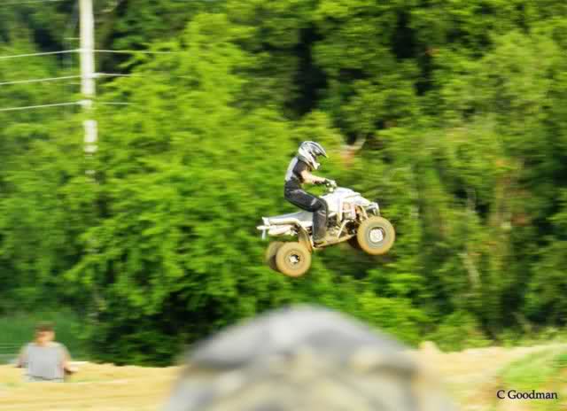

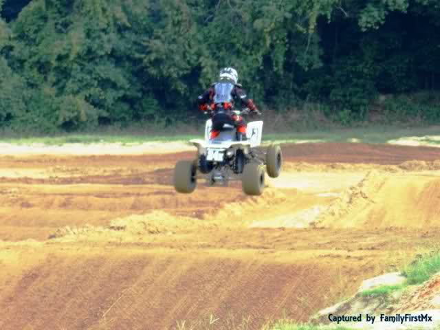

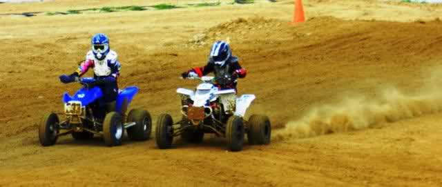

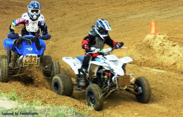

here is an air pic from the past weekend. Last 3 pics from the week before and making a pass on the blue airsal blaster.
