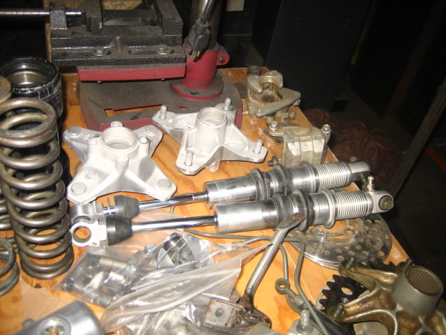

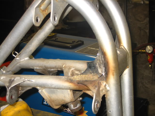

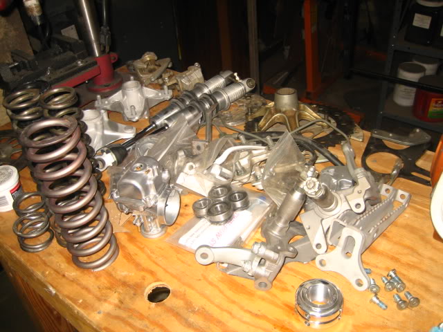

Ok here is my monthly update....got most of my parts collected for the suspension besides the lt a arms which will be ordered next week. The gussets will have the welds completely ground smooth and rounded to the frame, as well as any other custom welding i will be doing. Here is my parts collection

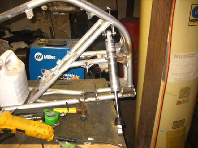

Measuring out at around 12" of travel with the trx 250r shock
Front shock mocked up...she's a beast

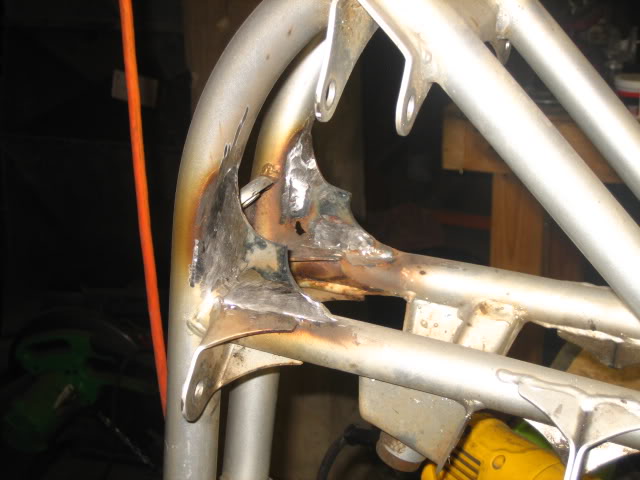

Gussets at the front so far
I wanna get everything bolted on first, cycle the suspension and make sure everything is lined up well, then disassemble and smooth out all the grinding marks and get ready for powder

Yeh I send props out to Phragle for the suspension setup...without his help this wouldn't have came about! He told me the 250r fronts are really plush...the triple rates...and are hard to bottom out.
I emailed the guys at asr and they said they could send me a bare set...but call them first so when i purchase, they will be bare with all the hardware in bags. going with all heims too for a little better articulation of the suspension
looking great man, that's a pretty impressive collection of parts

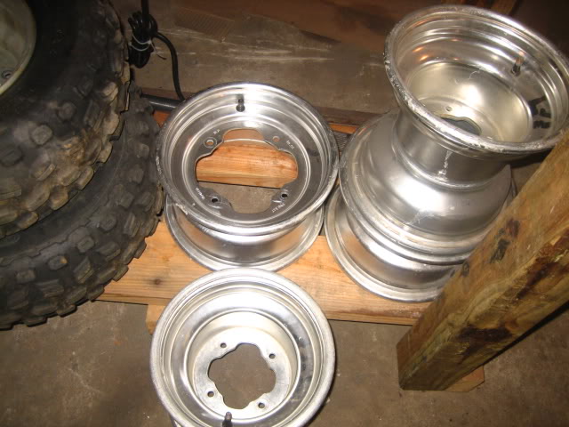

Well most of it was stripping and blasting...either glass bead or aluminum oxide grit for the darker colors of powder I'm gonna put on it. Glass brings it down to the metal look where it's much easier to polish. Forgot I got my polished axle under the table too...and these

he means put them on and cycle the suspension and see if you can get more travel by moving the shock mount
Gotcha...i read it a couple times and was like wtf is phragle drinking tonight? lol
I believe I'll leave that shock mount alone...ah damn here we go with more custom fab ideas...dammit phragle i'm never gonna be done! haha
