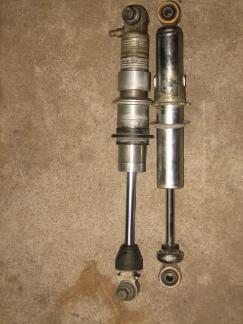

Just doing some comparing on the stock shock and the works Banshee front shocks i have....check out the shock body length and overall length.
Works on the left....stock on the right
So what length front shock would constitute a long travel shock? I am thinking on going long travel for the front as well as the rear...just had a new MX track open up about 20 miles away that is a $10 all day riding on a track created by a guy who bought land and wanted to do something for the community because the lack of places to ride around here. Great place to play or just tune in the suspension, and when I get this completed, i wanna hit it and see what this Blaster has in it....

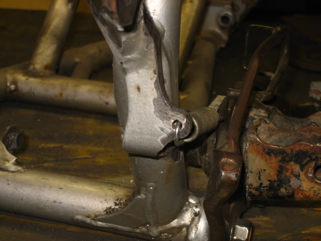

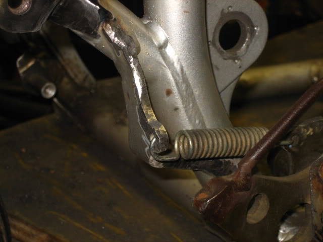

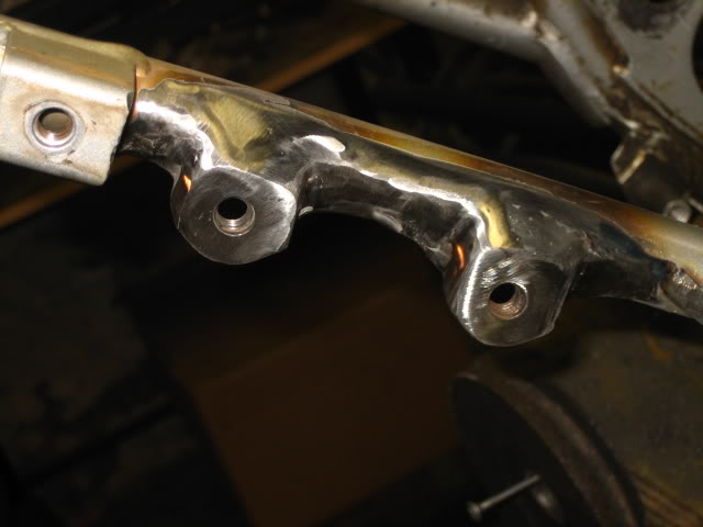

After consideration of locating the rear hydro brakes...I came up with this. Since i can't run foot guards...I cut the tabs off that secure it to the frame, and used them to mount it up.
First i grinded down where the brake cable hooked up at, and just made it to where the spring would connect

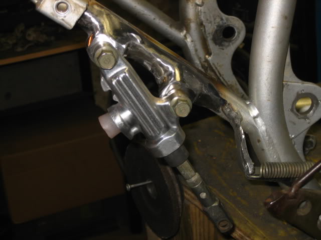

Then i cut off the tabs for the foot guards from the frame, and mocked up where it would sit. Then i welded the first tab, then bolted up the hydro cylinder, and bolted on the second tab, and moved the cylinder up to where it would meet the frame, and welded. Here is the final tabs welded
Here is the hydro cylinder bolted up

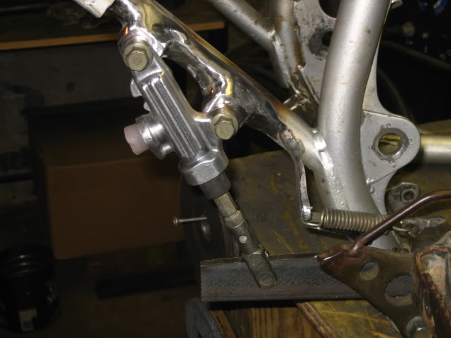

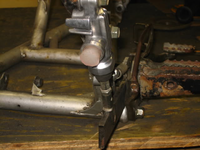

Here is the steel i gotta fab up next that engages the cylinder. I got it cut at the front to go around the brake pedal and ready for welding, and mocked it up to the cylinder for alignment
After this, frame gussets will be made and welded, and then its ready to strip and get ready to powder coat it!

I'm wanting ASR front long travel a arms...and i contacted ASR and asked them the recommended shock size for long travel and they said 16 1/4" from eye to eye for their long travel a arms....so I may be working with the works shocks with them for now, then moving up to a bigger shock and sell the works shocks. right now they are about 15 1/2" from eye to eye....so a little too small for them
