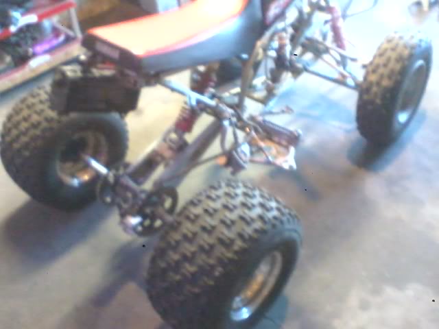

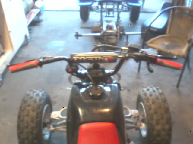

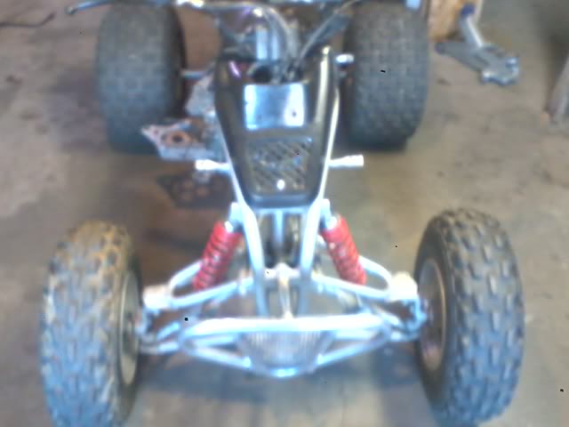

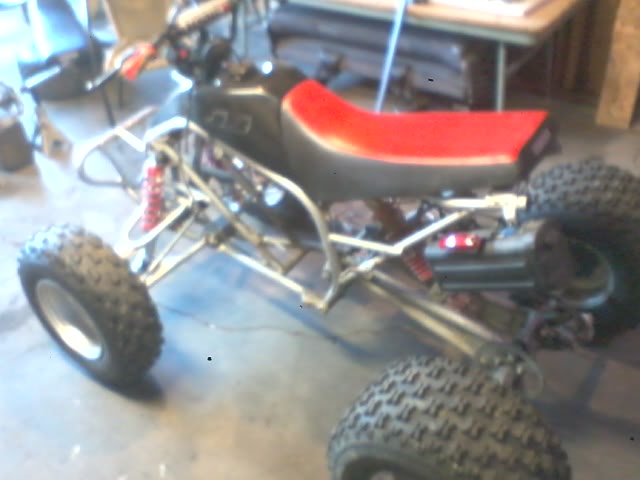

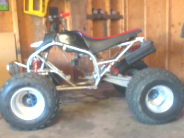

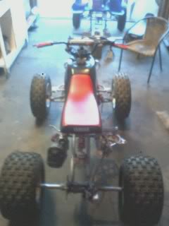

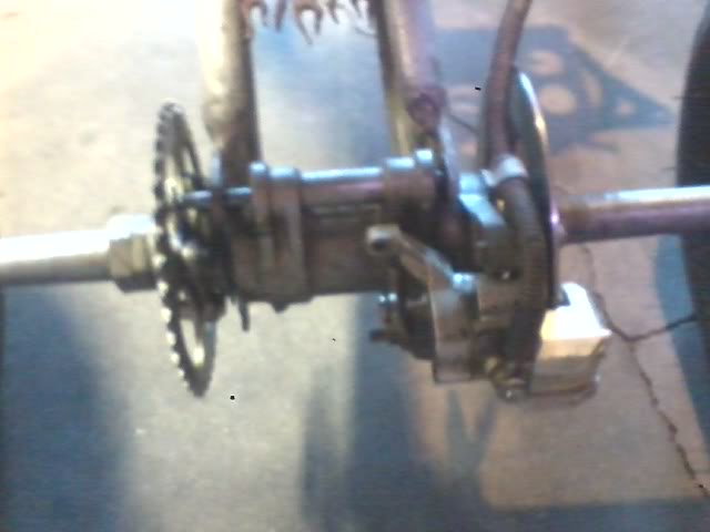

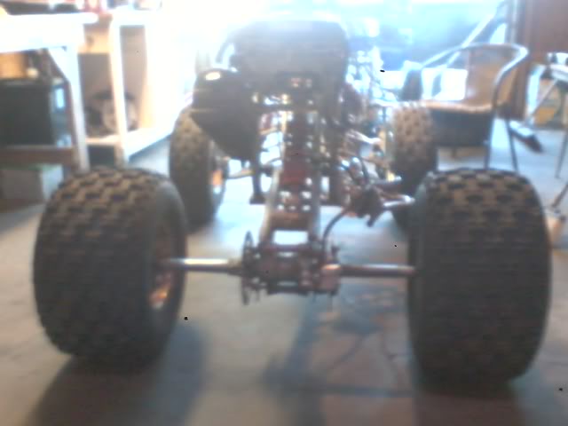

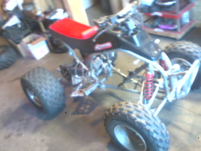

heres the latest pics of everything on. front and rear hubs-wheels/tires, axle, carrier, rear hydro brake, hydro hand brake lever. everything is off a 1990 suzuki lt250s quadsport. the only thing that has to be modified is the bottom hole of the swingarm for the carrier.(the one where the chain adj. is at)
if you have one sitting around that doesnt run or know where to get the parts for cheap, its well worth the swap. it makes a blaster 4 inchs wider in the front and over a foot wider in back.
i just wanted to take some quick pics on my phone, the carrier isnt lined up,(no spacers in)and the bolt is only half way in the top mount hole.
