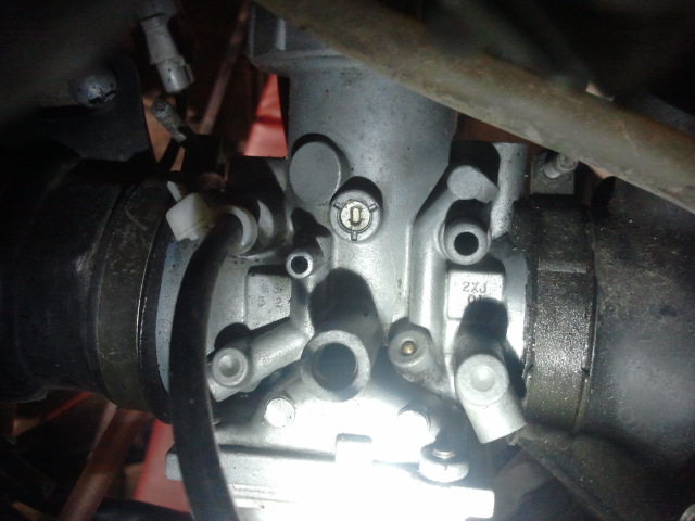

In my confusion I got the wrong side of the carb mixed up, forgive me.
That is the spigot pin that locates the slide if I am not mistaken.
is this what your assuming is the idle adjustment? Center of picture....
Yes thats what i was talking about! Cool so you say even though TORS is unplugged the brick on top of carb can still be adjusted? I only unplugged TORS because i wasn't getting any spark. Never actually deleted it completely. Is there a way to reset the TORS? Or reactivate?
No need to "reset/reactivate" the TORs. Best left off. You can still change the idle with the screw that is on top of the TORs system.
