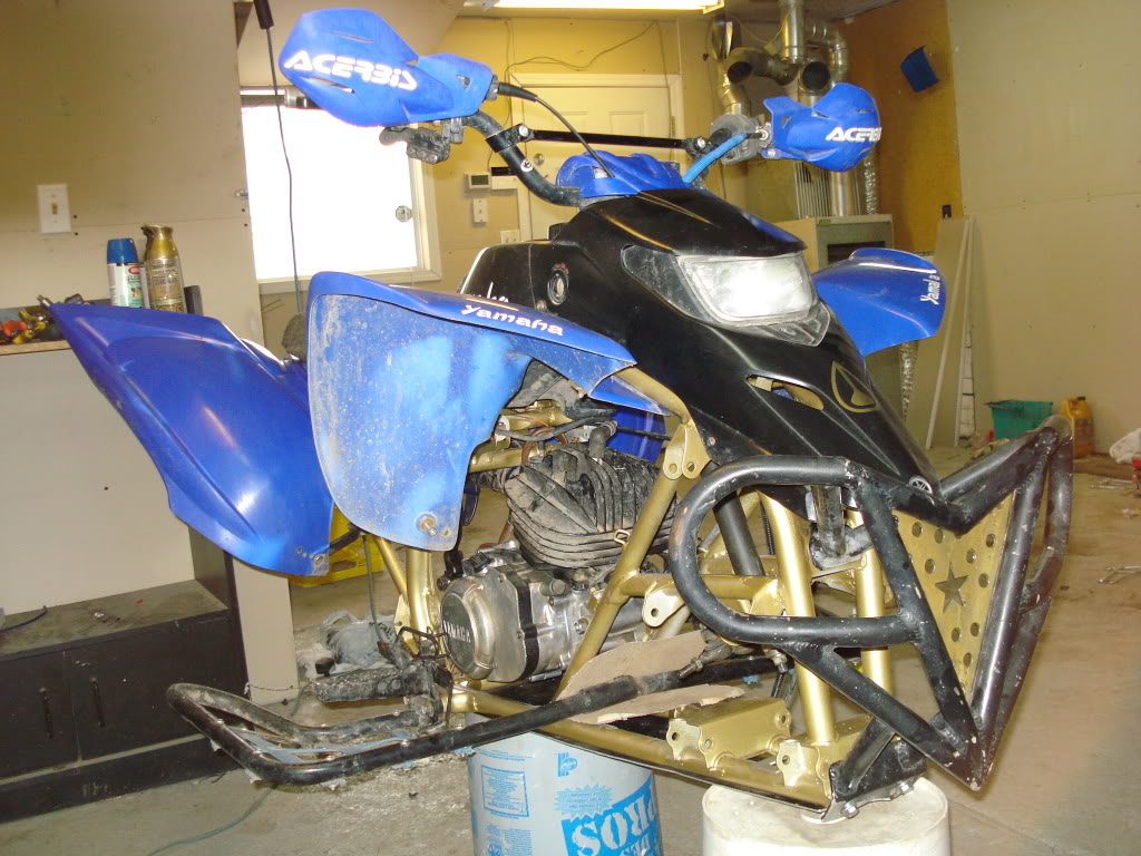

hah Well i sent my A arms off to stroked tater to be extended , i also got a +3.5 swinger from him so im waiting for those parts to show up.
i also got a Fat bastard pipe and 08 KFX 450 shocks on the way.
so until then this is about as far as i can get, i might rebuild the carrier for something to do.
OH YA FORGOT TO SAY DAY 5 OF NO SMOKING!!!
thats why i began this haha to keep me busy
Yeah nice transition from the stock Blaster. Haha I liked the sign idea for the skids before. Did you have to customize the shock mounts for the Banshee shocks?

Alright guys this is the last update for about a week, i gotta get off here all i wanted to do is paint the frame and somehow iv spent 750 bux on the blaster this week.
Just gotta wait on parts now
parts list-
Extended Swinger
Extended A-Arms
KFX 450 shocks
Banshee axle
Swinger bolt
all Wheel bearings
New chain roller set
Vitos fat Bastard pipe setup
and a few more little odds nd ends
