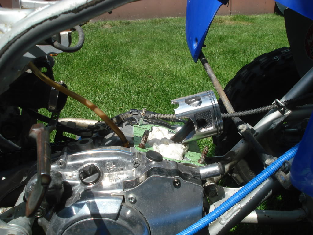

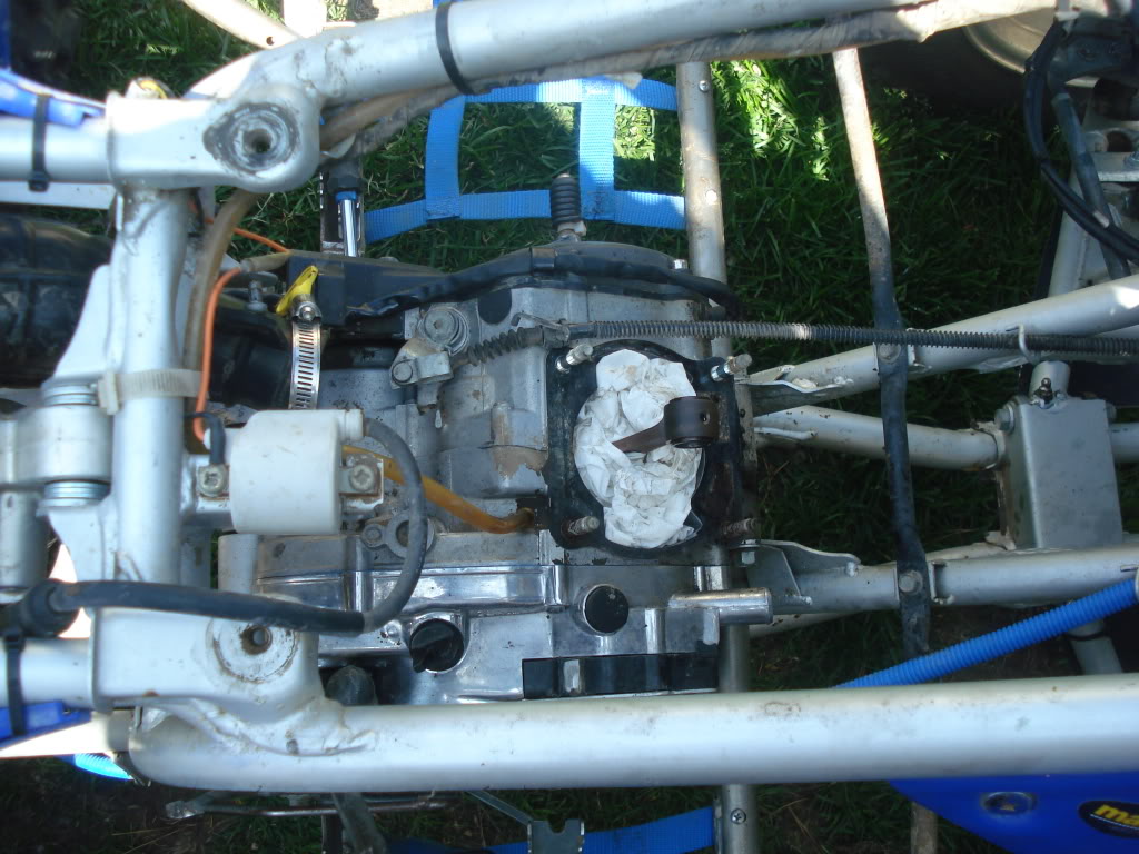

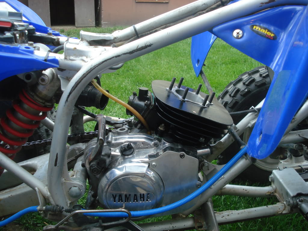

Well the 240 install went very well, took about 2 hrs, but didnt start it yet as im in need of a reed spacer! my clutch arm hits the big ass carb.
Also need to fab something up with the intake.
Tested the compression 3 kicks (as i didnt want to pour more oil in there) 170 psi
The PWK was a biotch to put into the stock boot i had to use some grease and precision trimming.
One more thing.

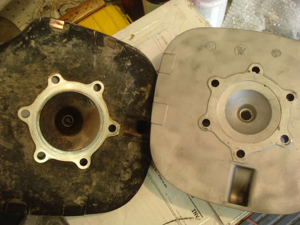

if your attempting a top end rebuild keep in mind that you need an adapter to torque the bolts to the right specs!! i found this out the hard way, son of a biotch

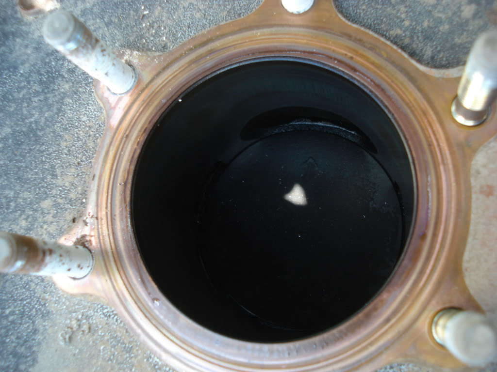

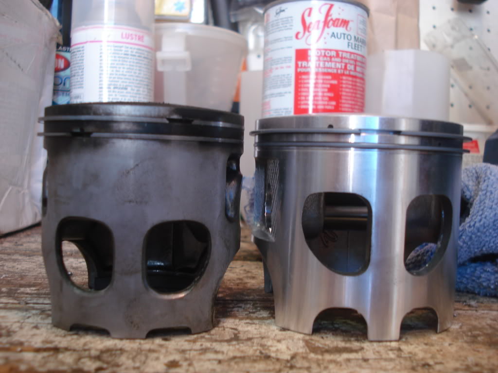

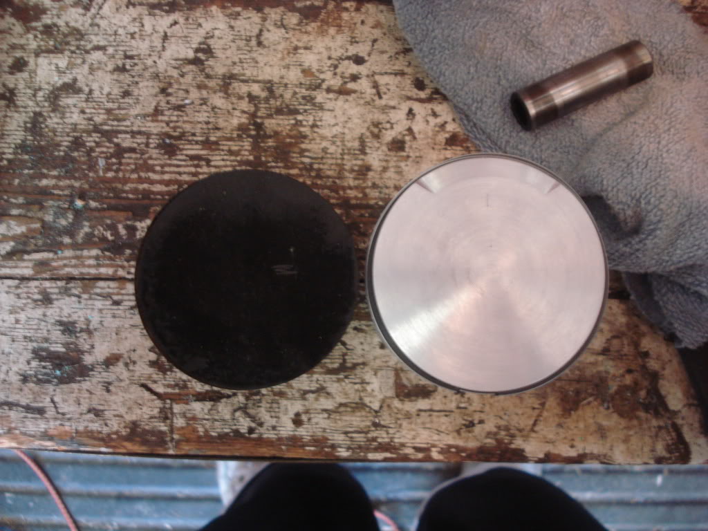

anyways the stock cylinder was in really good shape.
but heres some pics

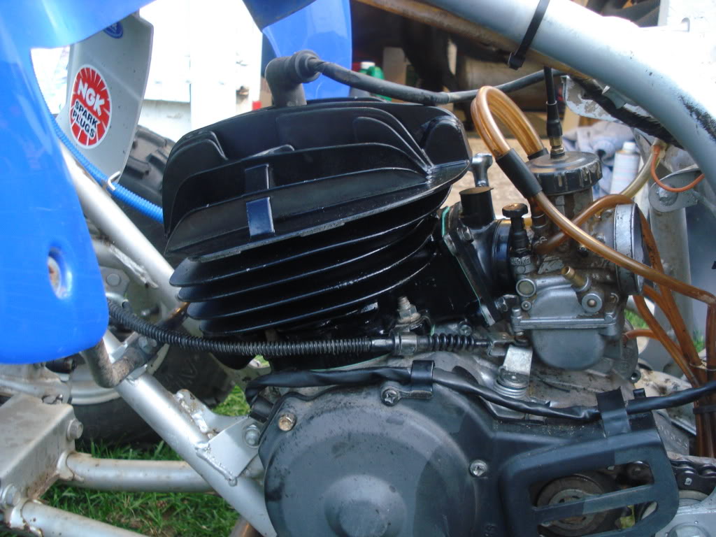

Can someone please tell me what all these tubes are coming off this pwk im thinking it was off a banshee in conjunction with 2 carbs?
I will be by in a hour to race. No just kidding nice job, i can not believe how big that other piston is, i would buy me a big bore kit but i just had a little one.

hey try to turn your carb a little away from the clutch arm. that is what i did with my 34mm and it fit just fine with no spacer.
Really?
im gonna give this a try, thanks for the tip , i may not need to buy a spacer now or i can atleast run it.

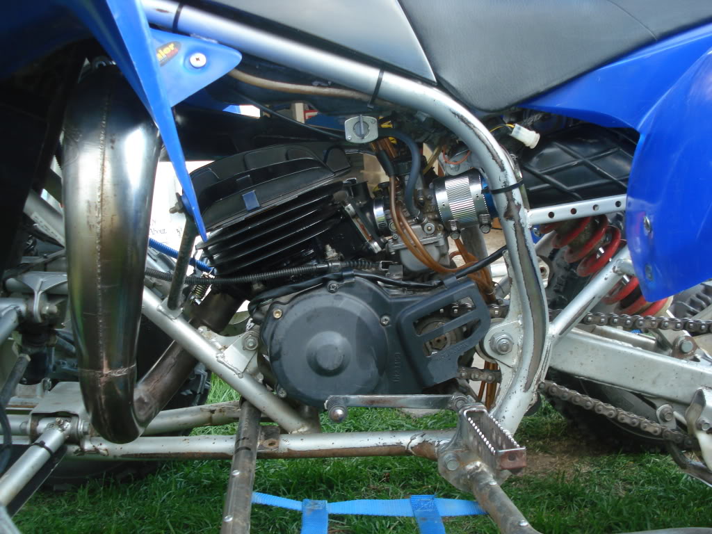

hahah. well im fabbin up the intake today, and im happy that i have a airstryker!!! Thanks to whoever i bought it from on the forum gave me a super deal!
WOOO HOOO got her running and everything done today.
custom ported manifold haha.
also made a custom reed spacer, use my stock reed cage and chopped it up.
Kennedy got me surprisingly close on the jetting.
its a little rich but thats fine for the break in.

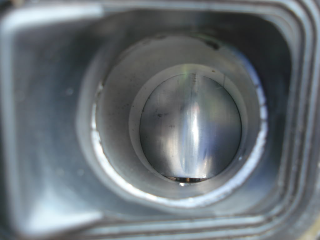

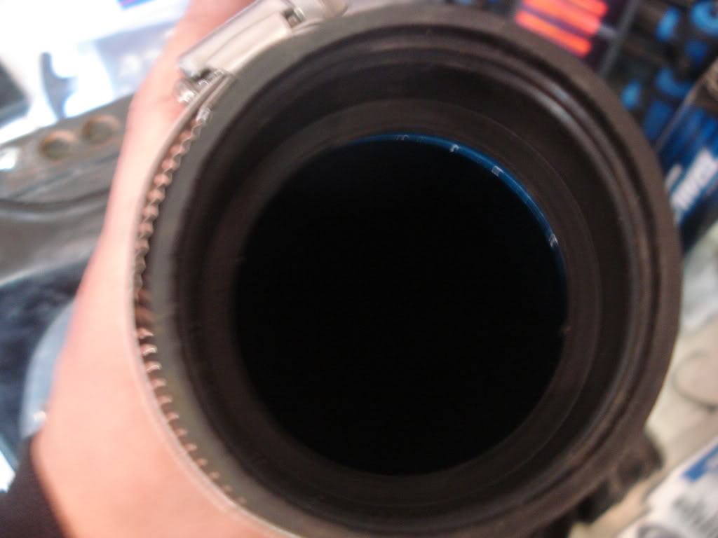

by the way anyone looking to run a big ass carb, a 2" fernco or rubber joint slides over it perfectly
Took the dremel out on the inside of this, the carb slips in there perfect now and its the same size if not bigger then the 35mm
here you can see my custom reed spacer i made lol, cut the whole pedal part off the reed cage then used rtv sealant so it dont leak.
