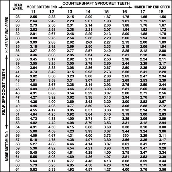

with those 22's its no wonder! lol. if you were to go to like a 20 or 18 inch tire, youll see a definite 'snappier' throttle response. heres a gearing calculator to help with deciding what raio works best. stock size is 13/40 with 21" tires

22" tires are especially large, larger than stock even (21" "balloony" ohtsu's) so you would need either a 13 front sprocket or 42 rear sprocket just to compensate for the gearing... If you dropped to a 20" rear tire and went back to stock gearing you'd probably be in good shape then.

I'm running 18s with stocks gears an 1st gear is pretty much gone.. I have 13/38 sprockets somewhere in the garage gonna give them a try sometime soon.
as far as gaering goes on a trail quad..stock gearing is fine, in regards to spockets, now as far as tires go, the rotational mass of a larger tires requies far more work from your engine than a smaller tire does, smaller tire = less rotation = less weight = faster wheel spin. 22" tires are larger, and spin slower, and weigh more in most cases. its a matter of preference. Bummer981, a member here, had 22's on his blasty, I put 18" turf tamers on it for him, and he loves it. The only down side is you can't ride in muddy ruts. BUT, its a blaster, not a mudder..lol with a smaller rear tire, you will lose top speed, but gain torque due to faster rotation. You can gain almost the same response from changing your rear sprocket also. My 400ex has 18" tires with stock sprockets, this means faster wheel spin but less top speed. Now if I was to change my front sprocket from a 14 to a 15, it would be the same as going from a 40 in the rear to a 37, meaning I would be gaining nothing , losing a little torque, and gaining 1-2 mph in top end. but if I left the front sprocket stock, and say changed the rear sprocket, after having the 18" tires on, from a 40 to say a 38, the counter shaft will still be rotation up front as it should, with no more added tension on the engine, and the rear would have less weight, with a slightly smaller spocket, making me stay close to the same power range as stock rims and tires. It really is just preference. The best tire, IMO, is a 19" rear for a 2 stroke quad of any flavor. but they are expensive.
