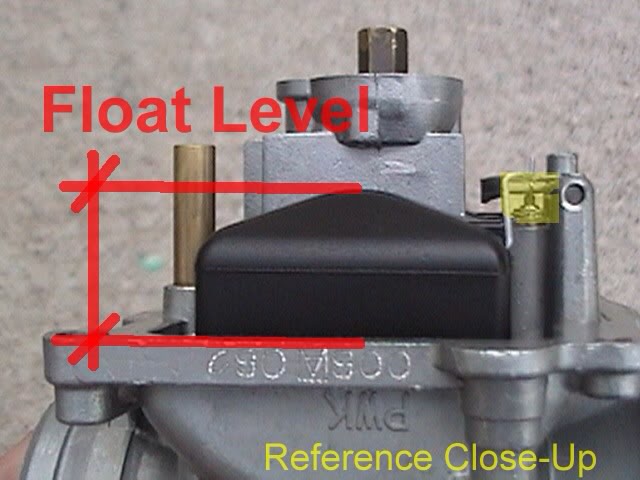

i like the new/better pic demon has posted
but here is the one i always post, and the setting should be 20-21.5mm measured with the carb held on a 45 degree angle, like shown in the pic, you don't want the weight of the floats to depress the center pin of the float valve, just touch it,
bend the center tab to adjust it..................
