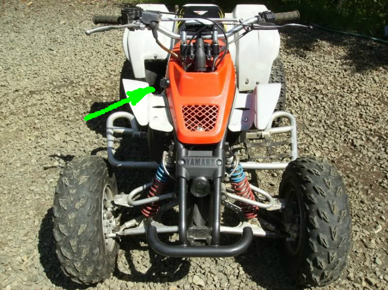

I got rid of my key long ago so I'm a little fuzzy on this. I think there's only two wires going to the key. I've seen people mount it in the vertical part of the front fender like on the 03+ Blasters.
For me a switch is a simple deterrent to unsupervised hot laps by showoff youngsters :) ... an ounce of prevention ... I just cut a hole in the side of the hood & put in a switch ... prolly not so good if ya don't have a fender to protect it.
