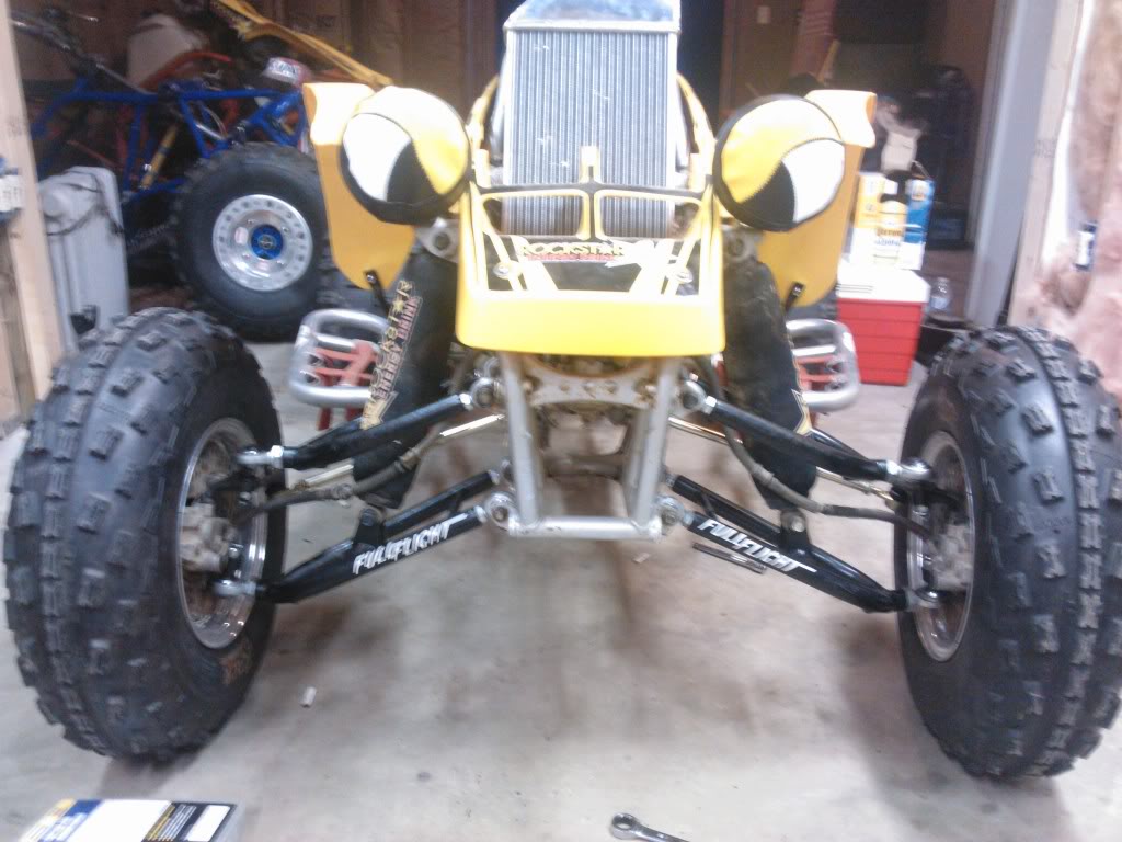

Rebuild on the "FREE SHEE"

Well fellow blaster bros, I have some awesome news! I. Got the front end together and decided to take it for a stroll down the street I:I really didn't know what to expect, but holy chit this thing rips :o It is a little lean on the pilot. For some reason the air screws are reacting now. I set the air screws at a half a turn out. Made it a lot better, but it needs 30 pilots.
So anyway I cruised up the street a couple times to finish warm up. I decided o hit it in 2nd gear and it has a light swich powerband. Almost flipped over cause the back brakes aren't working yet. I had the dynatek set to standard timing. Oce I get it jetted in and advance the timing t should smooth it out some.

You got it bro. I ripped on it tonight. I only had one problem. The right side carb was pouring gas out of the overflow. I have to dig in them again to put the 30 pilots in so no big deal. And I found out what the growling sound is. It's the kick start assembly. While the bike is running I moved it back just a hair and it fixed the problem. I will be replacing that soon. This thing is SICK. I know why everybody says they are not good trail bikes. Its cause they have a light switch powerband that could easily land you on a tree! I love it though. 4th gear wheelies are effortless without the clutch. Feels like it pulls almost as hard as my r6.

The 30 pilots came in today. I have to do a couple favors for some people in the morning then it's back to tuning. I would like to have the whole bike assembled tomorrow and get the jetting done.
Put the 30 pilots in and the motor seems a lot happier. Won't know until I test ride it. It's hard to set them to highest idle when there are two toomeys popping in your ear I:I
