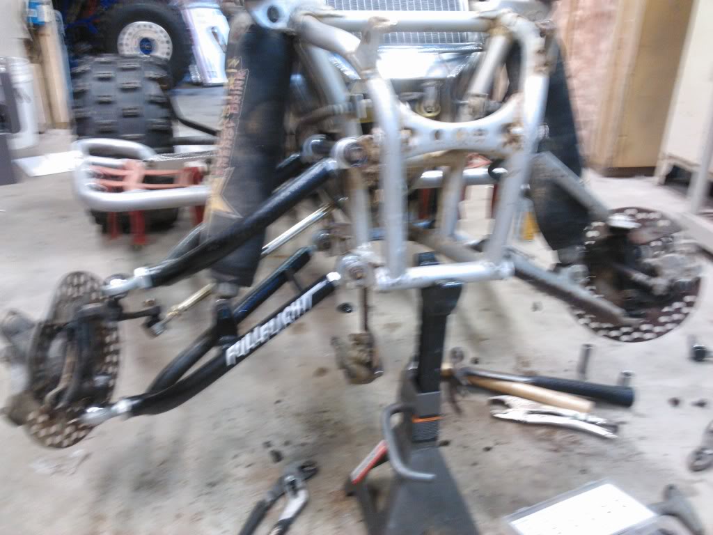

Well tonight was a frustrating night. Note to self.... When given a free bike that has been sitting outside for years don't expect the bolts to come out without a fight :o
So after spraying penetrating oil, torching, and beating with hammer the swingarm bolt still refuses to come out. I did get the chain on and adjusted. I only got one side of the a arms on because it took so long to get the bolts out. When the bolt finally did come out I noticed the grease had turned into a gummy substance.
Bad news is the dual rates works need to be rebuilt. They will be sent to kevin ASAP. Even though tonight wasn't a productive night the free shee is still crawling to the finish line.
Sorry for the chitty pic, but you get the idea.
Pics are blurry from all that corona!!!!! lol You are making good progress. Won't be long before shee is ripping it up. Keep on it and it will be done in no time at all. Nice job brotha.
