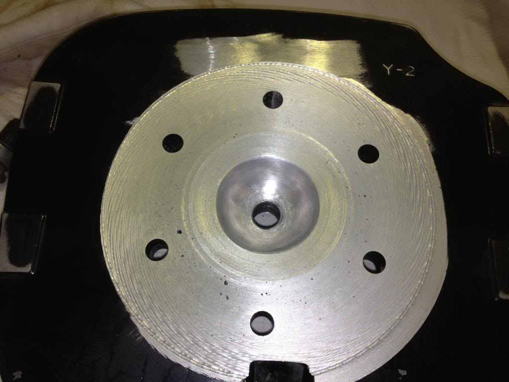

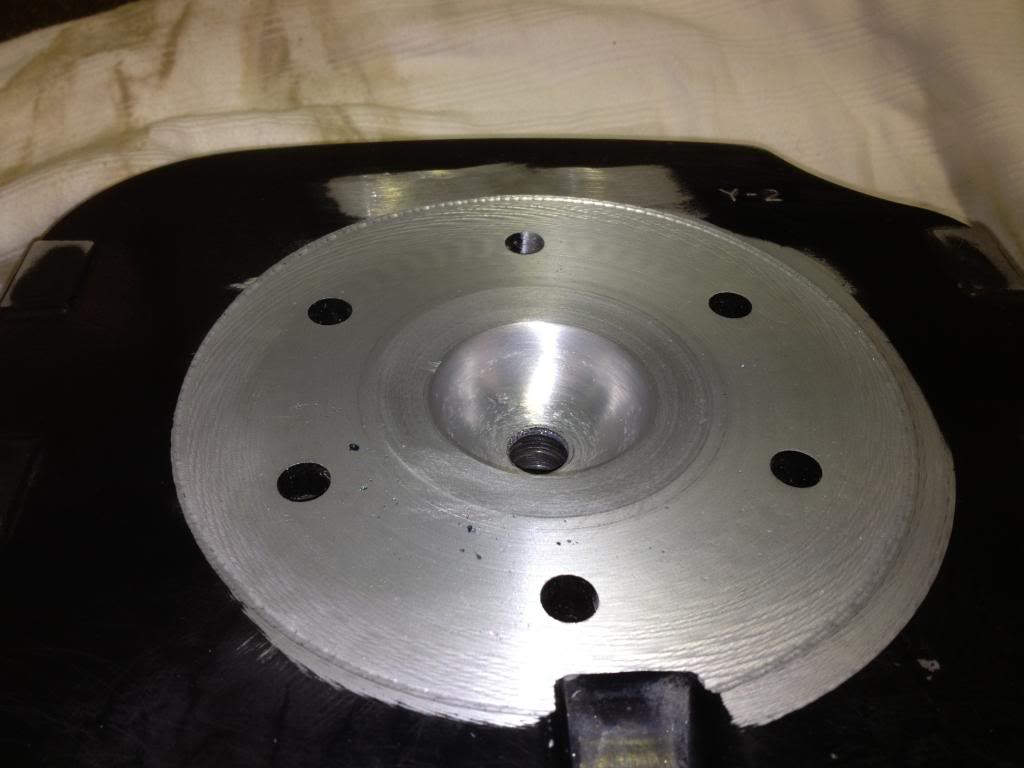

I've just finished rechambering my head here at work (11° with 50% squish and a nice toroidal chamber at ~20cc) and when I fly home next week will be bolting it up, measuring the squish gap and testing..
