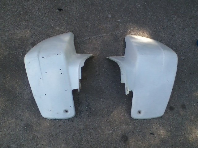

2001 white rear fenders/no air box, good condition no bends or cracks. scratches from trails
$30 obo

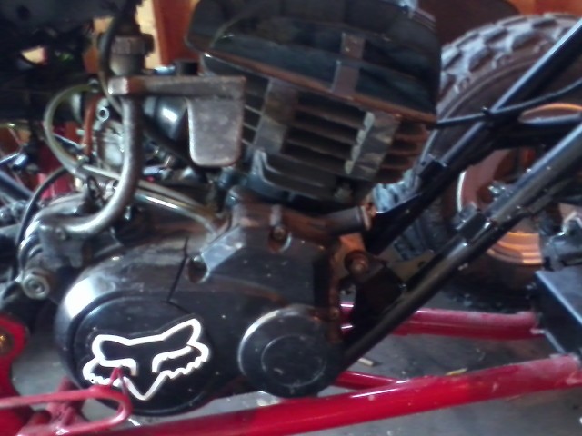

2003 stock 200cc motor. stock bore. needs topend rebuild, good bottom end. shifted smooth, newer clutch. comes with reeds/cage/carb boot. no cracks, no leaks, good condition. 2001 stator.
$100 obo
