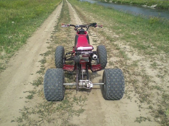

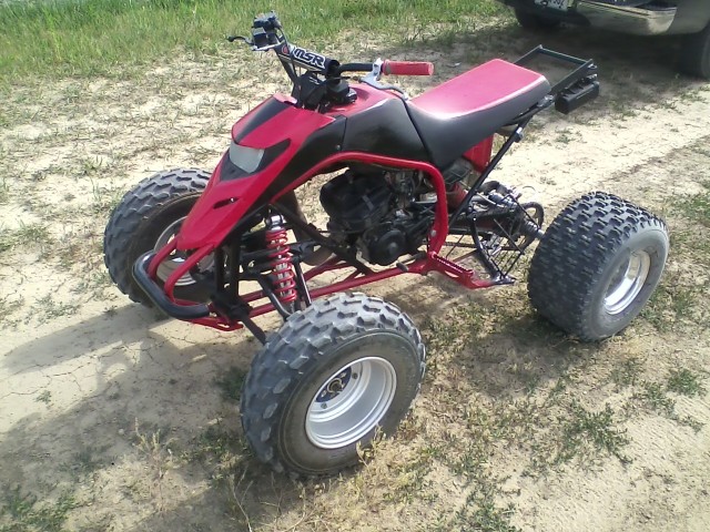

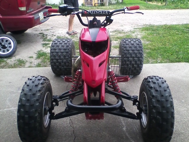

putted around for a little bit today in the alley, did a first thru 4th pull. weaved in and out of the trees. rides great, its so nimble and agile being lighter and lower than stock. i switched to aluminum hubs/rims/carrier, front brake delete. lowered 1inch in front and 4inchs in the rear. pics when i find my link cable, hopefully ill get to ride some sand tomorrow or wed

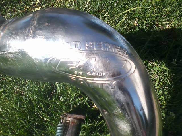

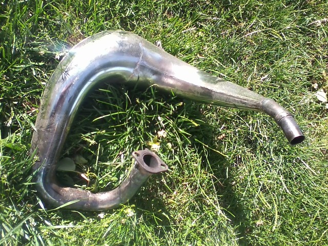

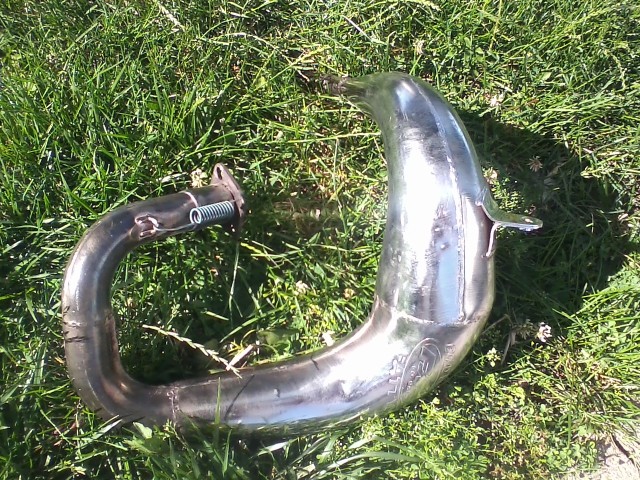

the fmf i have for sale. $70 shipped in the lower 48 U.S.A. good condition, no big dents
heres some pics from today.
aluminum headlight delete plate, just till i finish the projector build. or when im dragging in the stock motor class.
the swingarm has to be notched as the hole spacing is off by 1/8in. either carrier bolt hole will do, i used a dremel with a reamer bit.
the hubs and rims fit right up, you lose your front brakes as they have nowhere to mount.

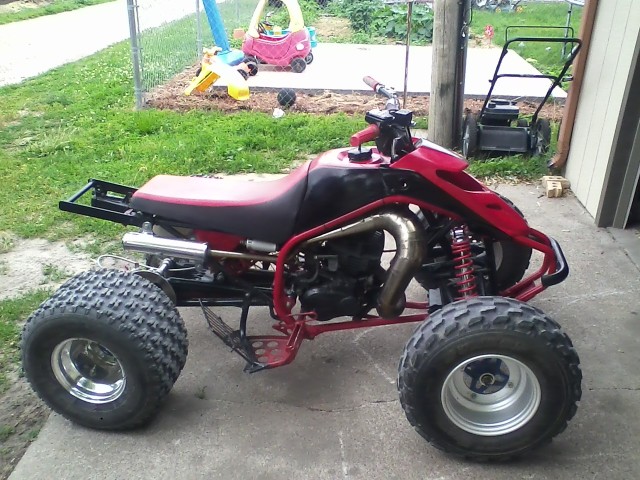

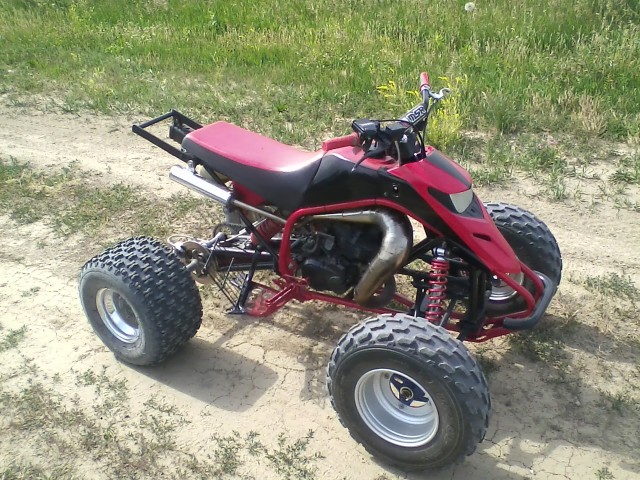

heres some pics from yesterday.
Nice ! , Blaster's Look Weird To Me Without Any Plastics , I've Had a Few With No Front Plastics , But Without Rear Plastics It Looks Like You Would Get Super Dirty , How Do You like It With No Plastics ?
i love it. no fenders gives it that dirtbike feel. and you really dont get dirty as long as you dont ride through mud. even when you do its not that bad just mud on the back of your legs and shoes
