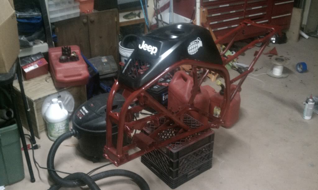

Got some more work done over the holiday/my birthday weekend. Finished priming and painting about 95% of the bike. Just have the rear fenders and handle bar clamps left to do. Got my motor back from the shop with a fresh port job and recieved a bunch of new parts in the mail. I'm still waiting on a few key items before I can start final assembly. Then it's on to the plug choppin'...
Here's a sneak peak:
